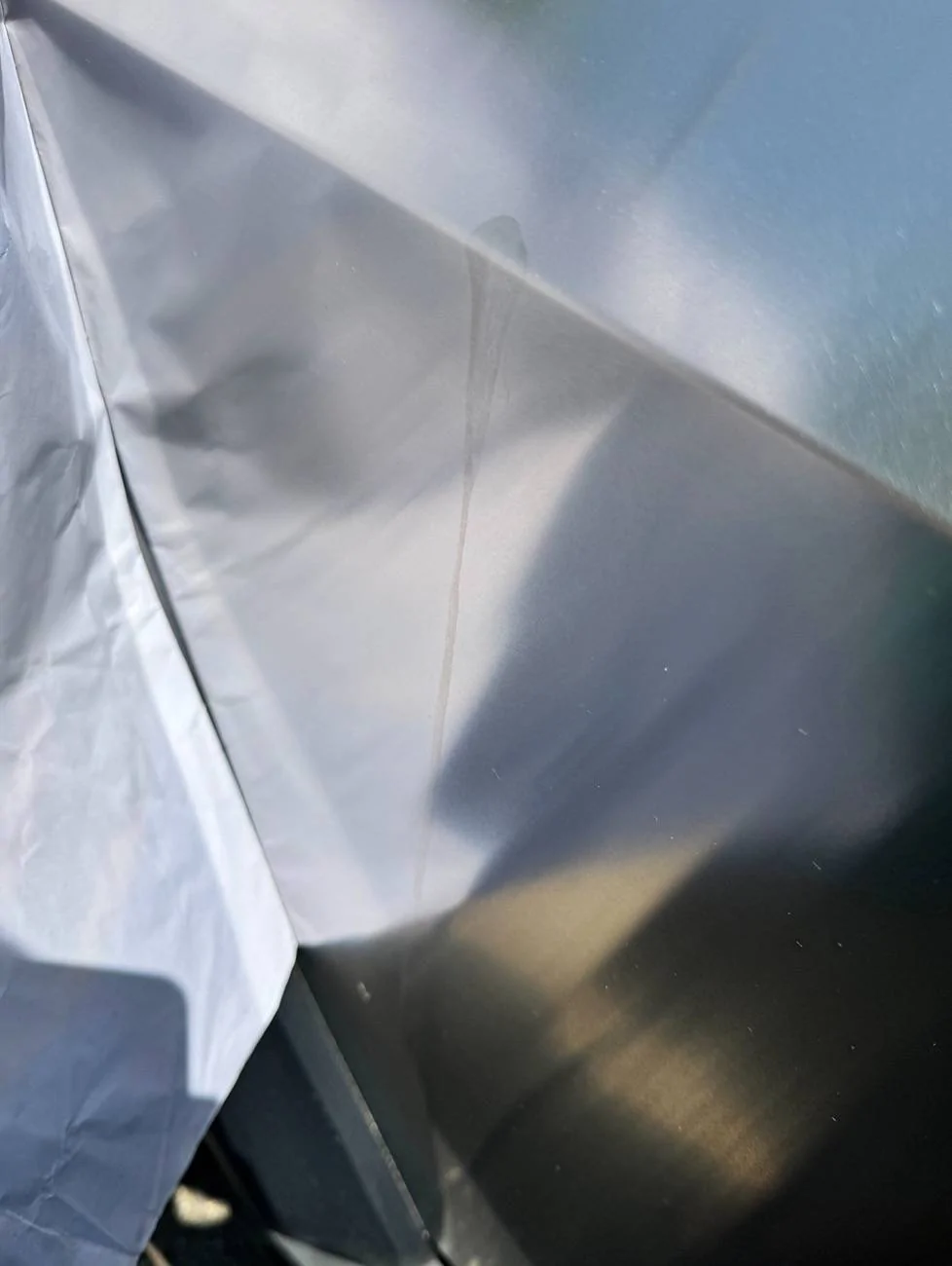

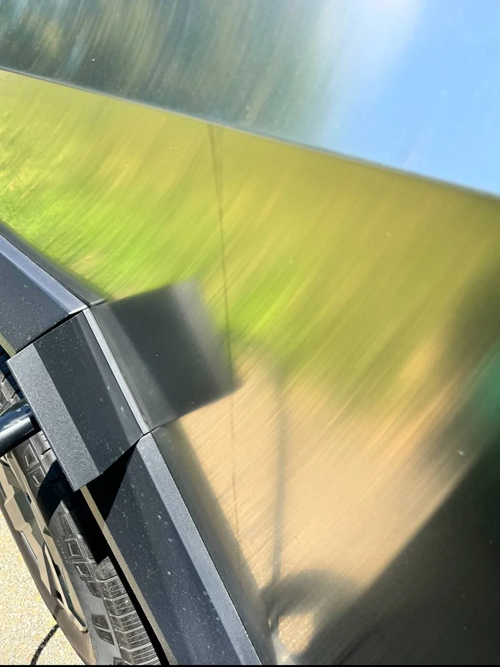

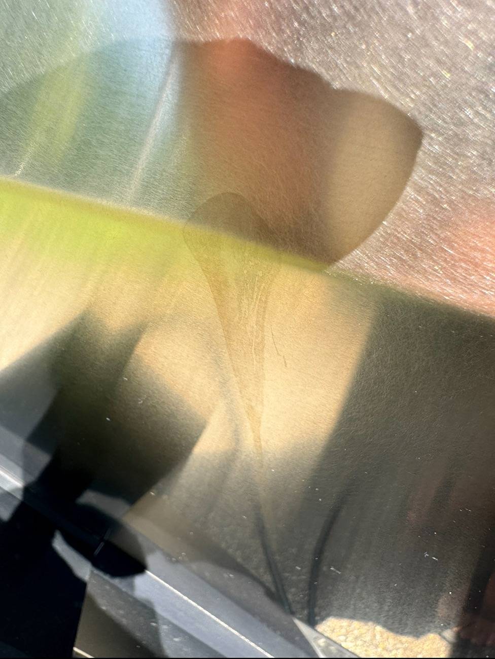

Bird poop etched my truck
Ed243
Ed
Jun 28, 2025
84
AZ
2025 Cybertruck AWD
BKF contains oxalic acid which should clean that up. A mild abrasive you could use would be a clear coat safe polishing compound. If you go with an abrasive it will probably make the area slightly shinier than the surrounding area.

Just an update: i used Citrisurf 77 and a blue scotchbrite pad as recommended in the DIY section of the owners manual and it removed 99% of the stain. Im sure if i kept going it would be gone completely. Hopefully this helps others in the same situation.
