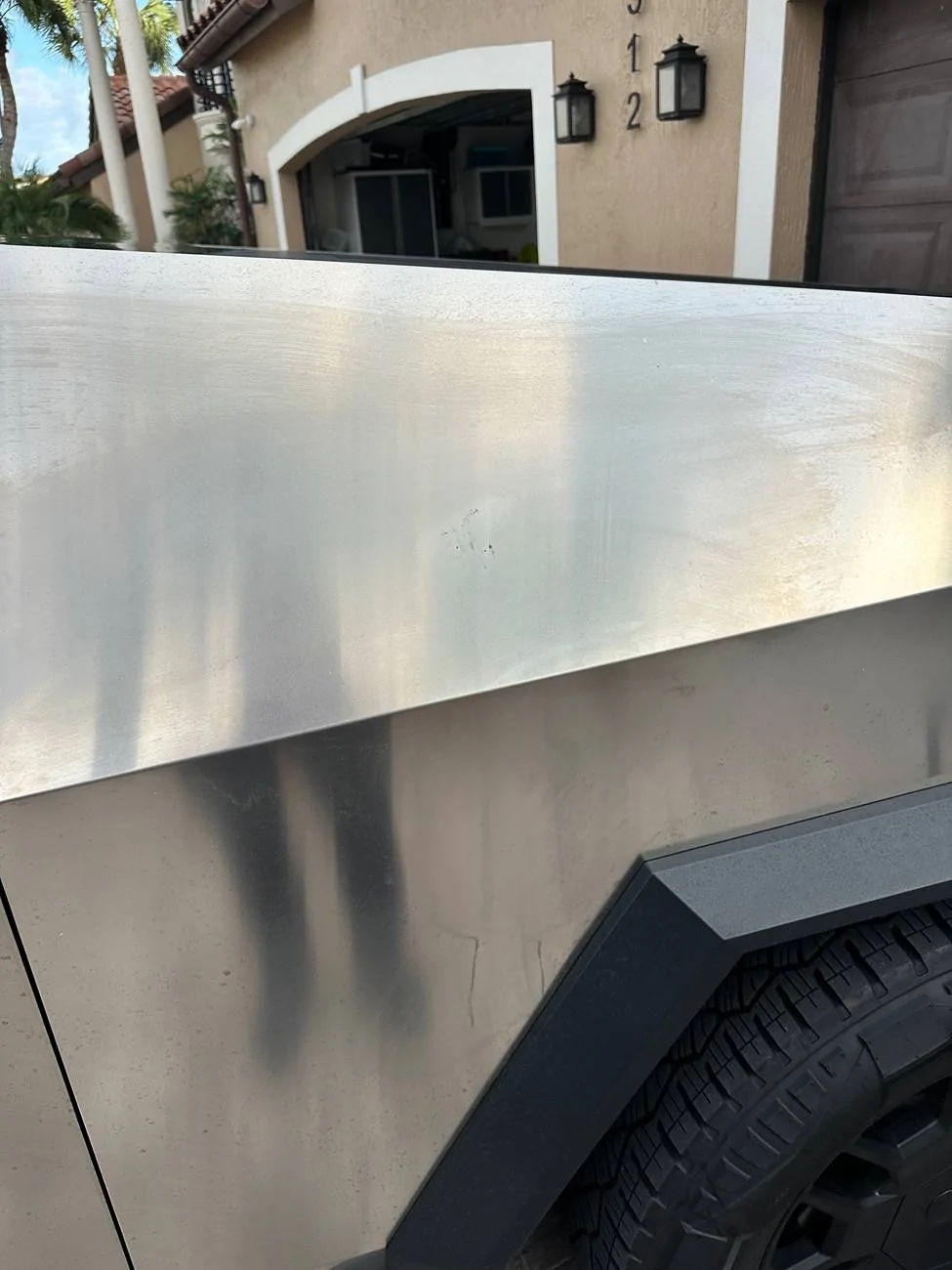

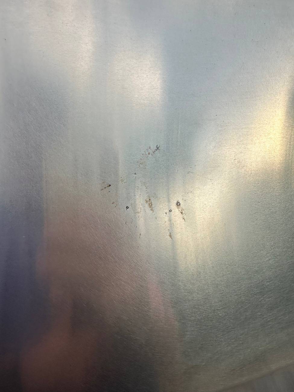

Anyone got suggestions for what to use to get this off? Used glass cleaner, stainless steel cleaner, soap and water. This was what was left after a bird took a huge shit on my truck. Looks worse in person.
Tesla Cybertruck Bird Poop Stain! {filename}
I had a tar speckled on my CB that would not come off. I used kerosene to clean the tar off and then washed the entire truck with a mild soap. Cleaned the tar stains great and did not damage the SS.

Tesla recommends CitriSurf 77 and I can confirm it works well and is not nearly as abrasive as BKF.
I've used both for different purposes.

As to the OP's stain, yes, a quick sprayof foamy BKF will take it right off, and the area treated can be feathered into the surrounding area if you are not ready to do the entire plane that panel is on. That's how I take care of any stains that won't come off with soap and water or Sprayway Glass Cleaner.
Blending should be self-explanatory, but maybe not everyone understands. You spray the Foamy BKF directly onto the soiled spot, wait a few seconds, rub it into a slightly bigger area around the stain, wait a little bit, spray a little more on the stain, wait a few seconds, spread it into a bigger area around the stain, and so forth. Then I rinse the entire area with water or soap and water.
I generally do this as I'm washing my Cybertruck and I find a stain the soap and water or Sprayway won't remove. The end result looks beautiful, and with very little time or effort.
If you use the paste version of BKF, it will be harder to blend the treated area with the surrounding area because it polishes the metal slightly. Over time your Cybertruck will become shinier, particularly where you have treated the same area multiple times. The spray Foam BKF doesn't contain abrasives, which will preserve the factory sanding pattern better.

Two words: Barkeeper's Friend. I use it all the time to scrub cooked on stuff on my stainless steel pans. It should do wonders for your stainless steel truck.
