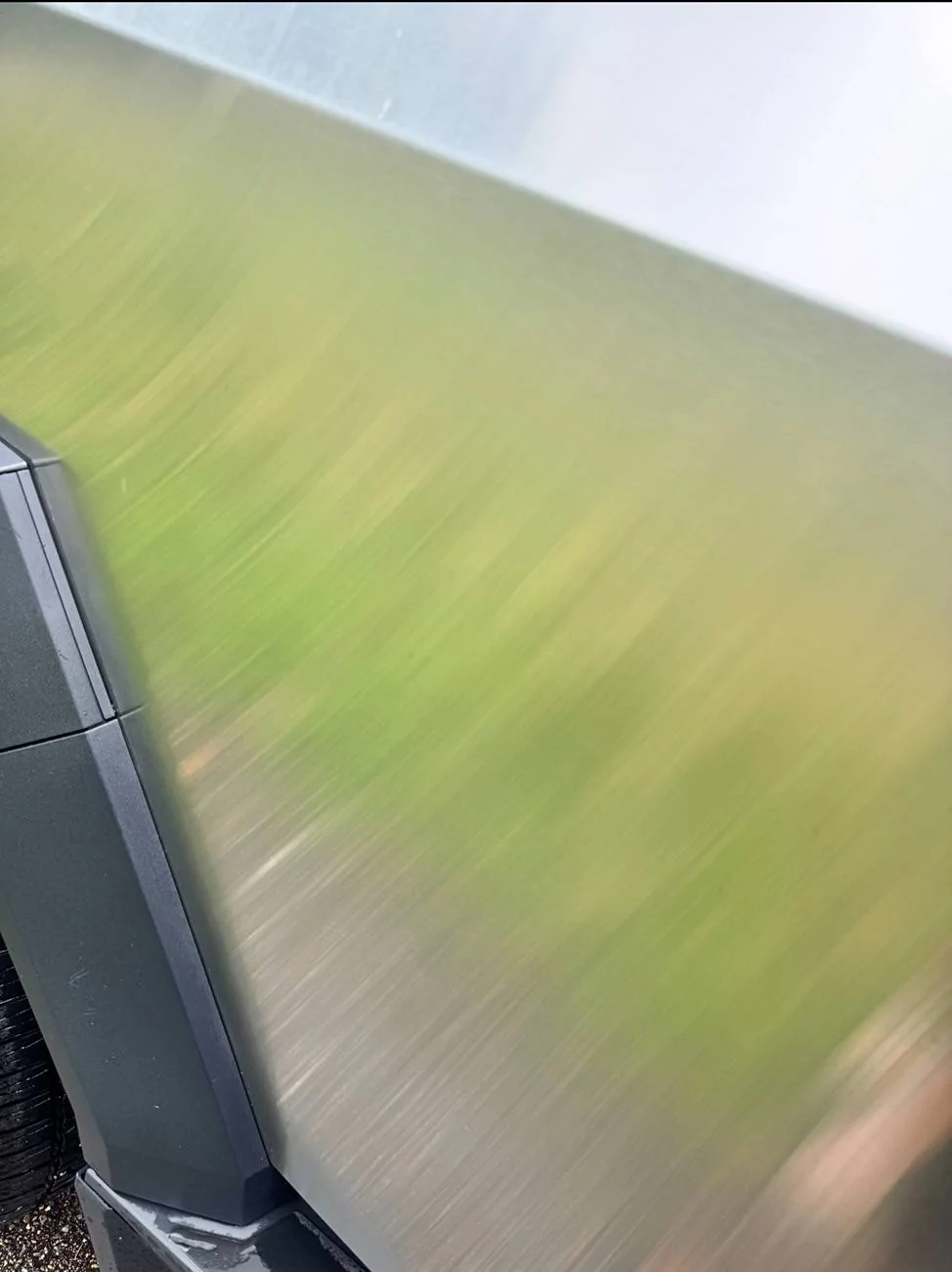

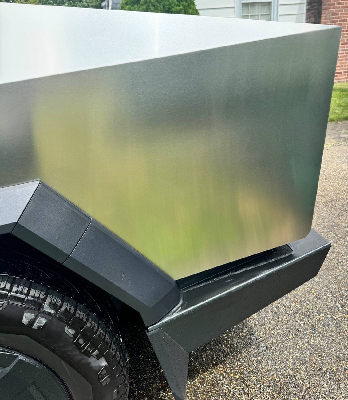

BKF contains oxalic acid which should clean that up. A mild abrasive you could use would be a clear coat safe polishing compound. If you go with an abrasive it will probably make the area slightly shinier than the surrounding area.
Cyber_Wolf
Nov 16, 2024
Canada
Cybertruck, ZX6R
As fate would have it, a bird pooped on mine yesterday. I left it there overnight and this morning when through my cleaning process. Easiest vehicle to clean!
Spray - leave for 2 hours - rinse and wipe - (Polish with glass cleaner I did not do as Iā€˜m just going to get it dirty again)

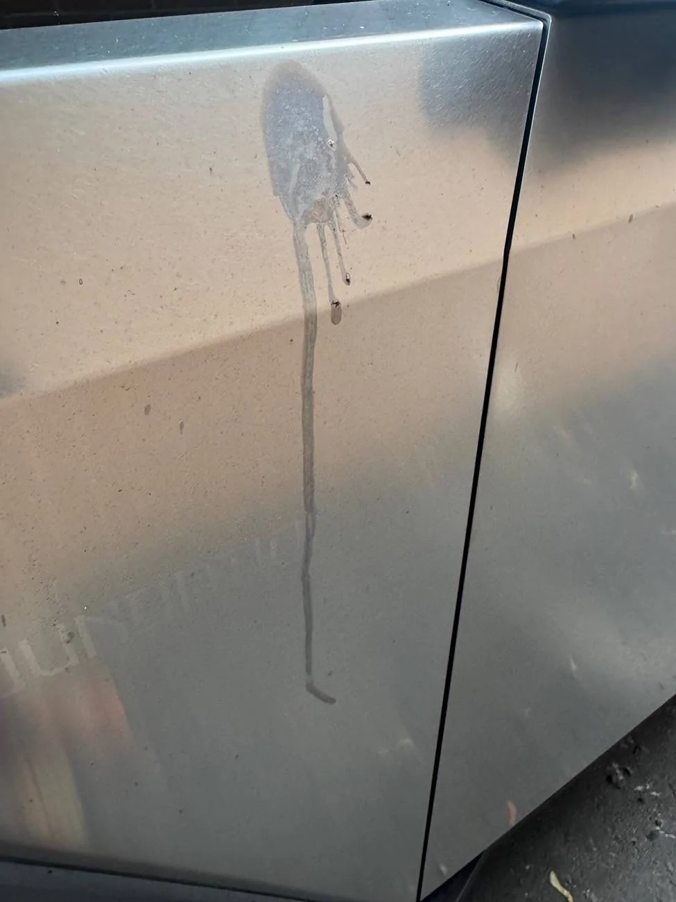

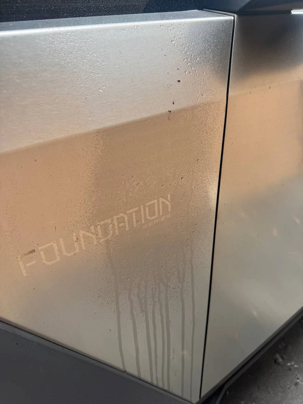

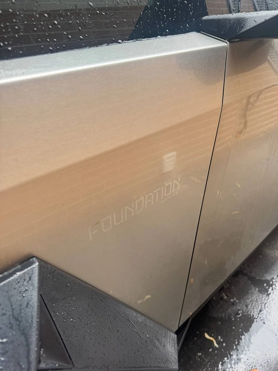

Just an update: i used Citrisurf 77 and a blue scotchbrite pad as recommended in the DIY section of the owners manual and it removed 99% of the stain. Im sure if i kept going it would be gone completely. Hopefully this helps others in the same situation.

I see the DIY manual says to apply the Citrisurf77 to a microfiber towel or sponge, then rub it onto the steel. How much did you spray on the microfiber towel when applying it? Assume enough to get then panel wet (not just damp)?

I sprayed a microfiber 2-3 sprays just so the cloth moved over the surface and left a damp layer, and over about3-5 mins reapplied as needed to prevent it from drying out, then i sprayed it again on to the scotchbrite and gently went over the whole panel, for roughly 5 mins, reapplying as needed so it didnt dry out, then rinsed the whole thing off with water.
