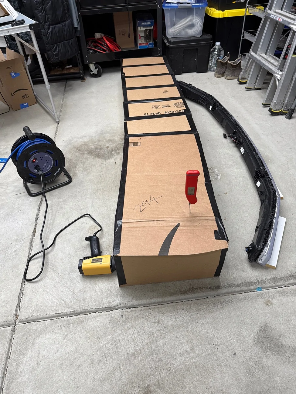

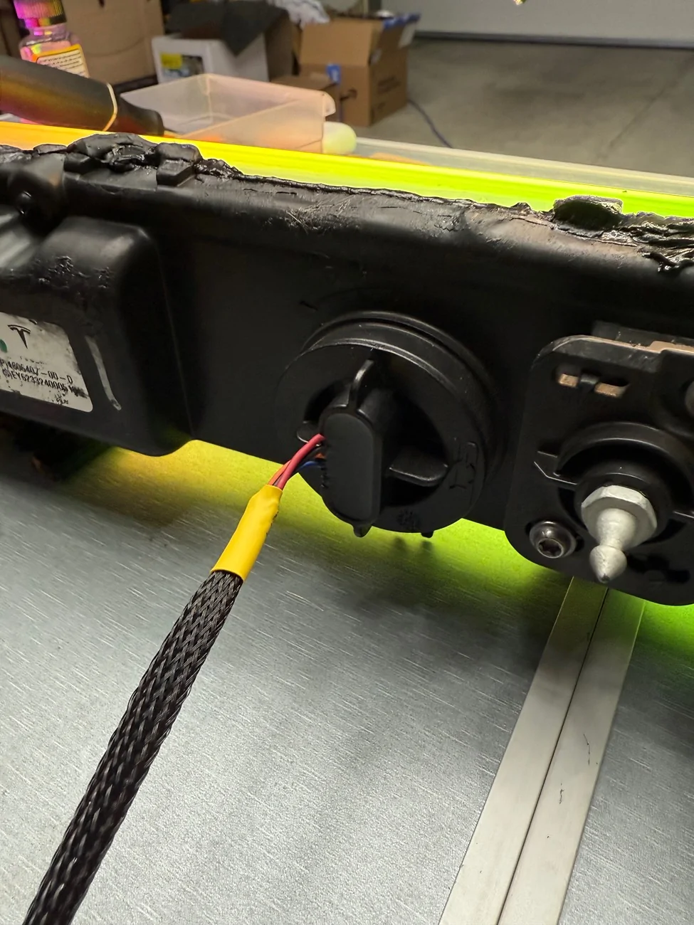

The V1 Nemsis was re-sealed with Butyl. I used a heat gun on one of the corners. From what I remember, I had to heat about a 1-2 foot section beyond the corner until I could get a small wedge in. Once you have a good section slightly cracked open, maybe half the DRL length, I started at the original wedge spot applied more heat until I could get a small piece of 2x4 to hold it open. Then just continue to heat and work your way around the DRL. It probably would have been allot easier with two people. And I remember that butyl tape being a pain and always sticking back together.
also FYI, I didn’t like the hole drilled into the back cover to run wires so instead ordered the original OEM connector and wired that up. Less risk of condensation intrusion doing it that way in my opinion. For re-seal I didn’t have access to a commercial oven so just made one from cardboard with a heat gun and baffle.
