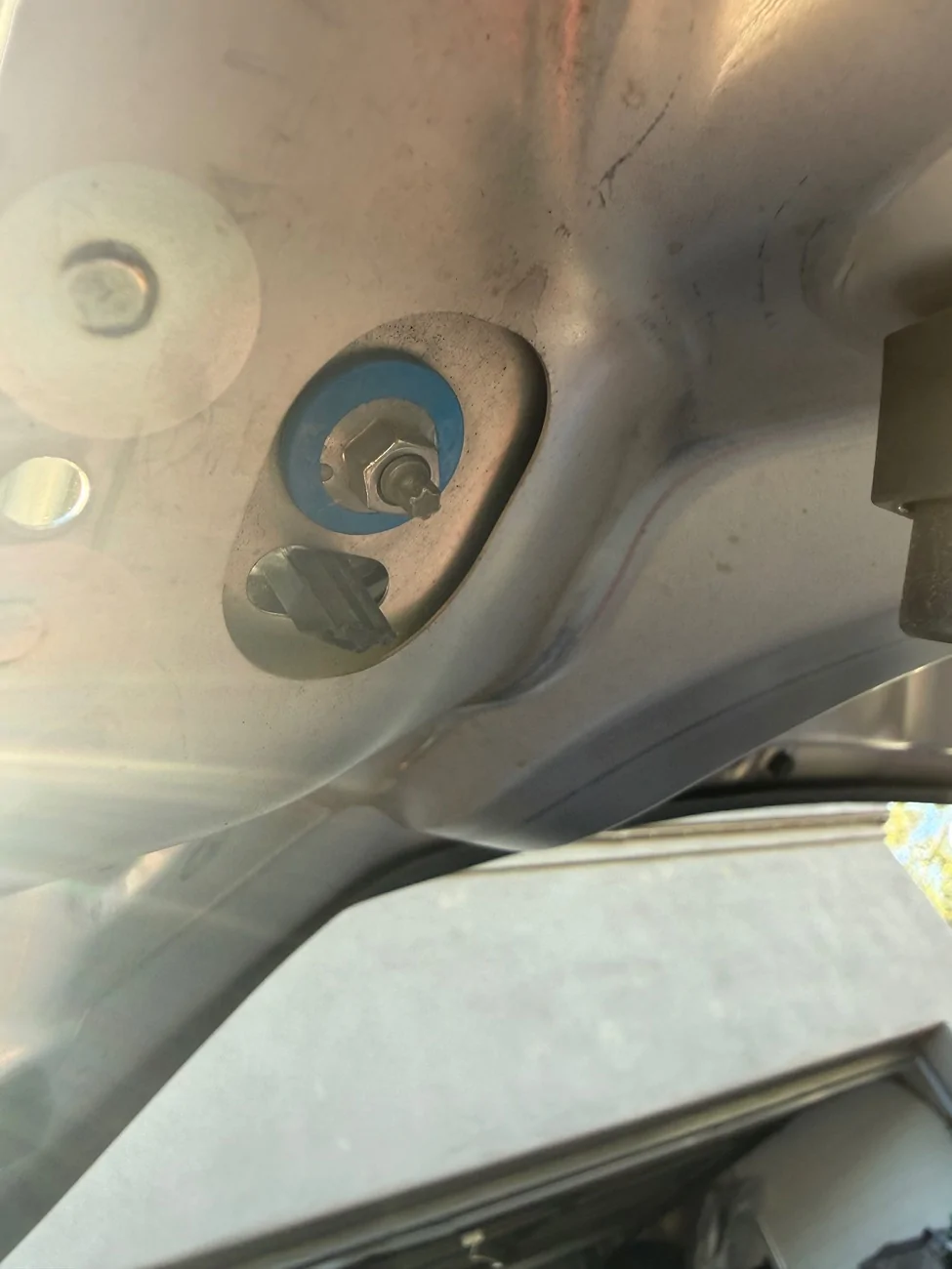

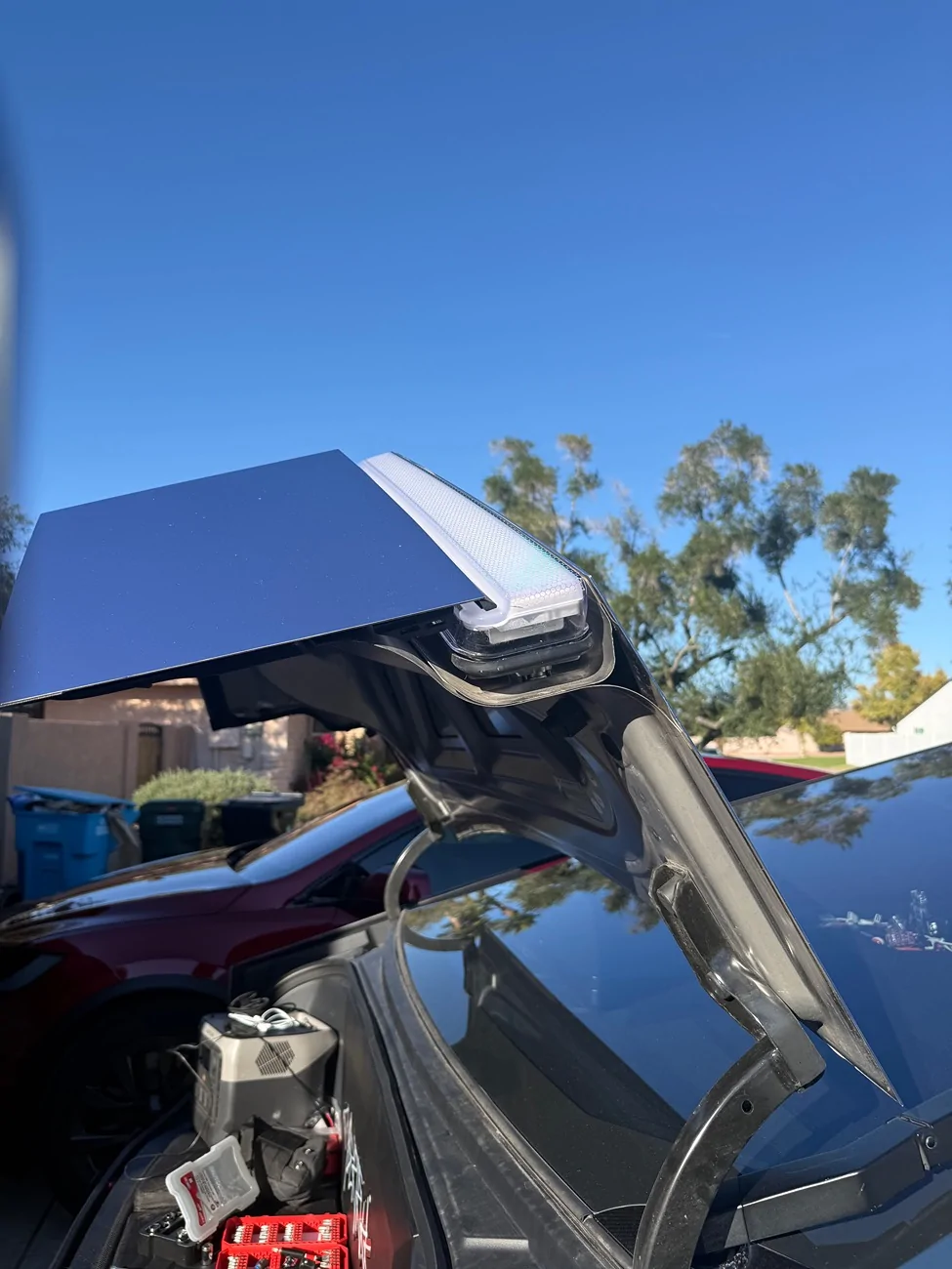

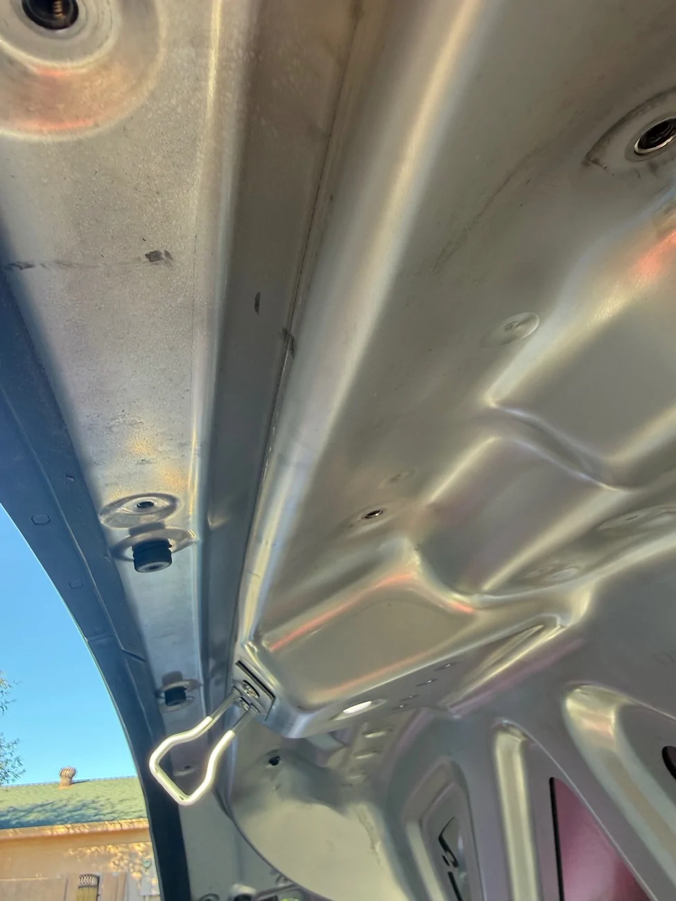

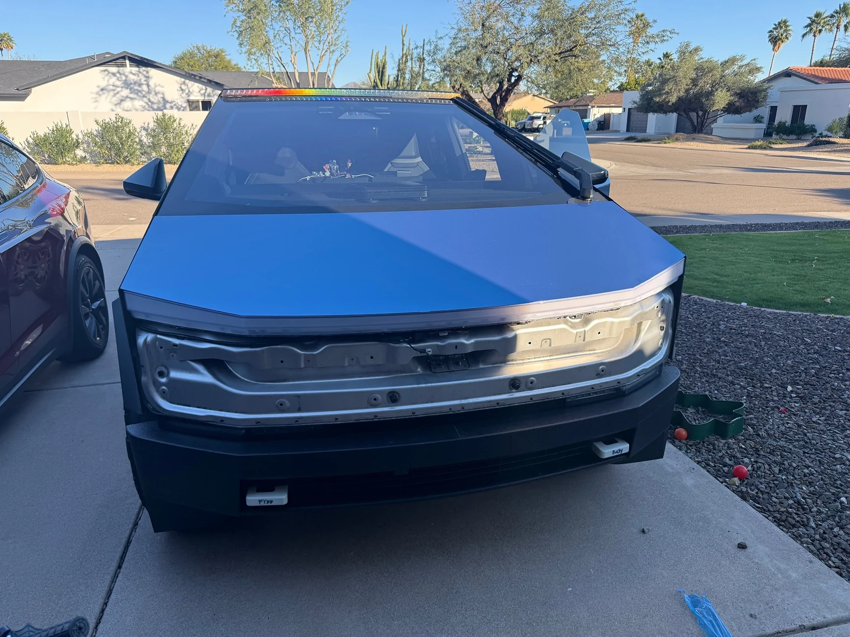

The DRl arrived a couple of days ago and I installed it today. Which was actually pretty simple.

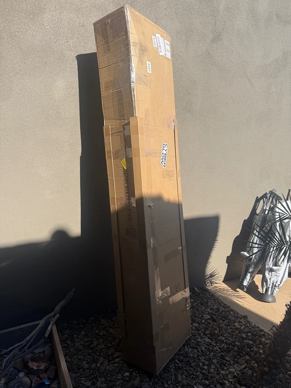

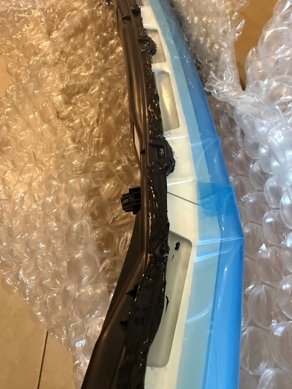

The packaging was very nicely done and it felt very secure when it arrived in just about the largest box that’s ever been shipped to my house.

as you can see the silicon appears far from pretty but pretty thorough and the plug setup is essentially indistinguishable from OEM.

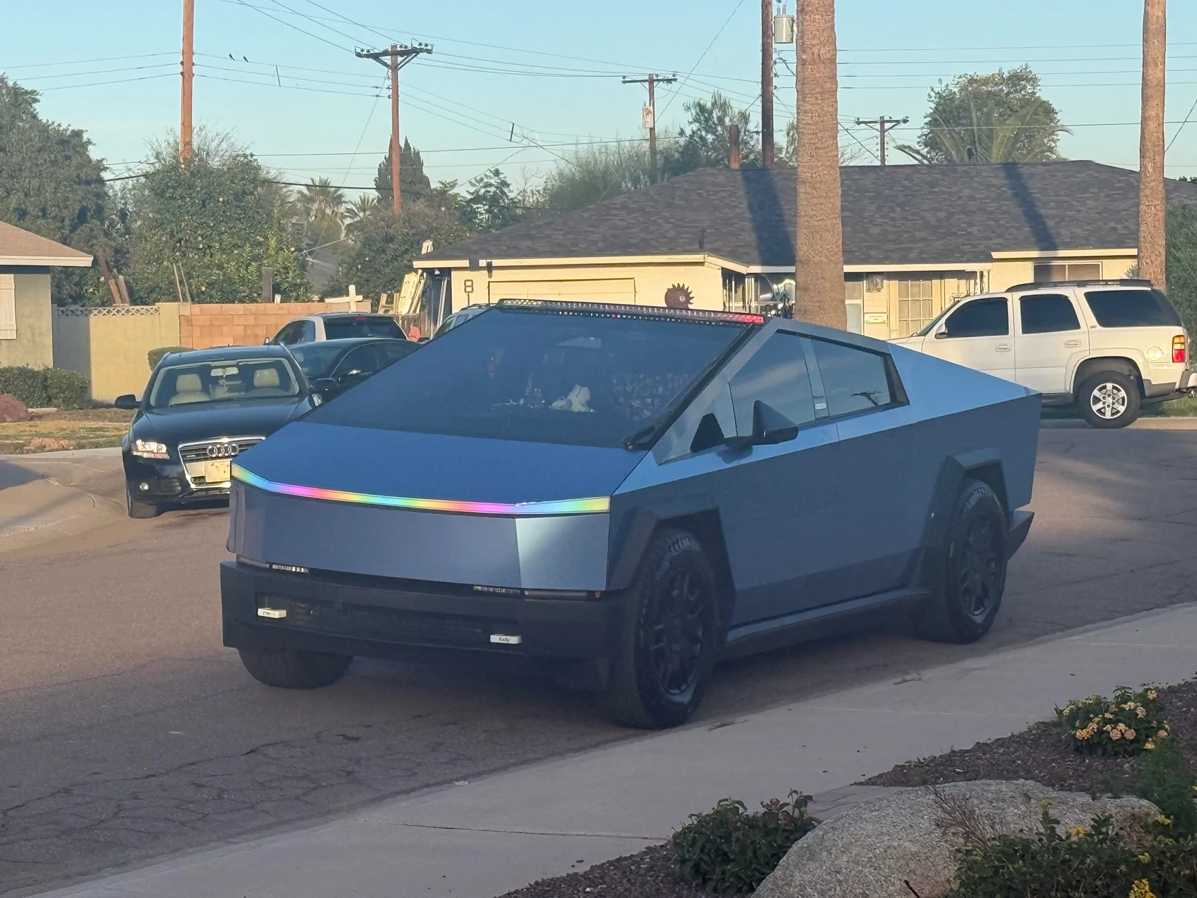

So just to help explain a little more.
Right now my car looks like this while off. If I press the pedal to start it, the light goes white and I can restart the device but then I get the more subtle version of the color with the white background.
If I turn off, keep aux power on, it turns off. If I hit off on the remote it turns off.

On the silicone and RTV appearance
Totally fair callout. We want it to look cleaner too. The tricky part is that getting inside these bars is an extensive process and we design our sealing process to prioritize function first, meaning waterproofing and longevity. That said, we’re actively tightening our process so it looks more professional while keeping the seal integrity.

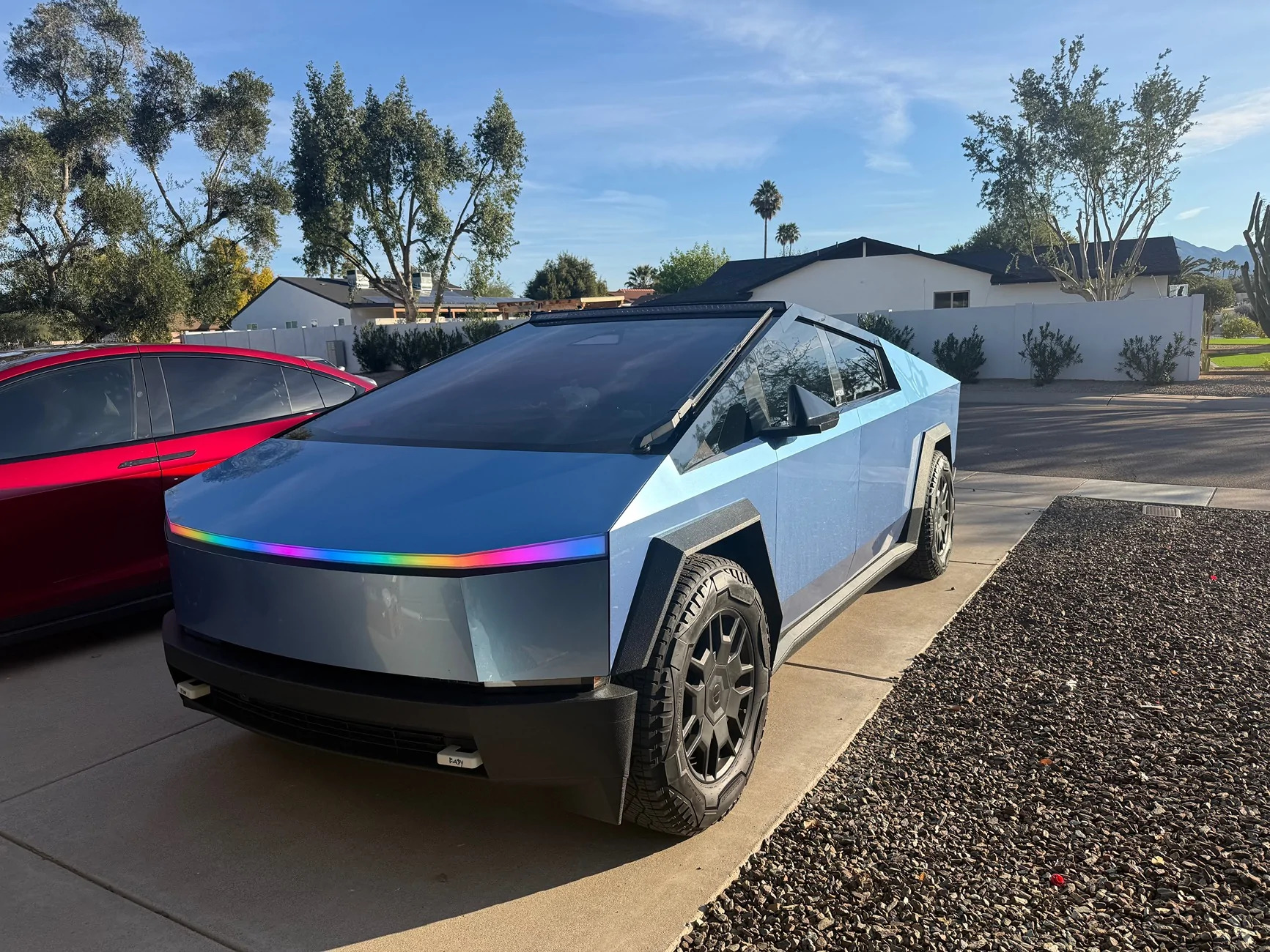

Thank you Michael. Kind of getting used to the always on vibe after a day or so.
In the daytime it looks kind of interesting with the prism hex film I have on the beast bar. much more subtle when driving because the white is on behind it. Kind of what you want for minimizing pull over risk anyway. Will probably mount your switch right by the auxbeam. I’ve found also that since that since it’s related to the “keep aux power on” feature it can be turned off remotely by putting the car in low power mode through the app. You can’t turn it back on, but you can turn it off that way. After that, if you still want cabin overheat and sentry and that sort of thing , you just turn it back out of low power mode
