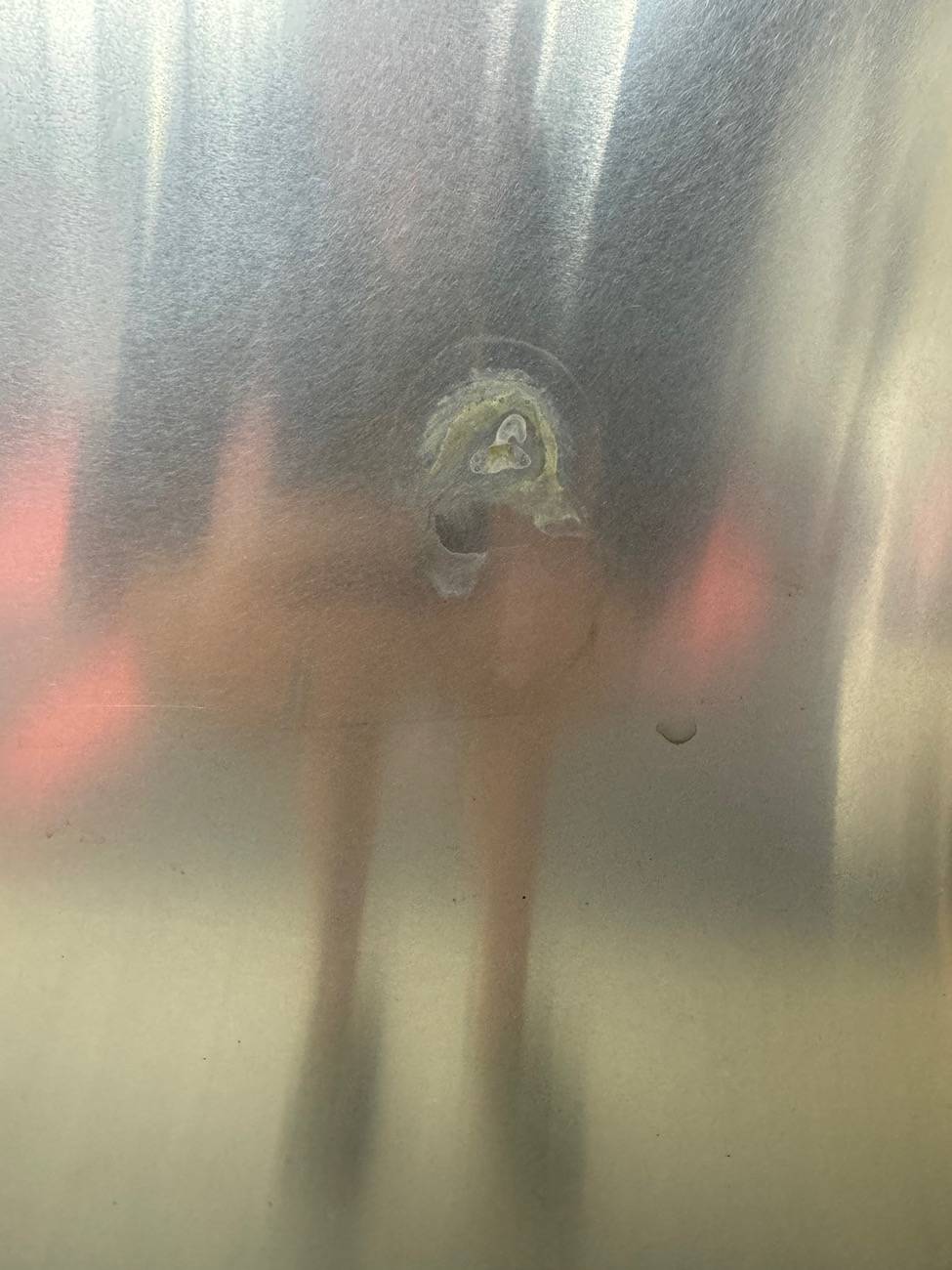

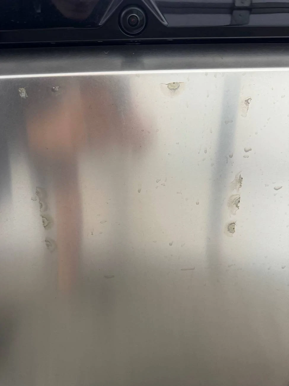

I put magnetic QR codes on my CT to advertise my business. They were on the bare stainless for less than a week and when I took them off to wrap it, it looks like this underneath. Any clue as to why/if the magnet would do/did this? Haven’t tried cleaning with Citrisurf or Barkeeper’s yet, but SprayAway did nothing on it.

Looks like water accumulated behind your sign where the magnets touched. As the water dried mineral deposits formed and layed on after multiple wet/dry cycles. Try Barkeepers - but do the whole panel so it doesn't show a shinny spot.

Looks like the start of galvanic corrosion, which is caused by dissimilar metals. Use citrisurf 77+ and it should remove the deposited iron layer (yellow).
Barkeepers friend shouldn’t be used on stainless steel. While yes, it cleans the surface using oxalic acid, it doesn’t passivate the metal as it removes both the free iron AND chromium from the surface layer. It can also leave iron oxalates behind, which are really hard to remove and leave that brown look behind. It will also etch the stainless because it is so aggressive.
Citric acid is one of the acids called out in the ASTM spec for passivating stainless. You want to remove the free iron and leave a concentrated chromium layer on the surface. As that oxidizes, it will turn that nice very light bluish silver vs the crappy looking yellowish brown.

Thank you both for your replies! I’ve been using CitriSurf 77 with great results prior to this, and it’s great to know it’ll probably work again.

I would not use BKF. Likely it’s just mineral deposits, and I would try something mild like white vinegar.
It's not galvanic corrosion and the stainless steel isn't rusting.
It's common rust created when the magnets attract iron brake dust from busy roads. Then the iron brake particles get wet and rust. That will stain painted body panels too. And it will be more problematic to clean up because you have limited paint thickness to work with.
The purpose of Barkeepers Friend is to clean below the passivation layer of the stainless steel. There is no way to do that without removing the passivation layer. After using BKF, I recommend washing with soapy water and rinsing well. This leaves the panels in an ideal state to self-passivate. The panels will self-passivate over a 48-hour period after using Barkeepers Friend to remove iron stains.
