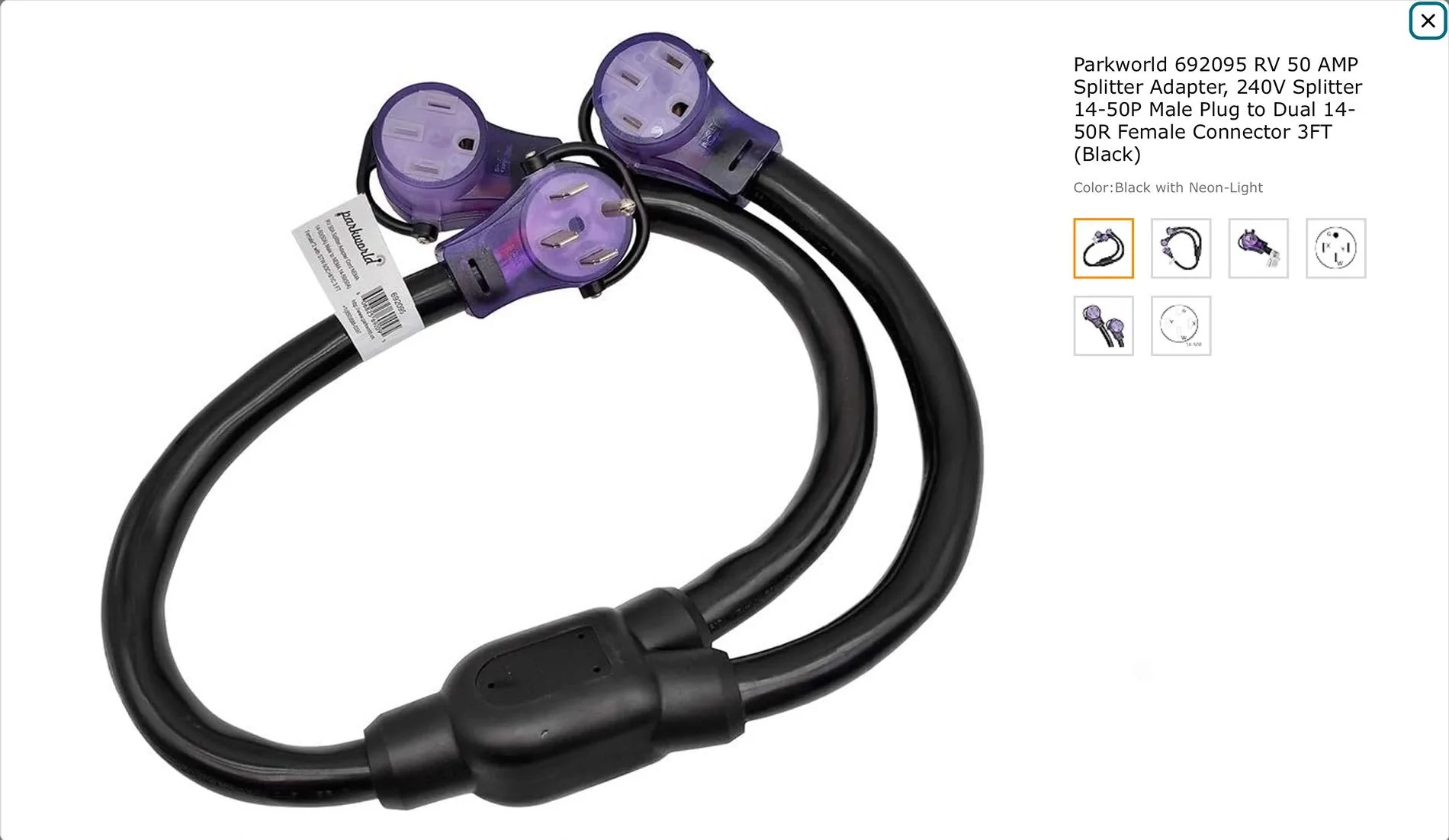

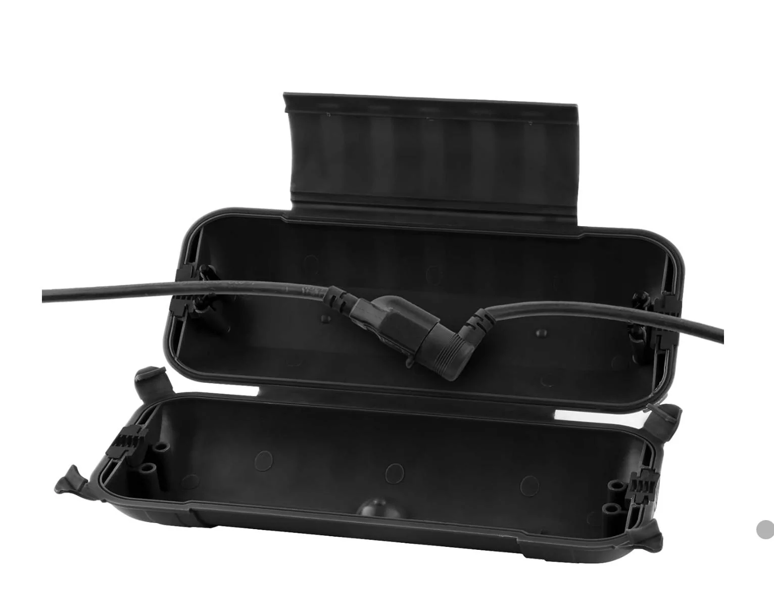

As mongo said, you cannot use the outlets currently when the Cybertruck is connected to AC charging source. You could always invest in a NEMA 14-50 splitter and possibly some version of a waterproof connection box. We have those waterproof connection boxes at all our parents houses were we have have to charge outside, they work amazing. That version may not be large enough for a NEMA 14-50 connection but there are many version out there to pick from.
If you did this you could always just set your Cybertruck to change a lower amp so you don’t run the risk of overloading the single NEMA 14-50 connection at the campsite. We plan to purchase a Basecamp and will likely do something like this for our solution.
