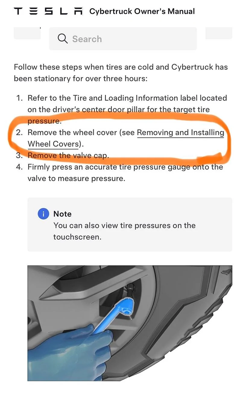

With my model S, the aero covers still allow enough tire valve exposure to add air to the tires with the covers on. However, with the new aero covers for my CT with all season tires, it appears the valves are deep enough that I need to remove the aero covers if I want to add air to the tires. Not the end of the world, but just a bit annoying and confusing why they didn’t design some type of small cut out so that the stems could be accessible. Anybody else notice this?

The reason for this is that the aero covers must line up with the pattern on the tire and since the tire can be mounted on the rim in any location, it is impossible to make a cutout that that lines up the tire, the rim, and the cover.
I’m pretty sure Kyle talked about this in depth on outofspec or maybe it was on Munro (bunny hop, kangaroo one of those two ‘[iykyk ?]). They explained this exact reason. It wasn’t an oversight it was a trade-off. You can decide where you stand on style over function.
