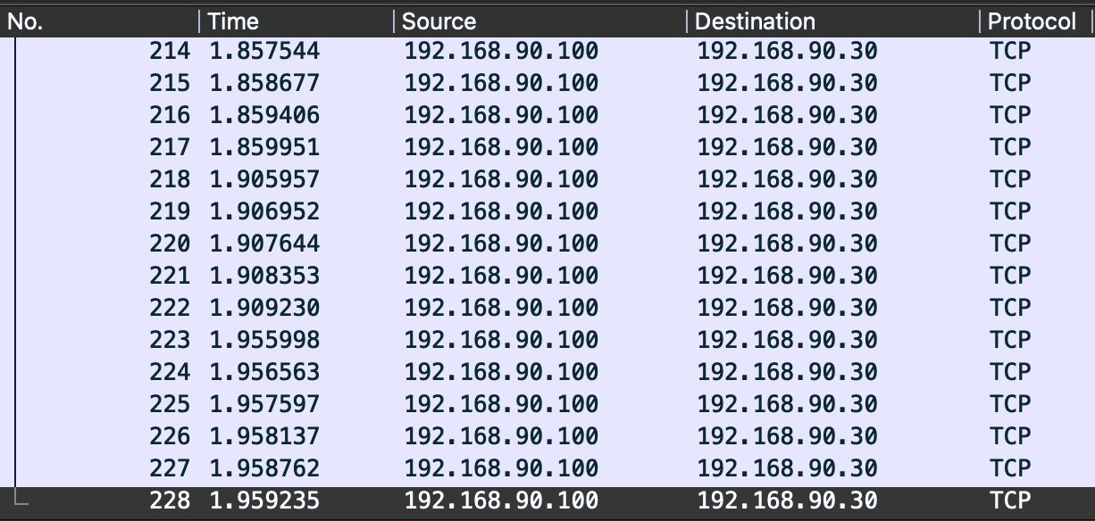

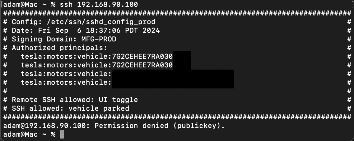

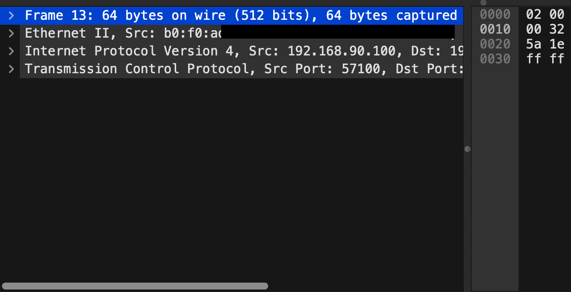

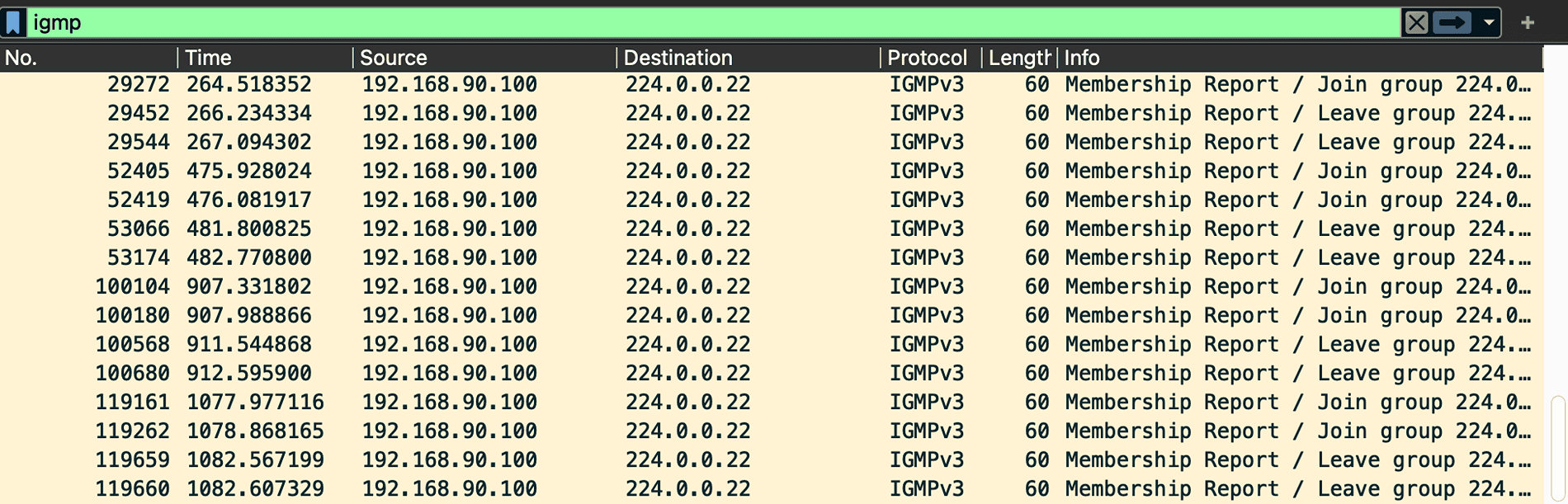

I'm a network analyst, and have some experience with Wireshark. If you have the pcap file, I'd definitely check it out!
Will send as soon as I get back home.
can bus is still used for local communication and you can tap into those easily enough but have also been wondering about how to tap into the Etherloop.
@truck , how were you able to capture traffic? (what hardware? connected where?)
All I used was my laptop, wireshark, a tplink usbc to ethernet converter, and this odb to rj45 cable. Gonna try some other things to see if it'll give different data.

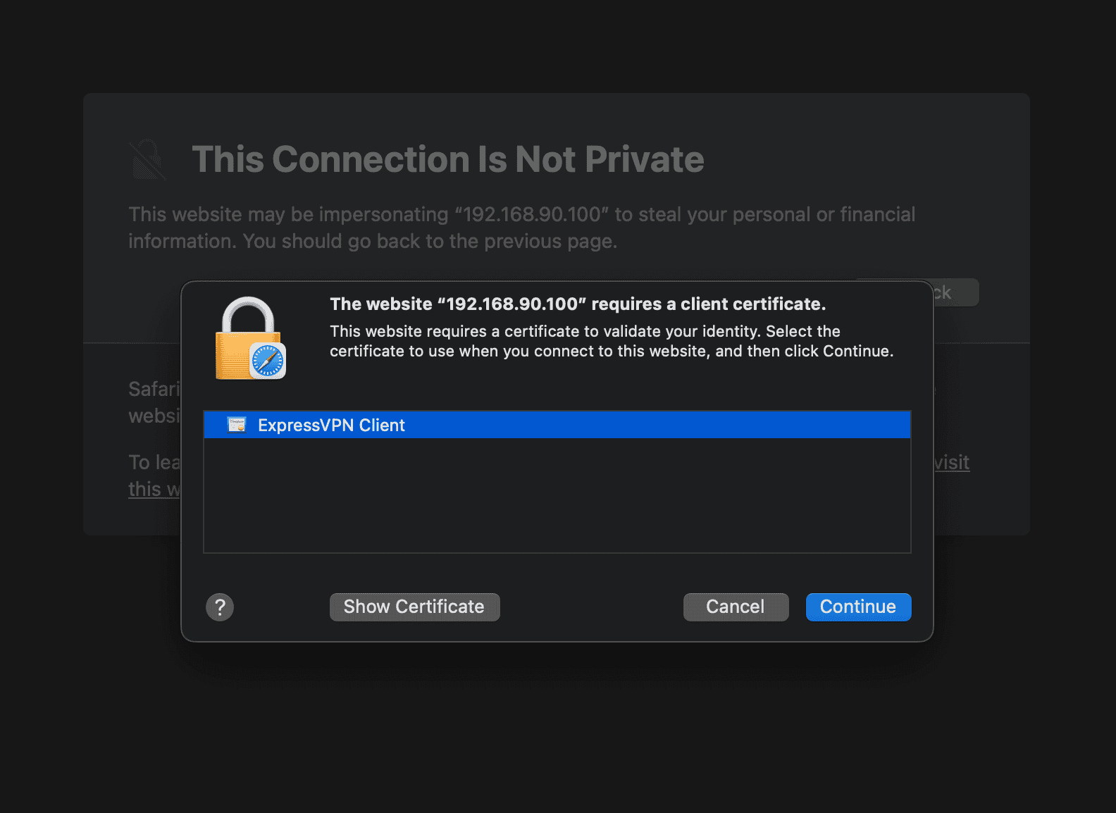

Great try! Maybe the Ethersnoop interface (RJ45) could provide more Ethernet packet info. Because they said this interface is used for vehicle debugging.
