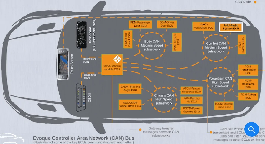

I think it's a little more than increasing the bus speeds to 1Gb. CAN communications are limited to 500kbps and CAN-FD is limited to (up to) 5Mbps. Moving to 1Gbps ethernet is also implying a redesign of the vehicle network architecture, that I don't think has really been broached yet. As stated before, and restated here for emphasis, current automotive networks consist of a primary Gateway device, which is connected to a few segregated CAN networks. You might have low speed CAN bus for infotainment/comfort systems, one CAN-FD for ADAS (advanced driver assistance system), another CAN-FD for BCM (body control modules), yet another bus for Powertrain modules, etc. Each of these buses are connected to multiple ECUs and can communicate to other CAN busses via the gateway module. However, the ECUs on a bus aren’t based on the physical location in the vehicle; it’s based on it's function and who else it needs to communicate with.
In the example graphic shown above, the PSCM (power steering control module) is positioned near the driver and is connected to the Chassis CAN, but communicates with the Parking Aid ECU, which could be located in the rear bumper. The wiring harnesses for these CAN buses physically connect the ECUs together, then all run to the Gateway, so physically, you have multiple bundles of wires running all over the car for each bus, to connect physically remote ECUs.

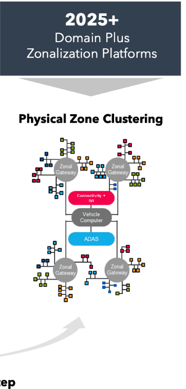

Besides speeding up communications of the bus, so you don't need to segregate the various ECUs onto their own buses to prevent collision and throughput issues, I think what Tesla is implementing here is the Zonal Architecture, where one Computer Control Module (CCM) is connected via gigabit ethernet to zonal switches distributed around the vehicle. Those switches are then wired locally to the ECMs close to it, dividing the vehicle into zones (hence the term Zonal).
Note that this graphic states 2025+, so when people state that Tesla is 5 years ahead of other OEMs, this is why. OEMS are just starting to talk about zonal architecture implementation, but you won't hear that name. You'll hear Software Defined Vehicles closely tied to subscription based features.
By clustering the ECU powers in the CCM (I've personally seen inklings of this in Ford and GM), all other features (steering, powered seats, speakers, abs, etc) are reduced to smart actuators, which no longer process their own features, but receive everything from the CCM. OEMS love this because it pulls all the Intellectual property into their in-house CCM unit, and makes OTA updates easier since they don't have to push to each individual ECU scattered across their vehicle networks. As you've heard, it gets rid of tons of wires and copper, and makes it easier to implement subscription based services, because it's no longer about writing config settings CAN on the ECU that controls seat heating, it's just setting a config on the CCM that they have direct control and communication over.
This is of particular interest to me because I'm in a steering software engineer. I work on projects that combine various code features for steering into one package that we write to our PSCM ECU's that go on steering racks we manufacture. I think within 5 years, my job will be very different. There won't be a PSCM ECU communicating out on the CAN bus. Our steering smart actuator will just receive messages from our zonal controller that comes from the CCM and all those steering features won't have to be integrated into our software binary. My company is starting to use Software as a Service buzzwords because that's what we'll be doing; selling our software steering component features to OEMS so they can integrate it into their CCM software.
So TLDR: When you hear Subscription based services in cars, this is part in parcel of a shift to zonal architecture. I'm not positive this is what's going on in the Cybertruck, but combined with statements like "wiring harness reduction" and "gigabit ethernet" I can't see them half-assing the implementation into something other than Zonal architecture.
