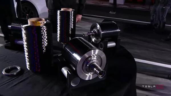

In the mean time I have found some video and pictures of the CF wrapped motors as below:
This shows the CF motor assembly from various angles, however not the internal structure of the rotor itself. Note in the presentation animation showing the battery pack, that 3 CF rotors are all shown at once just before the drivetrain assemblies are placed on top. This would indicate that at least on the Plaid (and probably the TM CT at least, if not all models) they are using the same CF motor. It's unlikely they would have done the presentation to not show how it was done. EM also mentions "tightly wound rotor" and "small gap".

This is the Plaid CF rotor:
Tesla Cybertruck Carbon wrapped rotor motor… s%2F3_ce870711-09d4-4c32-bcb5-3b8f6153248c_600x600

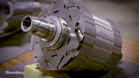

These are the CF rotors and they really do not look like these PM tesla rotors where the magnets are visible on the ends:
Tesla Cybertruck Carbon wrapped rotor motor… ?u=https%3A%2F%2Ftse2.mm.bing.net%2Fth%3Fid%3DOIP

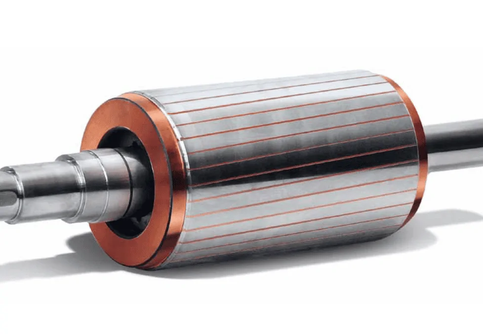

From this I conclude that there is copper in the rotor and that, therefore, these are induction motors. As such their torque derives from slip meaning that the stator field rotates faster than the rotor. Magnets produce torque by following the field. Were there slip there would be lots of cogging. So I conclude no magnets. WRT to temperature copper melts at 1084 °C. CRIM rotors are made by injecting molten copper into the steel lamination stack. Here's a nice pic of one:
Tesla Cybertruck Carbon wrapped rotor motor… CRIM
One of the big challenges (evidently now solved) was dies that could withstand the high temperature without failing after a few shots. Imagine what these temperatures would do to a magnet.
This photo is, perhaps intentionally, too dark to see if the ring has a coppery color and the wrap obscures the bars of the squirrel cage.
At this point there is little (but not zero) doubt in my mind that these motors are CRIM and that the linked posting is BS.

I thought we came to the conclusion that these motors are CRIMs. This article does not conclude that. It states that he knows they are PMSRMs.
