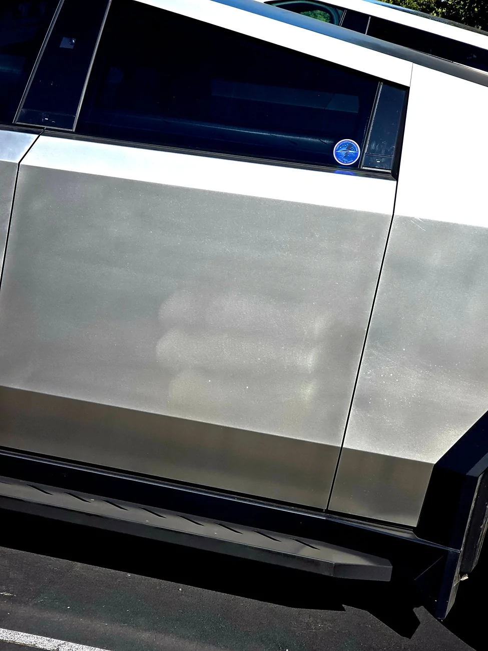

Noticed this really odd sanding job from factory. Has anyone had this addressed by Tesla? I'm thinking about clear ppfing the truck and would rather address this beforehand if possible.
If you take this to service, be prepared with a flash light or something to show them the imperfection.

Related to the original post and to refinishing: I think I'll redo my driver's side rear door soon since clearly my hand is better than whoever did this at the factory:
I'm pretty sure that was not done by a robot (like they use at the factory to create the finish to begin with). Perhaps someone at a Service Center had to touch it up (and didn't know what they were doing).
The secret is move lightly and relatively quickly but, more importantly (and what's wrong with the example above), is to only extend your pattern by one inch on each pass. It looks like they used passes that increased by 3 or 4 inches each pass.
