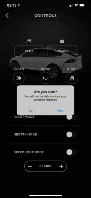

We have Vent which "cracks" the windows but I don't think the fan comes on. Also note that you can't remotely close the windows once you have opened them presumably for safety reasons. If this feature also opens the outside air inlet, which I assume it does, this should help keep the car at closer to the outside air temperature rather than allowing the 10 - 30°F rise that a bright sun can induce.

I'm surprised they just don't turn on the car ventilation instead of opening a window. They can vary the temperature by varing fan speed then. Wouldn't be hard to add it in software, would definitely save some energy, plus protects the interior a bit from degradation.

You can't draw in relatively cool outside air unless the hot air in the car has a way to get out. Just opening the windows a bit lets the light, hot air escape and cooler air comes in to replace it. No electricity is required. OTOH just blowing the hot air around the cabin without letting cool air in accomplishes nothing.

Most cars have a rear vent built in. Doesn't take much once the fan is on.

There has to be some kind of air inlet or Tesla's scheme wouldn't work. If the natural draw moves enough air why bother with a fan?
