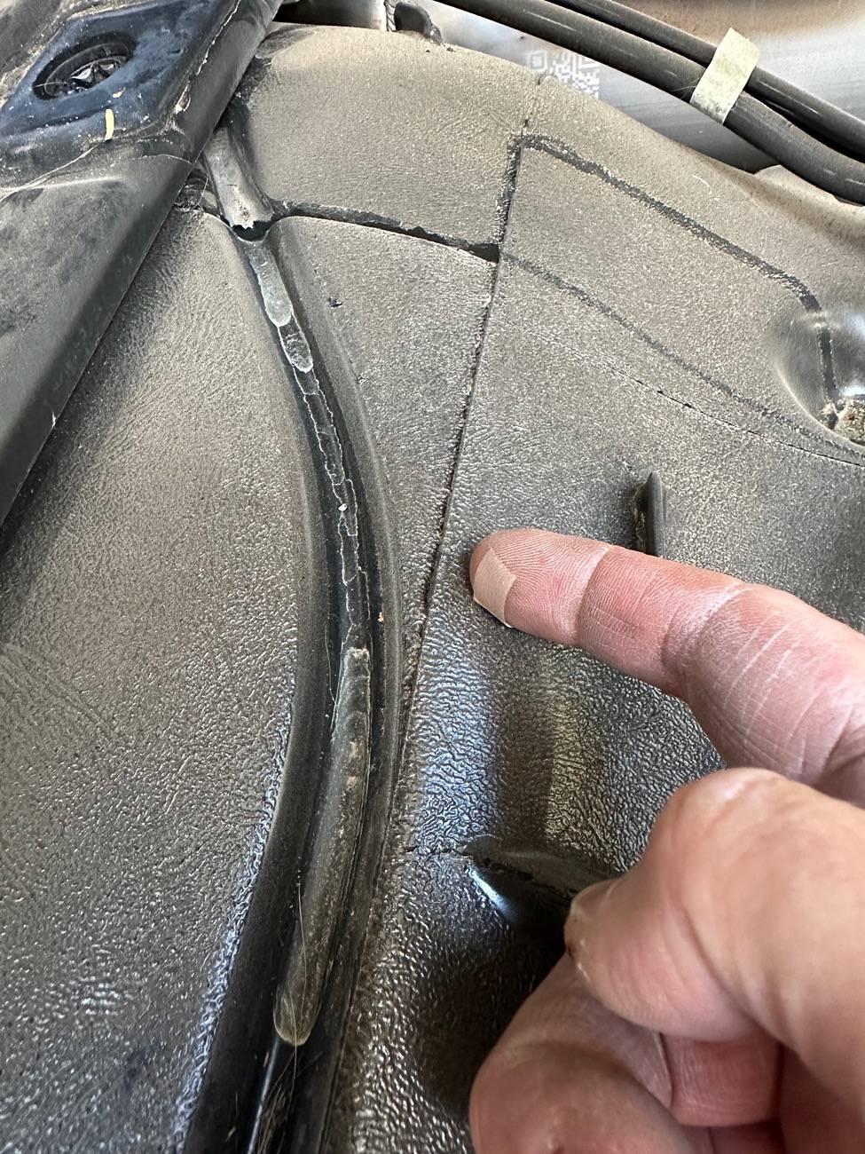

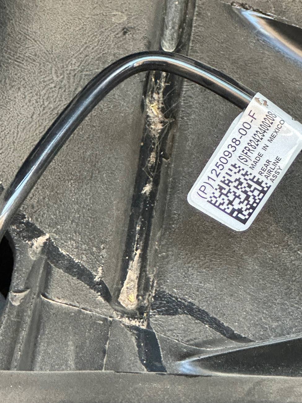

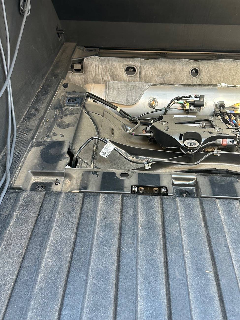

I sliced my finger as if with a razor blade while inspecting the air tank and very lightly/casually running my finger along an edge/ridge of the aluminum casting.
Ouch!
Lesson learned!
The truck’s unicast body has these ALL over the friggin’ place. Be more careful than I was!

I have heard some weird noises (rarely) like a sudden release of air pressure that seems unrelated to the air lift, and that was one reason I took the floor bed cover off. I also was measuring to see if there was space to cut the floor bed to allow for mounting the 35-inch spare tire vertically, and my initial engineering thoughts after taking a few measurements are that it would be a bad idea to do so.
And I continue to try and recreate and locate that bizarre air whoosh rushing sound.

Yeah cars have sharp edges, but not like that. As most cars were/are assembled by persons - even the parts are relative free from sharp edges. Sharps parts also cause damage to things around it like other parts on the shelves, scraping material off the shelves and packaging.
In Aerospace there is a term call FOD. Foreign Object Debris. Which can be completely catastrophic when it occurs in internal plumbing, like:
Brake lines
Fuel Lines
Cooling lines
Hydraulic lines
Entire vehicles, entire production lines, and WIP [Work in Progress] has to be disassembled to find the cause. And typically the causes are detritus collected after the part is made and during parting handling.
Looking at his photo where he cut his finger, there is a 'assembly' with lines and hoses. So consider what happens when you are 'servicing' that assembly, detach some components and drag them over / out-of-the-way and they are cut/damaged by the 'innocent' process?
I would be piss & vinegar if I pulled a brake line from a caliper and the fender sheet metal was sharp enough to slash the line.
Most ICE cars don't have 'razor' sharp edges. They should be designed to be 'serviceable'
My assumption is that he dragged his hand across the novel 'cast' frame as anyone would - and got bit.
I worked as a machinist for many years - any guy who made a part and left burrs - was a looser. You deburred the parts even though the drawing did not expressly call for it.
I am appreciative that he especially called attention to the cast frame being sharp - so if I bury my arm down there - I want to pull back all my fingers...

The rear subframe is a single-piece casting AFAIK, so I'm not sure why there are seams. Other photos of this piece (like here) show much more subtle lines.
I'm guessing that the casting die is not one single machined piece, so that the casting ends up having a small seam at the junctions. Those junctions probably degrade over the lifespan of the die, and thus and leave behind a little extra material.
