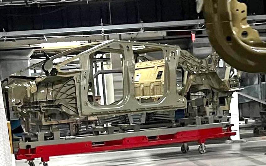

Don't be sad, crew, when you realize what you're looking at. This is likely the most comparable production vehicle made, as far as I can think of at the moment. In my opinion, the CT is a hybrid spaceframe vehicle, which at least has a cool name. The battery pack, peaked rooflines, massive high-strength pillars, and highly-reinforced firewall and rear panels will make this a rigid truck capable of the intended specs. You should expect that this will be the safest production vehicle ever built and will likely remain so for quite some time.
We'll have a reliable and solid truck if Telsa fully integrates all suspension control points into a single subframe, ensure that the gigacasts are highly repairable, and designs all outer wheelhouses and outer body panel mounts/extensions as fixed and bonded components that can be easily replaced. The backside of the fenders and bedsides/quarter will likely be scored at multiple angles to allow for folding during an accident and not allow the panels to shear off and fly away, i.e., Captain America's shield, decapitating chaps along the way. Of course, they must also plumb a/c into the vault if they don't want CT owners to loathe the company ;)

Just curious and don't judge me for not knowing. How many castings are used to create this frame skeleton? Are several castings welded together? Thanks in advance.

Yes. Thank you.
I find the argu... uh, discussions about exoskeletons pretty amusing, but at least it's something to help with the waiting.
That said.....
It's a bit surprising that anyone could think that the use of "exoskeleton" in the Tesla announcements meant there would be no supporting structure under the skin of the Cybertruck.
It doesn't seem reasonable to me to think that all of the suspension components along with all the other functional loads - motors, batteries, doors, and so on - would be somehow attached to nothing other than a shell of stainless steel plates that are bonded together along their edges.
It does seem reasonable to think stiff and strong sheet metal that is properly bonded to an underlying structure adds substantial strength and rigidity to the overall assembly and allows more of the mass of the vehicle to be moved to the exterior. "Moving mass" is another way of saying reducing the mass of the underlying structure.

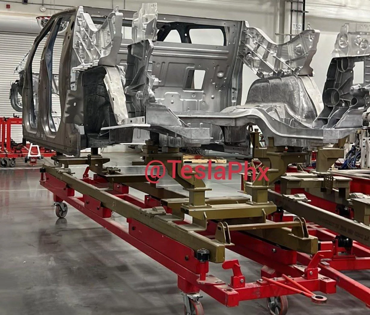

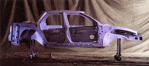

People saying "guess no exoskeleton" have no idea what they're talking about. This unibody frame was shown on reveal night, never changed. Here it is, just without the castings but with the body panels attached:
I included the image with the Ford to demonstrate what they're talking about. The Ford is a body on frame, so everything is plopped on the ladder structure. Cybertruck is unibody. When Elon said they would push the mass to the outside, he never said there wouldn't be a frame, they showed it right there. Just stainless steel skin and seats would be ridiculous.
And this isn't new, unibody cars have been around for decades. What is new is doing it for a real truck that can carry 3000lbs or tow 15000. Getting rid of that central ladder enables much more efficient packaging and dramatically reduced overall weight which should give the Cybertruck significant competitive advantages in space, comfort and energy efficiency.
Precisamente! Translated: yeah...that...whatever he said! ?
You couldn't put it together better, people in general have no idea the amount of weight and moving parts already erase with an unibody chassis.
