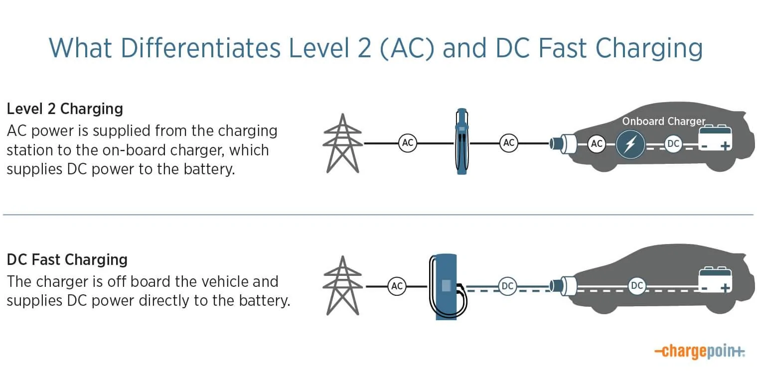

Tesla Cybertruck Charge sharing service-it's a million dollar idea B195408D-1FAC-4E88-980A-91F8EC410D60
MATRIX (simple)
Tesla owners can charge worldwide on the factory Tesla plug at a Tesla V DC Supercharger or Tesla AC (Level2) Destination charger with Tesla supplied adapter. Tesla now build Dual Connected cars that incorporate the Tesla plug and one of the national standards (above) in the vehicle home market for public access chargers.
Tesla Supercharger / Destination (Level2 Matrix)
Every electric vehicle on the road today is compatible with the U.S. standard AC Level 2 chargers, known in the industry as SAE J1772. That includes Tesla vehicles, even though they come equipped with a Tesla proprietary Supercharger connector plug. A Tesla owner will use the SAE J1772 Charging adapter that came with their model to connect a standard J1772 AC Level 2 charge plug. The company has installed "destination chargers" (basically AC Level 2 chargers) at hotels, restaurants, and shopping centers. Tesla is now additionally factory equipping its newest cars with Dual Connect for national standard receptacles and plugs in markets such as Japan, China and EU. Dual Connect Teslas in addition to Tesla Supercharging around the world, owners can charge at national standard charge stations locally without needing an adapter in their home market.
PUBLIC CHARGING (AC / Fast Charge DC Matrix)
Tesla Cybertruck Charge sharing service-it's a million dollar idea C2B34420-8FCA-4304-8BAE-3CE9BF6FF1C2
The way PUBLIC chargers work they are compatible if fitted with the proper adapters and communications interfaces.
Level2 (AC) “public” and Tesla “destination” chargers are prevalent at the least cost. Depending upon market three types of (AC) plug standards exist now:
  • SAE J-1772 - North America and Japan
  • Mennekes (Type 2) - most of the EU
  • GB/T (AC) - China
Four major “public” DC fast charging standards exist right now:
  • CCS Combo 1 - North America (and some other regions)
  • CCS Combo 2 - most of the world (including Europe, Australia, South America, Africa and Asia)
  • GB/T - China
  • CHAdeMO - DC “only” Global and monopoly in Japan

Currently in the US at Level 2 (240VAC) a Tesla can be charged from any J1772 charger using an adpater. It can also, of course, be charged from a Tesla HPWC (wall charger) or Tesla UMC (Universal Mobile Connector). Tesls is J1772 compliant. It can be charged from J1772 equipment with the adapter. Conversely, all Tesla EVSE can be used to charge any J1772 compliant vehicle with the proper adapter.
At Level 3 in the US a Tesla can only be charged at a Tesla Super charger or at at CHAdeMO station using an adapter. No CCS vehicle can charge from a Tesla Super Charger in the US.
The way the chargers work they are compatible if fitted with the proper adapters and communications interfaces. Elon Musk has always said that Tesla SC are available to any OEM who is willing to pay its share of the freight. Tesla SC with CCS connectors exist in Europe and have charged non Tesla cars but Tesla was not pleased.
31,475
AC chargers are on most things. A few have only offboard AC chargers, this saves bulk and weight.
L1 - wall outlet - granny cable -> (any brand)
L2 - J1772 cable - J1772 receiver (non-Tesla)
L2 - J1772 cable - J1772 adapter -> L1 granny cable (most brands)
L2 - J1772 cable - J1772 Tesla adapter -> (Tesla)
L2 - Tesla Destination charger -> (Tesla)
L2 - Tesla Destination charger -> Tesla Tap adapter -> J1772 receiver (non-Tesla)
L2 - Tesla Destination charger -> Tesla Tap adapter -> J1772 adapter -> L1 granny cable (most brands)
DC charging is how the battery actually gets charged. This is basically a charger you don't have to carry around. It's technically L2 (DC) but most people call it L3
Chademo -> (some brands)
Japanese standard. The Leaf had this. Many older brands used it. I n the US, its power-limited, but not in Japan.
Chademo -> Tesla Chademo adapter -> (Tesla)
CCS -> (some brands)
CCS1 is the US standard and CCS2 is the EU standard. They're not the same. The new Leafs have this, the Bolt has this. There's supposedly a Tesla adapter in Korea as they use US standards, but none in the US yet.
Supercharger -> (Tesla)
EU Superchager 2 -> Equal to CCS2 -> (non-Tesla)
No other brands have taken Tesla up on their deal yet for Supercharging.
There's a couple of older standards you might find out there in the wild, but they're so uncommon as to not mention. I skipped the Mennekes (EU version of the J1772) as it's the same grid as J1772. EU power has up to three phases which means everything even more complex!
