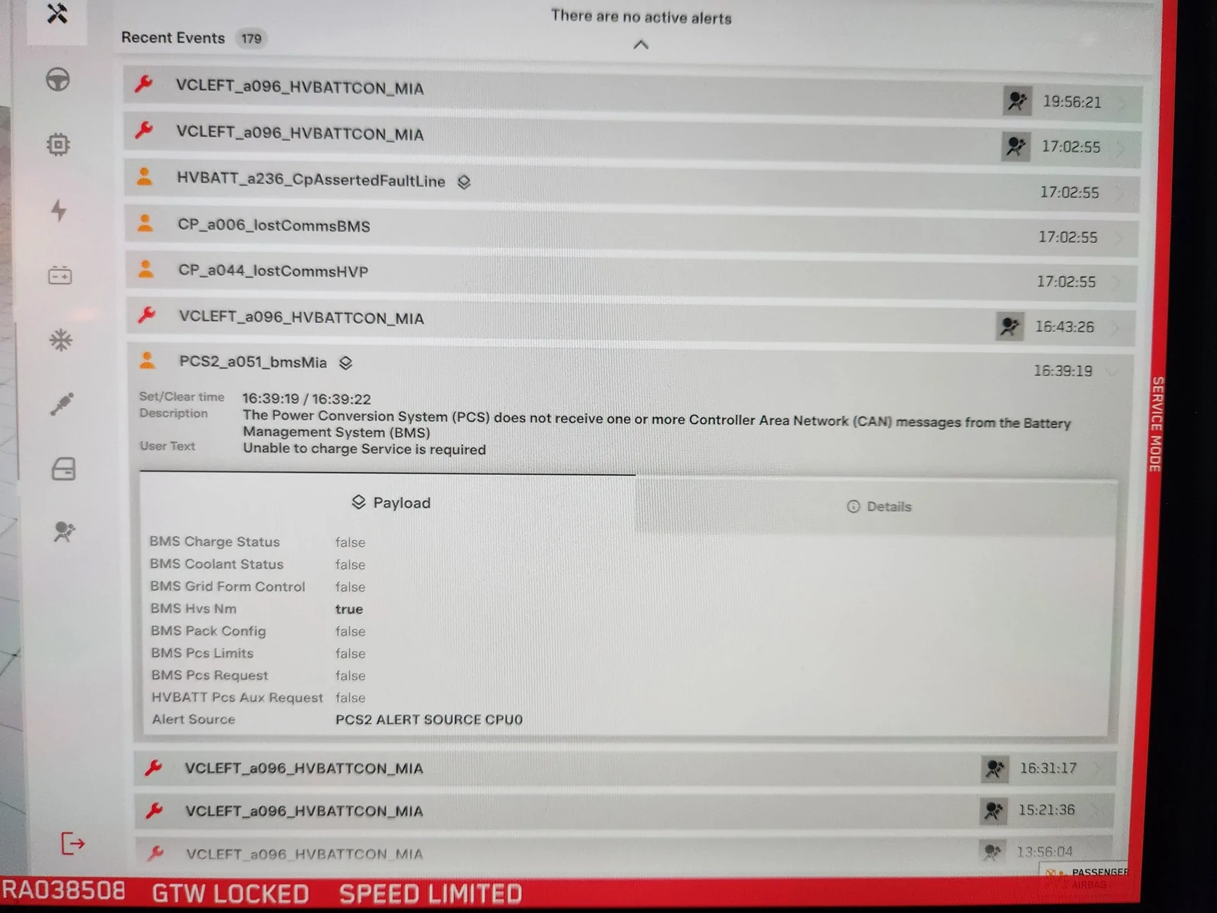

Had my original PCS replaced with Rev-E 4/2025. ive added approximately 6500 miles since and got:
PCS2_a051_bmsMIA- service required unable to charge
and
VCLEFT_a096_HVBATTCON_MIA intermittantly.
asked for remote diags but im pretty sure i know what this means…
