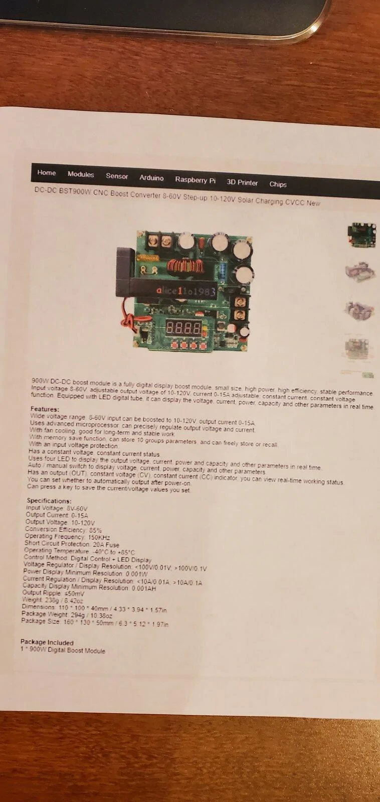

That would clearly be the minimum risk approach but is such a kluge and so out of the spirit of the endeavor that I didn't even suggest it.
I don't know anything about your converters other that what is in the spec sheet. The spec sheet implies that they can be configured as current sources. You could configure each of them to be a 2 A current source. Then whatever the battery state and whatever the sunlight available they will adjust the PWM to try to push 2 A each into the battery at whatever voltage it is charged to. If the battery is charged to below 120 V the converter will adjust its voltage (by modulating the PWM) to whatever voltage is necessary to push the 2 A. If the battery is charger to a level such that 120 V cannot push 2 A the charger will simply go to the highest voltage it can, 120, and whatever current flows will flow. Clearly if the battery is charged to above 120 V the converter cannot deliver any charge to it.
This makes for a very simple connection. Simply wire each converter to the battery bus through an isolating diode (so that if 1 converter is at 118 V and the other at 117 V the former's current will go to the battery and not the lower voltage converter. These diodes also prevent a battery charged to 124 V from feeding power to the converters at less than 120 V.
As I've indicated in the earlier posts when the battery voltage exceeds the converter voltage no current can flow in either direction because of the diode.
With respect to the battery safety: if the pack open circuit voltage is 120 V at some safe SoC such as 80% this arrangement will never charge it above 80% but it will never hurt it either. If the safety boundary is at some lower voltage you can still configure a safe system by simply setting the converters' voltage limits to that safe voltage.
Now what you really want is a converter that reprograms its output current periodically and stays at whatever current maximizes the output from the panel. I am referring, of course, to one that does MPPT.
Yes but telling an old EE that you have a transformer when you actually have a DC/DC converter surely confuses the hell out of the old guy.
Thanks brother. I will really need to dig for info on my dc converters. They were $19 on Amazon. :)

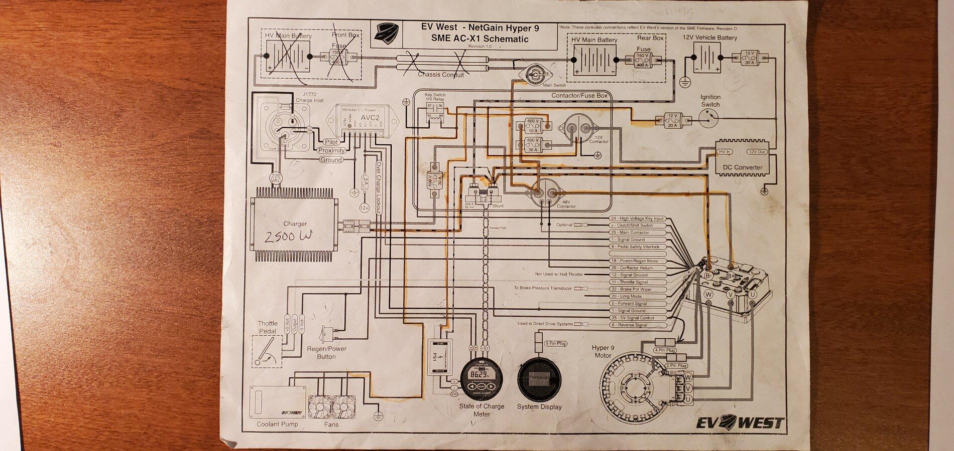

Really ! I missed an ee term and assumed folks would know that my batteries are dc. I know the difference between ac and dc. I built an electric car albeit with a kit diagram in my garage after work. Btw my panels tilt and I live in Utah.
I would suggest working on building a battery pack from scrapped lithium or NiMHs if you're looking for a project to raise your knowledge of how these systems work. There's kits or at least plans out there now.
