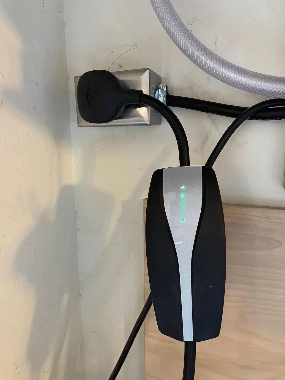

One thing nobody seems to have calculated, particularly those speaking in favor of 120v 12a charging, is the load of Sentry mode, overheat protection mode, and cooling the car when it's really hot. When we got our car, the garage it parks in front of had a 240v 30a twist-lock for my welder, and a 120v 20a recep. Since the car didn't come with the 30a plug, we charged from 120v for a while. It became apparent that this would be unsustainable in the long run, particularly if we wanted to charge only during off-peak times. Running Sentry mode and overheat protection mode (fan only) kills a few kwH per day. If you pre-start the cooling, it will actually use more than the outlet can provide. Once you count in peak/off peak limits, the remaining power per day is VERY low. And if you charge during peak, well, $$ wasted.
I made up a cord to go from the L6-30 connector to a 14-30, and bought the Tesla 14-30 plug for the mobile charger. Now the car can very comfortably charge in the night, and do a quick full-charge top off when needed for trips. And I have more plugs to go with me to charge anywhere.

Hey man, as the major voice pointing out that 120v should not be ignored as a valid - I did point out that those are very good reasons to install faster charging. And that I, myself, have done so. Quite inexpensively, I might add.
