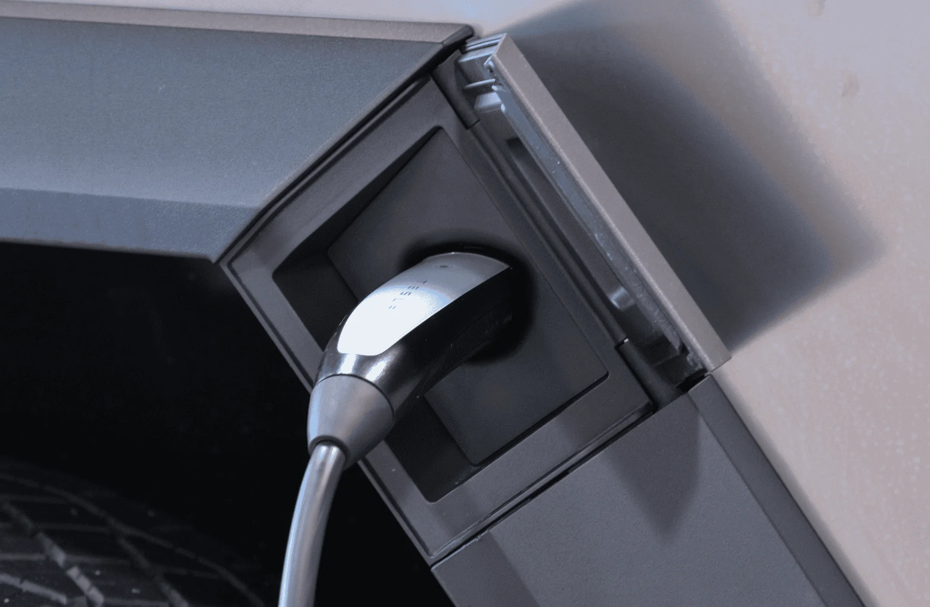

It uses the stardard NACS cable and connector as with the charging port on all Teslas:
