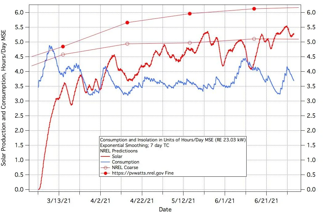

No. Not at all. Quite the contrary. I pointed out that your result and the numbers I gotwere not inconsistent. I also wanted to point out that weather is quite random and can make a fairly big difference in what panels can harvest. Here's what I've seen in Northern Virginia in the last few months:
The red line is a recursive average of MSE hours I received with a smoothing time constant of 7 days. The open circles show the NREL prediction for my region and the solid circles the NREL predictions from the pvwatts program for a much smaller geographical region. Note that what I'm getting is well below the latter data base's predictions. The coarser NREL estimates seem to fit my situation better but note that even so the MSE varied from half an hour above to an hour or more below recently whereas in March they were well below (an hour or more) either of the NREL predictions. That's why I said your estimates were probably a bit optimistic.

No. Not at all. Quite the contrary. I pointed out that your result and the numbers you had were not inconsistent. I also wanted to point out that weather is quite random and can make a fairly big difference in what panels can harvest. Here's what I've seen in Northern Virginia in the last few months:

Ok so optimistic compared to your specific location in comparison to your local data ;-)
Yes. Optimistic compared to the real world as represented by places auch as Chicago and Denver.
I'd imagine you have some shading as well that would have ro factored in. Obviously, especially low angles will be subject to shading that won't be represented in pvwatts.
I think pvwatts does allow for some shading.
So I suppose we can work with those numbers at least to make comparisons between regions.
That's where ephemeris based MSE comes in. It tells you how geography comes into it. pvwatts tries to stir in weather too but it can't account for that maple tree or a corner of a dormer. Just using NREL MSE with your estimates of panel and DC/DC converter efficiency will give you the best you can expect with tracking but without particulars of shading from that old gum tree. The numbers for a 2.7m^2 panel aren't that impressive.
