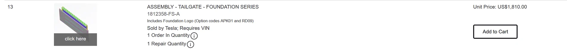

I have the rear washer installed and it's awesome.
Just a tip - I installed it to my main wiper system instead of the front camera washer (if that makes sense).
You can't use the front camera washer when FSD is engaged which makes this solution almost useless unless you put your car in (D)rive. So, instead, I installed it to my main washer system to wash both my front windshield and rear camera system at the same time.
Worst case scenario, if you change your mind or want to revert to factory, you can repurchase/replace the rear tail gate for $1,800 USD and replace the T-fitting with with a L-fitting. No harm, no foul.
I'm 99% sure It does not void warranty - no one at my service center has ever said anything nor voided any warranty work.
