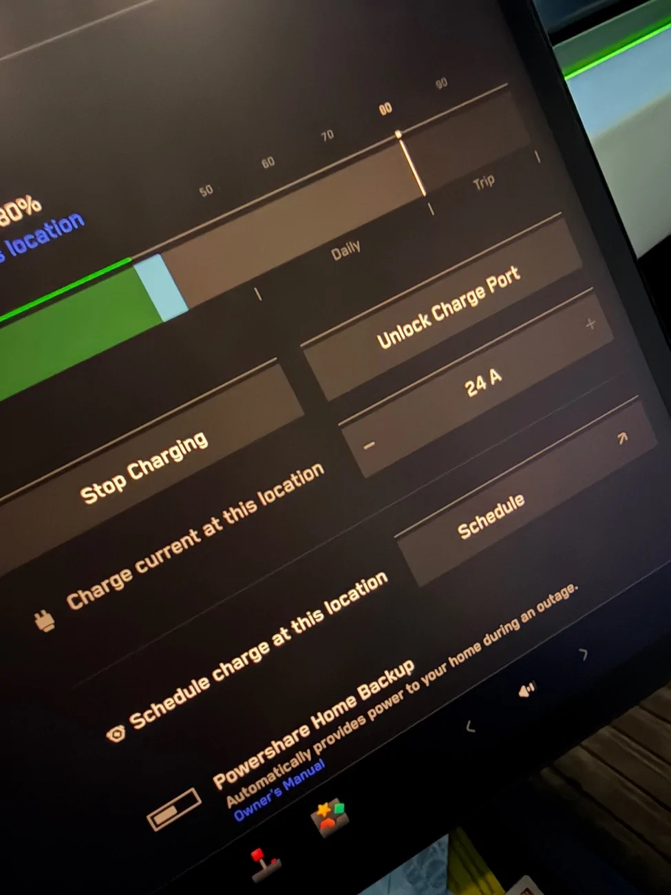

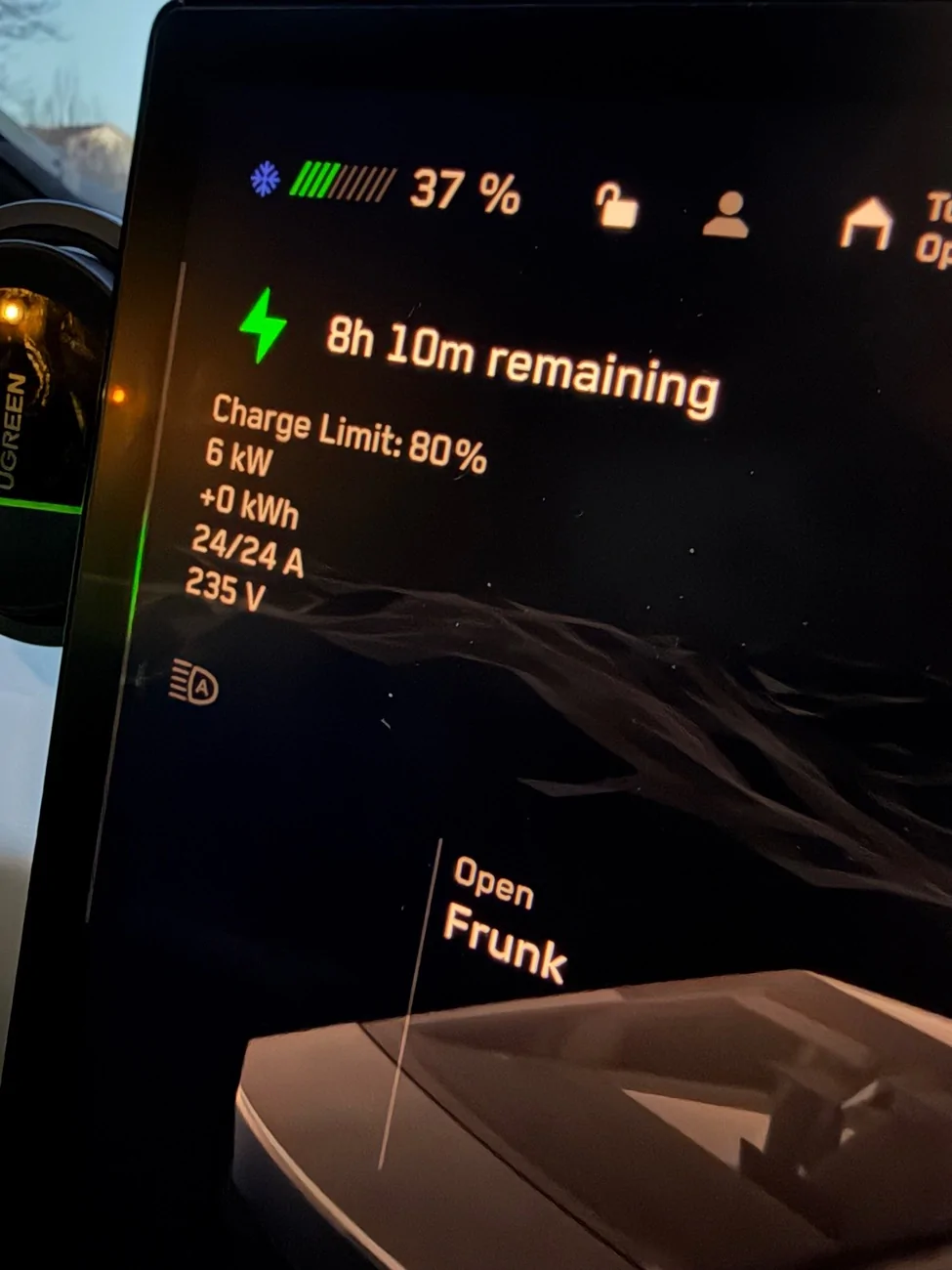

I’ll try to be brief:
Moved my work office, and had a wall connector installed.
- 208V three-phase service
- 60A breaker
I commissioned the wall charger and set it to 60A in the USA.
I plugged in, and only get 24A. The “+” is grayed-out on the charging menus.
I tried turning breaker off/wait/on, recommissioning, etc.
Nothing changed.
I just got home and plugged in and happened to notice in the Tesla App that I’m charging at 24A here, too.
Same grayed-out “+” in the truck. And I’ve always charged at 48A at home.
I then remembered that this morning I fleetingly thought it odd that it charged overnight and went from 20% to only 78% instead of a full charge.
Any thoughts?

I saw the same after the software update about 2 weeks ago. I have a 60amp breaker, which SHOULD show 45 amps [which is the limit of the tesla home wall charger].
The software update about weeks ago - was showing 24A on my app.
However, yesterday, I did see on my CT dash the amps back up to 45amps - when I plugged it in at home.
I assumed, and still assume it was due to software update.

I charge @ home from a hardwired Wall Connector. I have been noticing lately that my charging on the CT stops a few % before the SOC I set. I have 80% SOC set for charging and it stops at 76% or 78% and won't go any further unless I slide the charge limit to 82 or 85%.
I have always been charging @ 24 Amp although I can go to 48 Amp if I want. I am connected to the fuse panel with 6/2 MC and a 60 Amp breaker so I should be able to do 48 Amp charge if I slide the charge rate in the car or on the mobile app up to 48 amp.
The reason I charge @ 24 amp is to keep everything running a bit cooler and keep the bugs/ants off of the charge cable in the summer. The cable doesn't get "HOT" or even warm @ 24 amp and I don't need the faster charging.

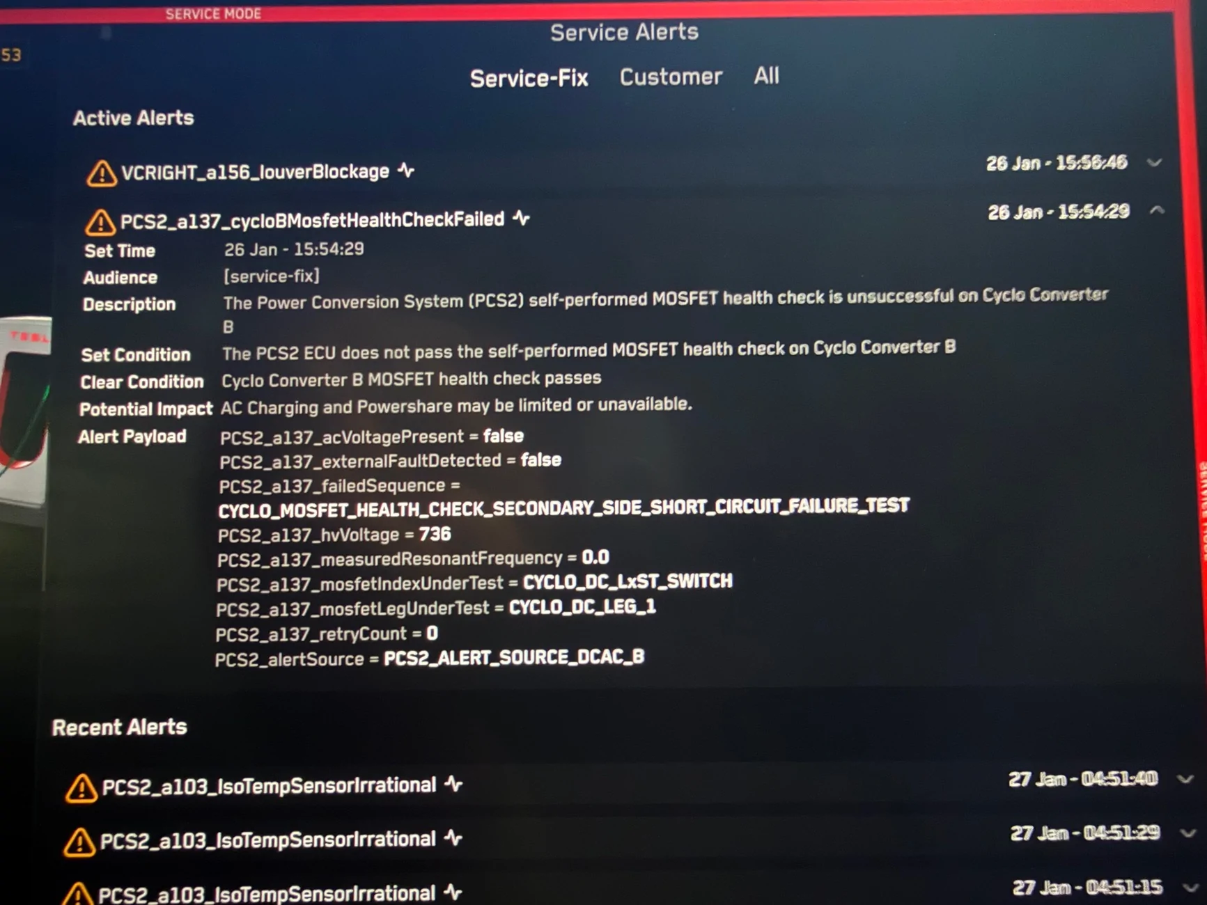

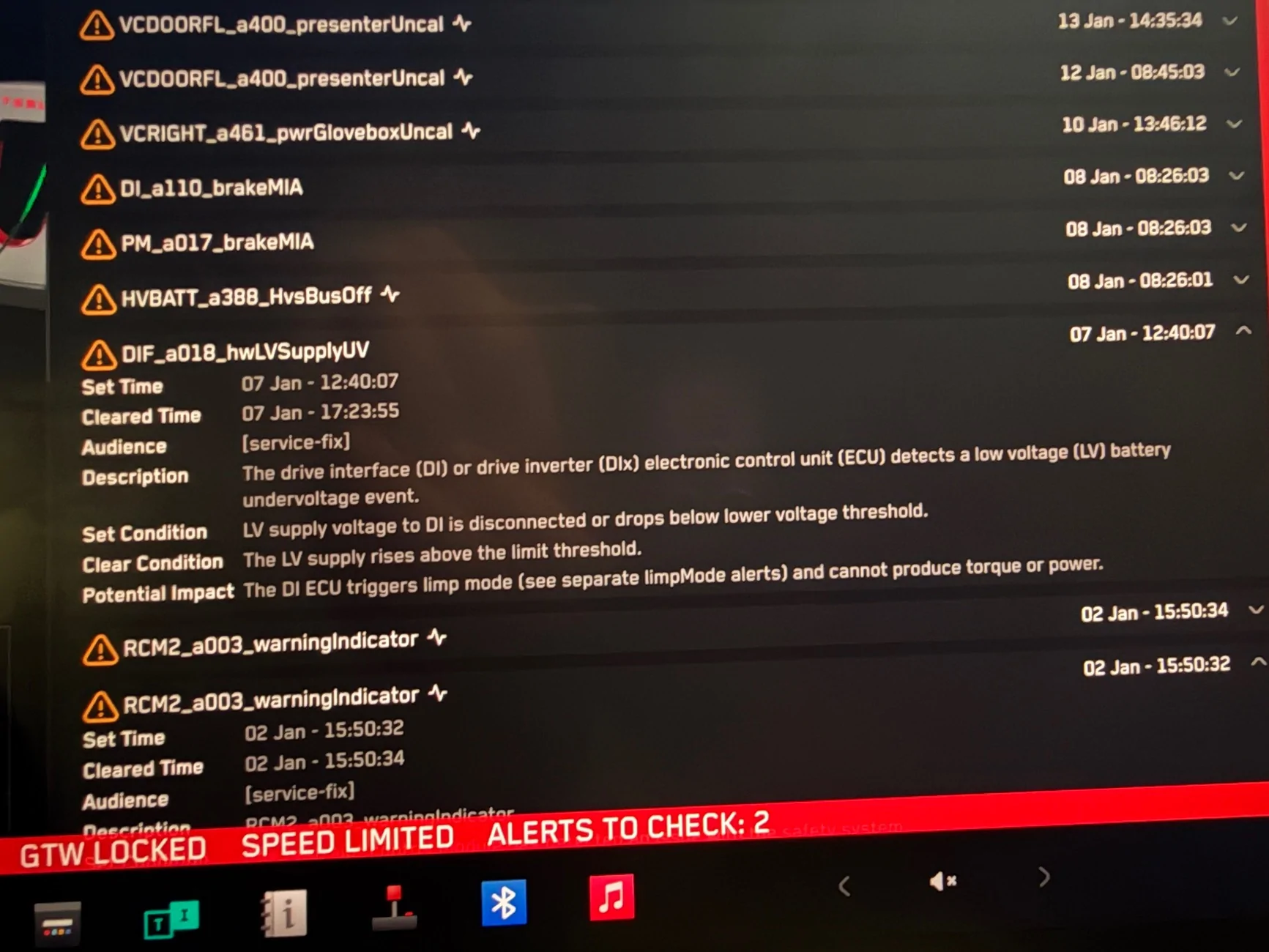

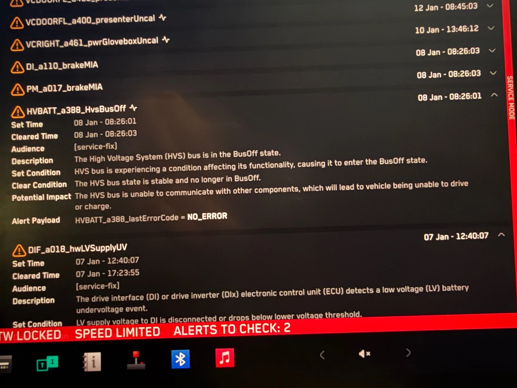

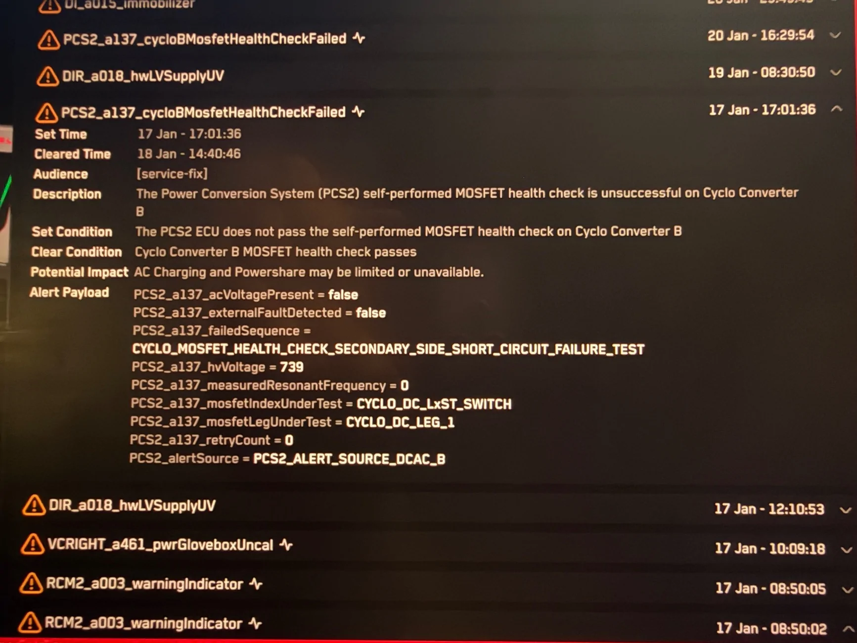

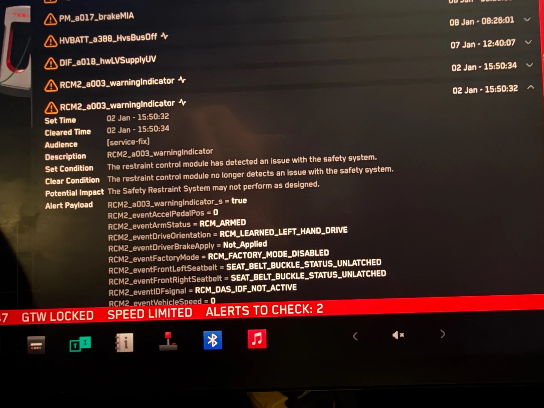

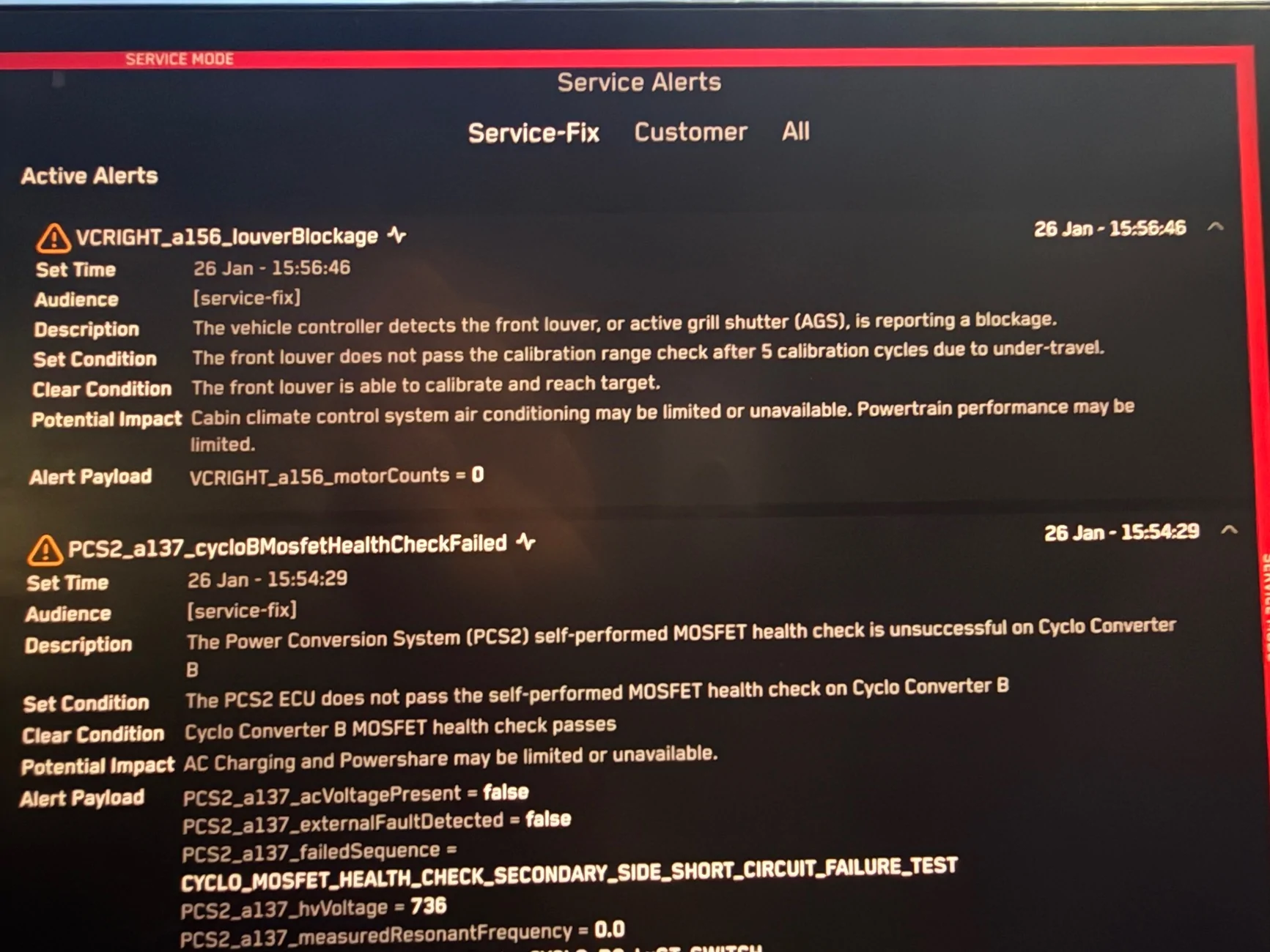

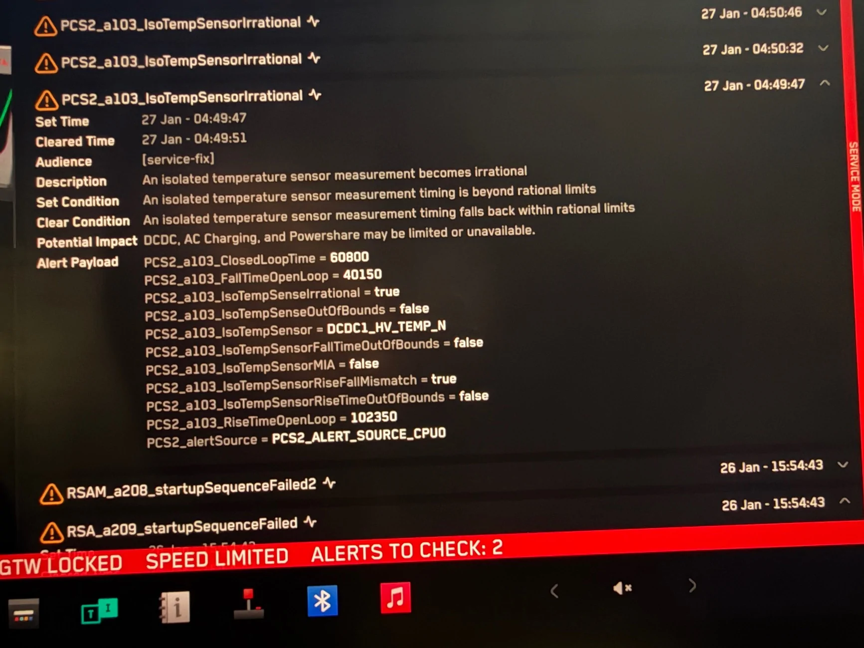

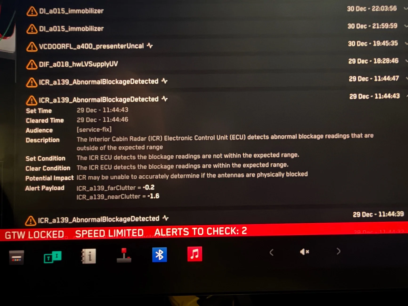

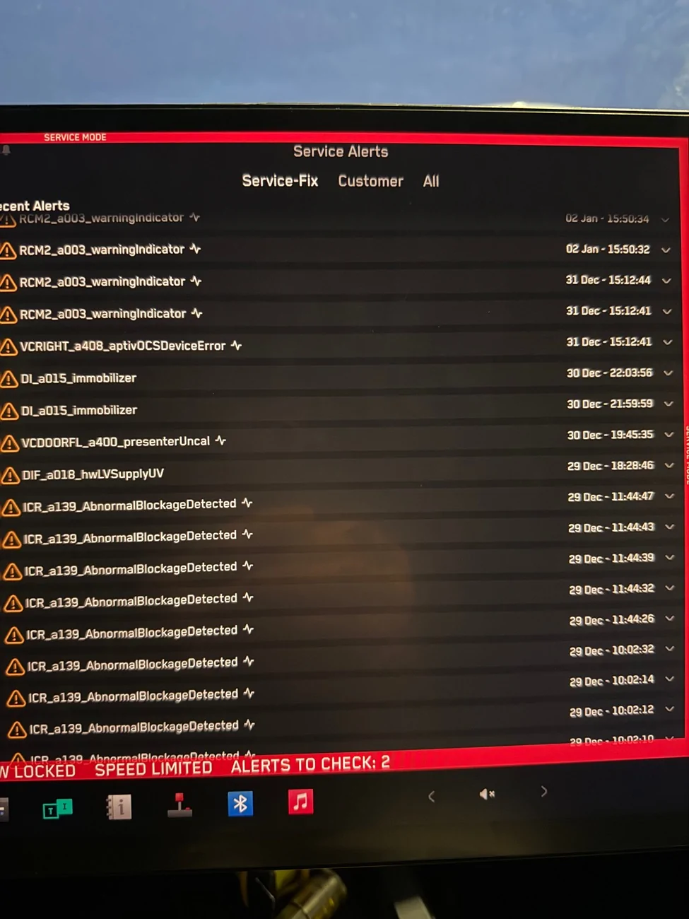

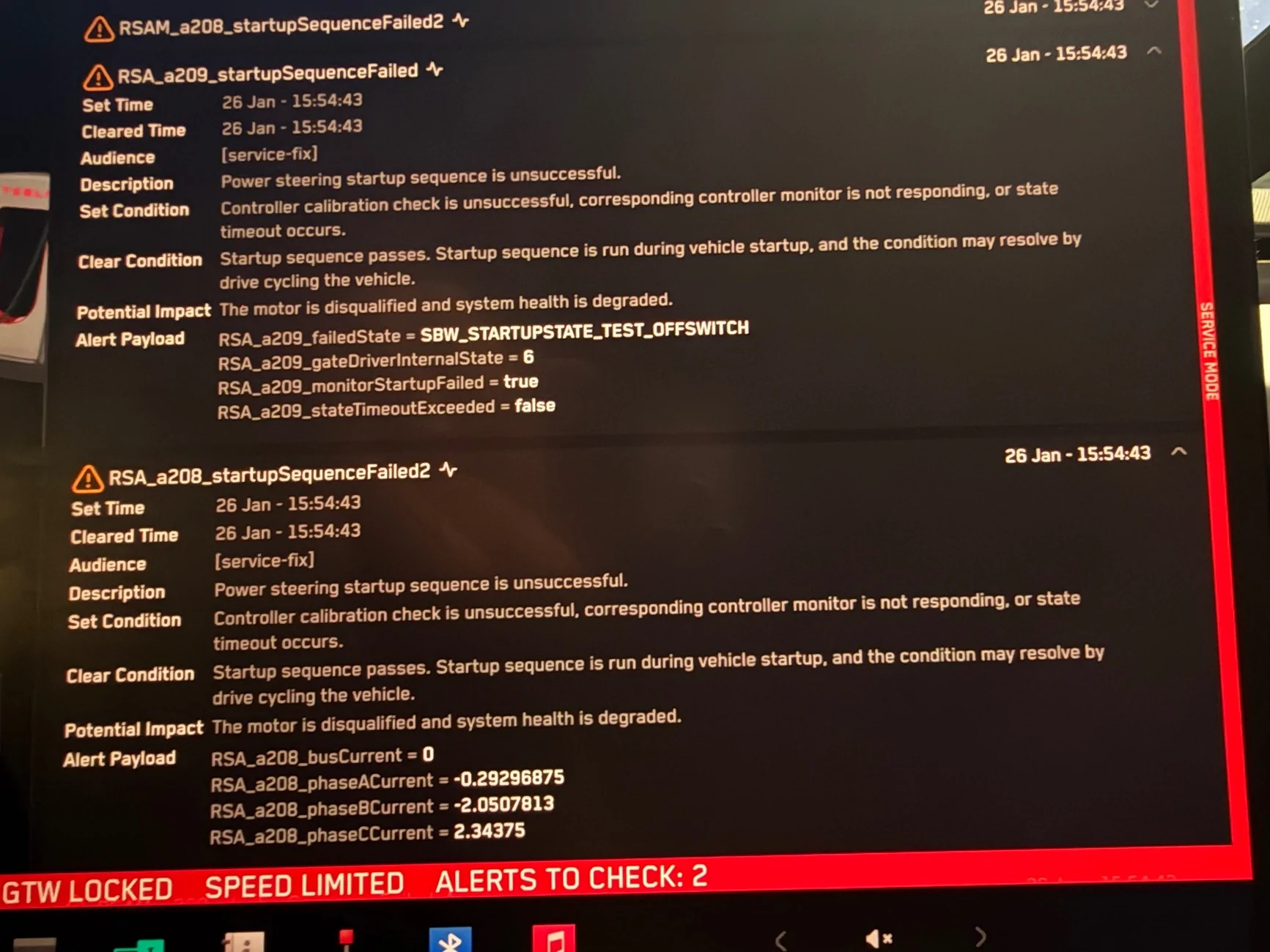

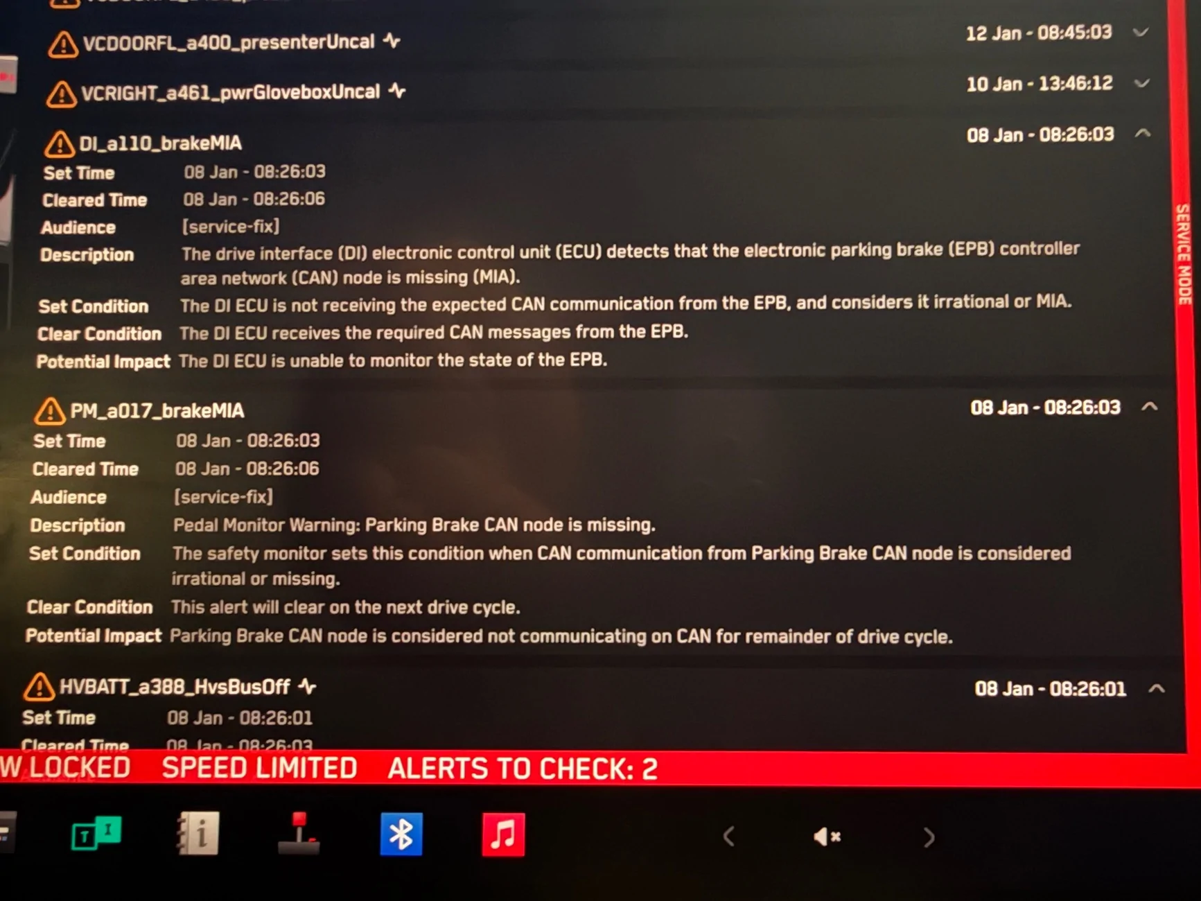

Accessed SERVICE MODE to a bunch of errors.
Gibberish to me, but may be interesting to some of you smart guys:

PCS has a failure on one half of the DCAC converter and the front air flaps are jammed/ frozen. So you'll be limited to 24A AC charging.
I see that - are they related at all?
It doesn’t seem so since the PCS errors started well before?
Are the Air Flaps a physical blockage and something I can correct/look for myself?
Assuming you have this knowledge. If not, sorry - just wondering.

UPDATE:
Service Center replaced the PCS under warranty, and it seems to be good now.
