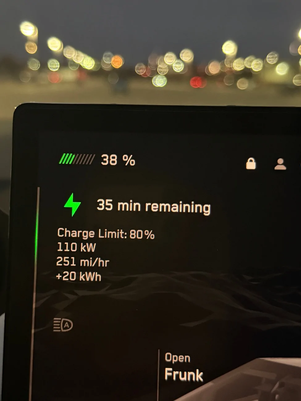

Using a Supercharger this morning
I’ve never looked before now, but shouldn’t the delivery be well above 110kW at a V3 SC Station?
Tesla Cybertruck Confused with charging AMPS IMG_2015
  • Like
Reactions: REM
REM
Dec 9, 2023
3,573
6,637
Professional Retard
That charge rate could be nominal depending on conditions, though I would expect closer to 200 kW if your battery is warm and no other cars are charging beside you.
