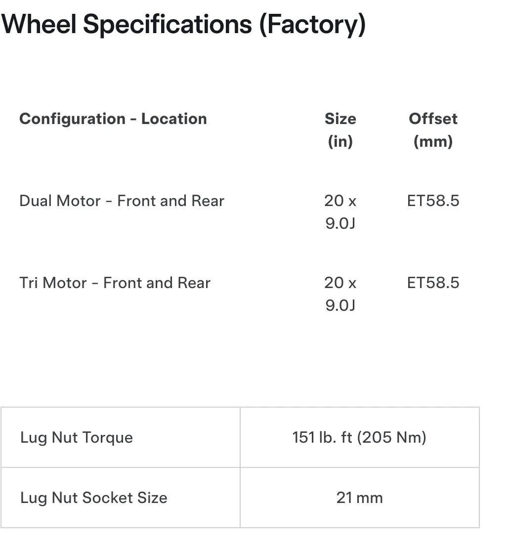

Hello gents,
can anyone confirm if Core wheels are identical in size and offset as FS wheels? We know both are 20” as both AT and AS tires are same size but I’m curious if they are also exact same width and offset? 20x9+58.5?

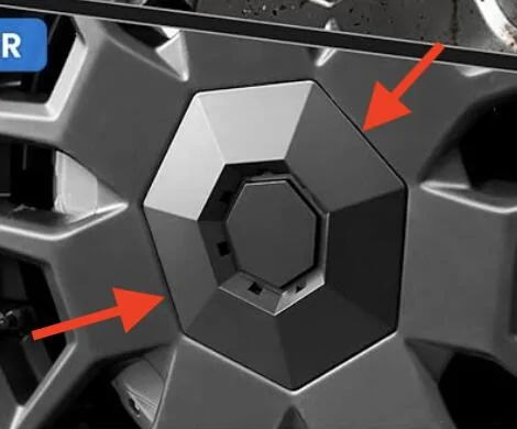

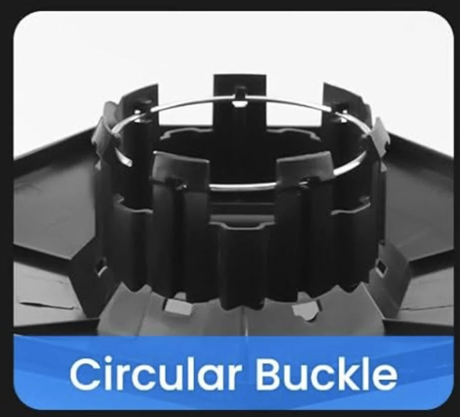

Is it the diameter and/or depth of the center piece that doesn't fit?
Tesla Cybertruck Core wheels vs FS wheels - identical spec fitment? Screenshot 2024-10-23 at 4.00.26 PM
Any issues with lining up on the outer edge?

Its the depth of the wheel covers that make it not work. The core wheels are slightly deeper which is the reason why the cyberwheel caps don't fit on. They might barely clip on if you push it in hard enough but they will pop off quite easily. In addition, I also tried the caps you pictured and there are little "fins" behind the cap that prevent that particular cover from fitting on even more.

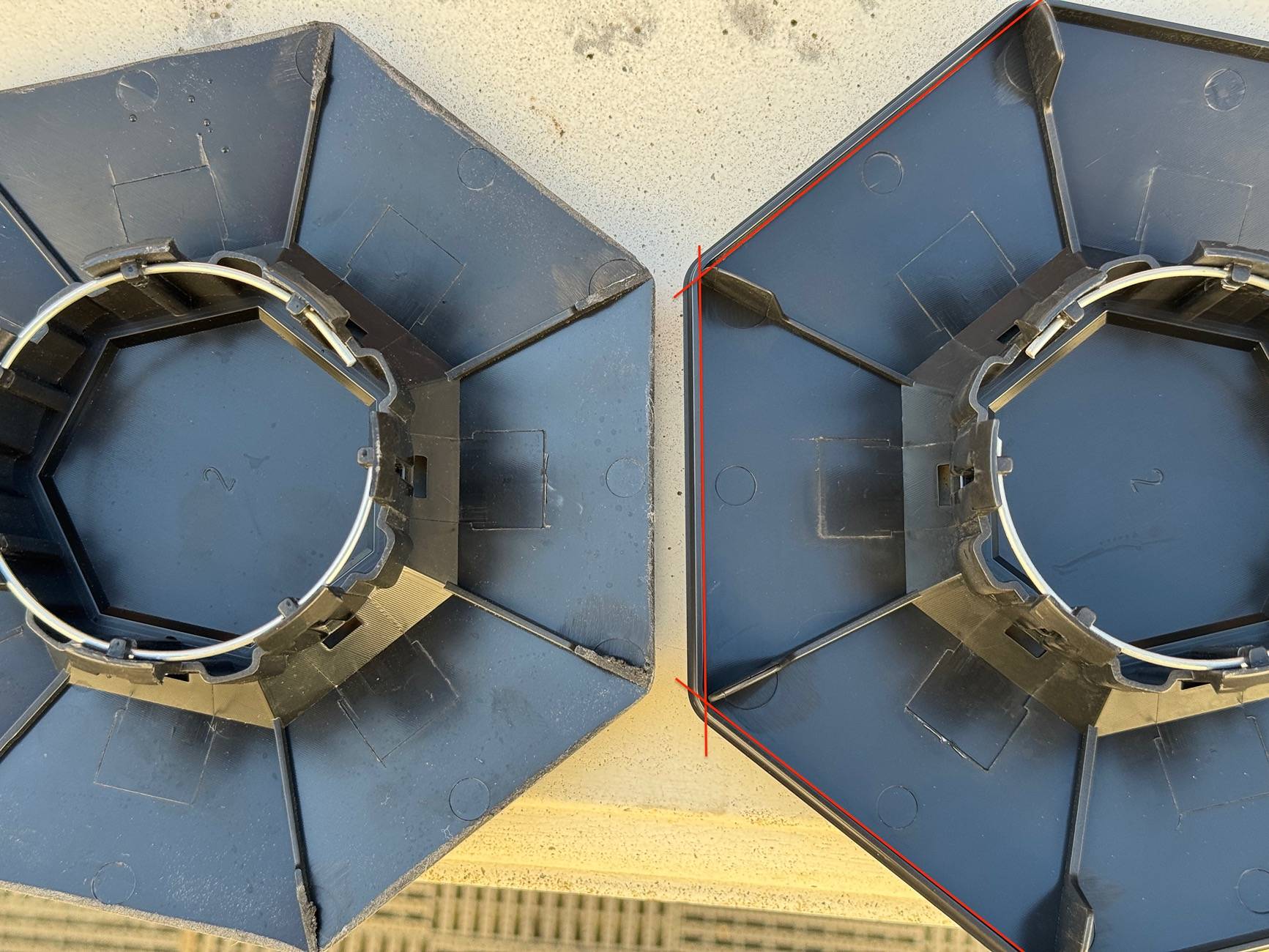

Well, I know what you're talking about now. I tried shaving down the "fins," but it took a bit more than that. I ended up cutting it along just inside the 'ledge.' (marked in red)
Tesla Cybertruck Core wheels vs FS wheels - identical spec fitment? IMG_8115.JPG
Cool thing is I think it looks good.
Tesla Cybertruck Core wheels vs FS wheels - identical spec fitment? IMG_8113.JPG
Bad thing is that I trimmed a bit too much inboard and the cap can rotate slightly in the wheel making it not align with the rim. Boo.

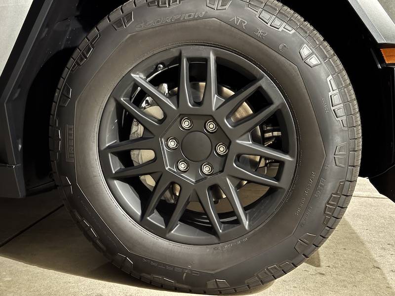

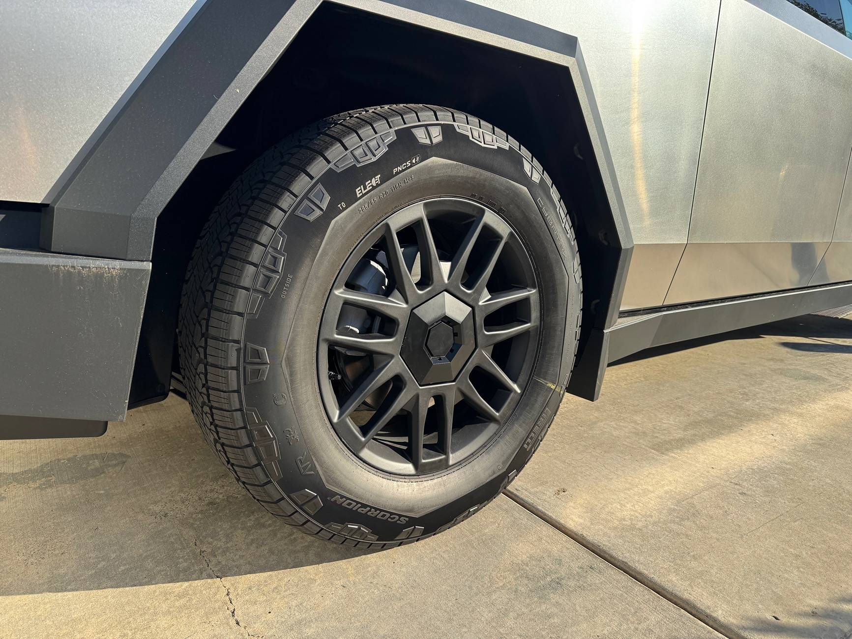

Ended up ordering these in matte black: https://www.amazon.com/dp/B0D2Q4L855?ref=ppx_yo2ov_dt_b_fed_asin_title&th=1
And they fit fine.
Tesla Cybertruck Core wheels vs FS wheels - identical spec fitment? IMG_8140.JPG
