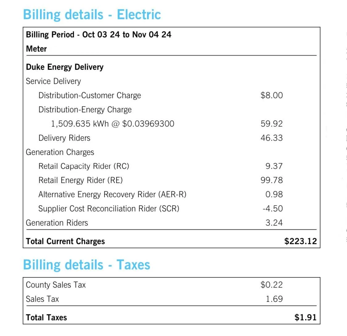

Supercharger rates in my area are $.41/kWh.
So, theoretically, a 0-100% charge would cost $50.43.
Home rates:
Tesla Cybertruck Cost to charge at home IMG_3034
What’s the same theoretical 0-100% charge cost when done at home?
Are the various rider charges constant/fixed, and therefore not part of the calculation?
I have to be missing something - it can’t be $0.039693 x 123, since that would only be $4.88.
Don’t judge
I’m new to EVs and my brain is tiny.

Total cost divided by total usage times kw used. So looks like around 16 cents per Kw for you or around $20 for full charge.
Compare your monthly bills to get an average cost and see what the fixed costs are.
Total of $225.03 (including tax) / 1509.635 = $0.149, no?
Are all the other charges (other than the $.039693) proportional to usage?
Are any of those other charges fixed regardless of usage? and therefore not a “real” part of the charging costs?

*If* the delivery rider is a fixed amount, it looks like incremental usage is $0.11/kWh (post another month's bill to see). Otherwise, around 15 cents.
For comparison, our DTE rate in Michigan is $0.19/kWh

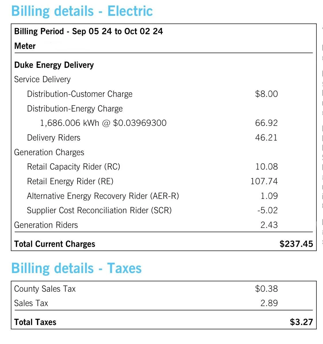

Dingus me
Didn’t dawn on me to check previous bills to see what’s fixed/related to usage.
Prior bill:
Tesla Cybertruck Cost to charge at home IMG_3035
The $8.00 distribution is the only fixed charge, so I’m at approximately $0.14/kWh.
