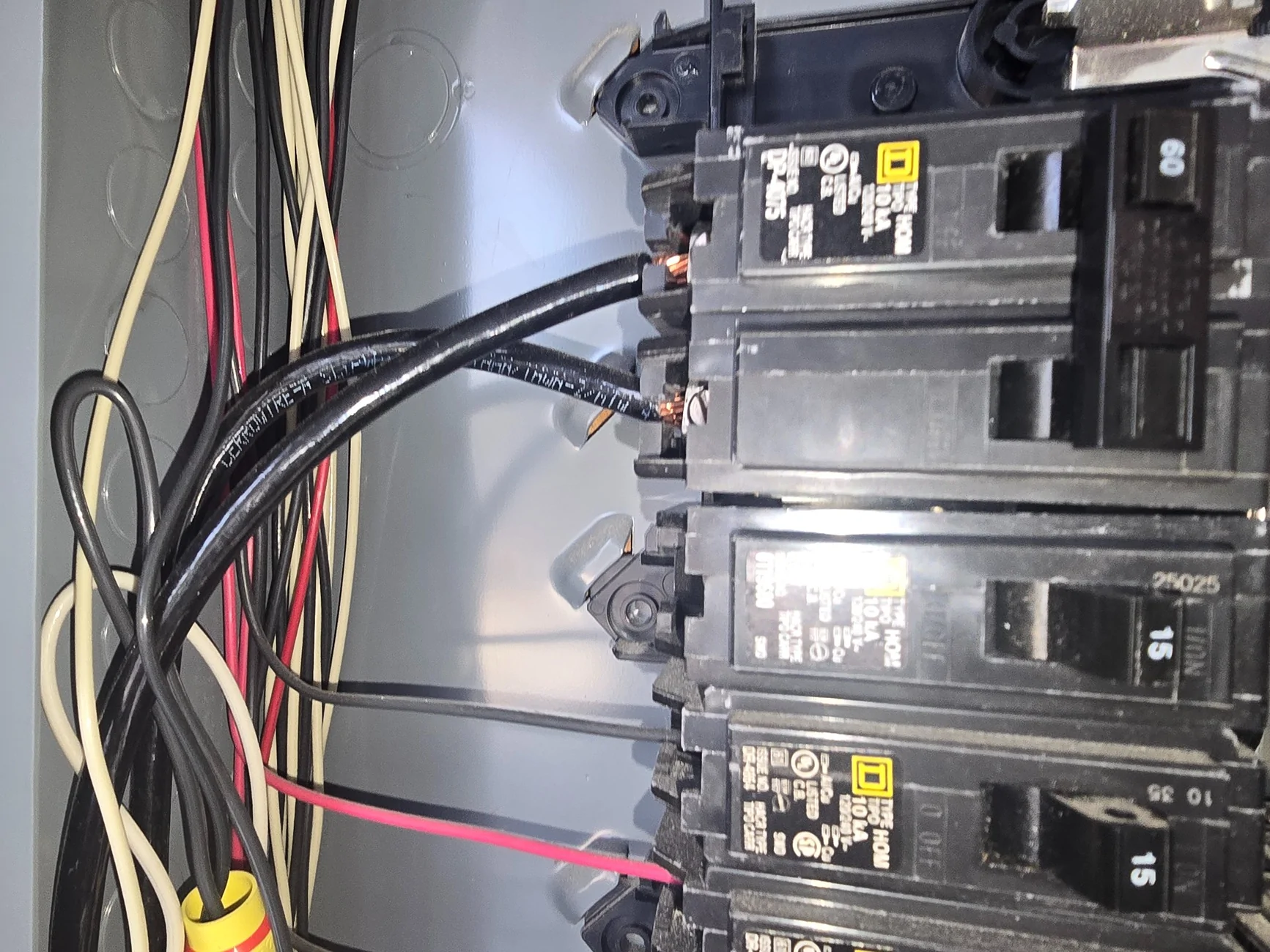

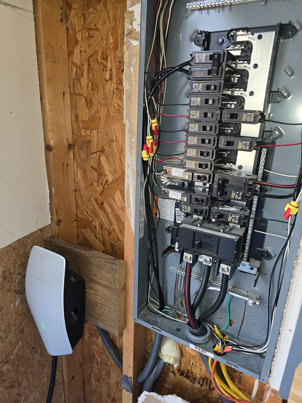

OK, I finally got around to pulling the front panel off and taking some pictures of the charger wiring to the breaker.
The first picture is the breaker and the wires.
The second picture is the panel to the charger.
The large cable coming through the wall at the bottom is the main power line coming into the house.
There is another panel to the right of this one that is powered by the battery back up system for the house.
So is this your PowerShare panel, usually 12 breakers

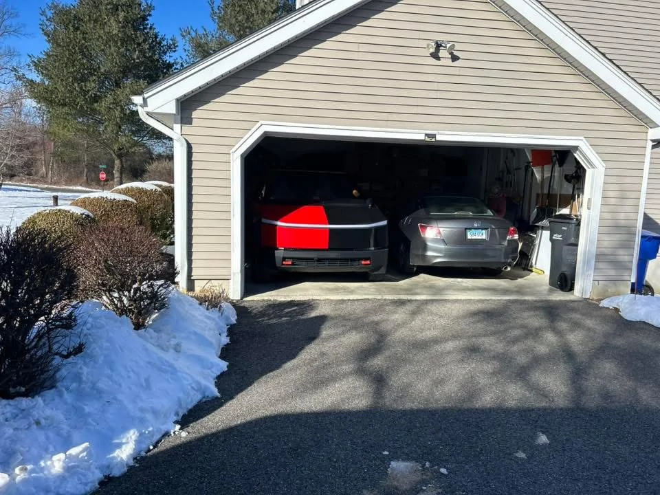

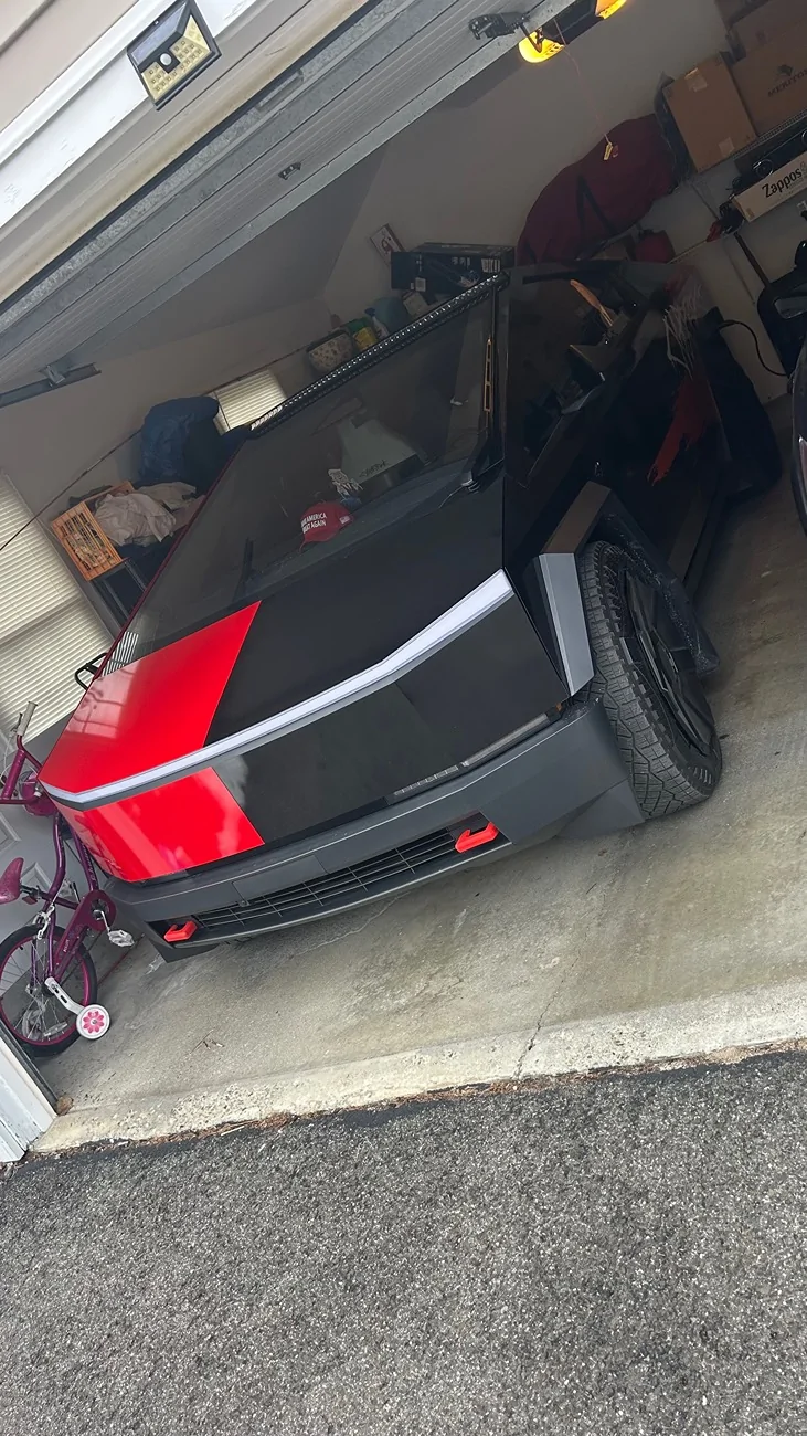

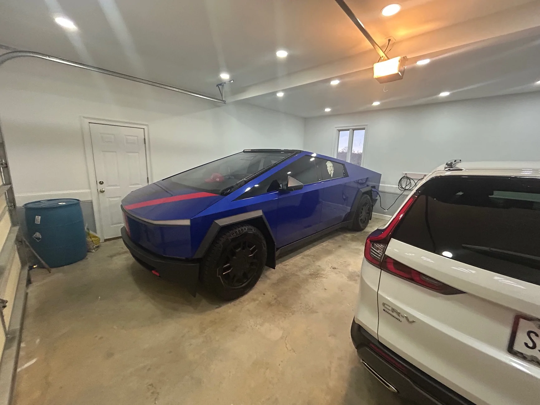

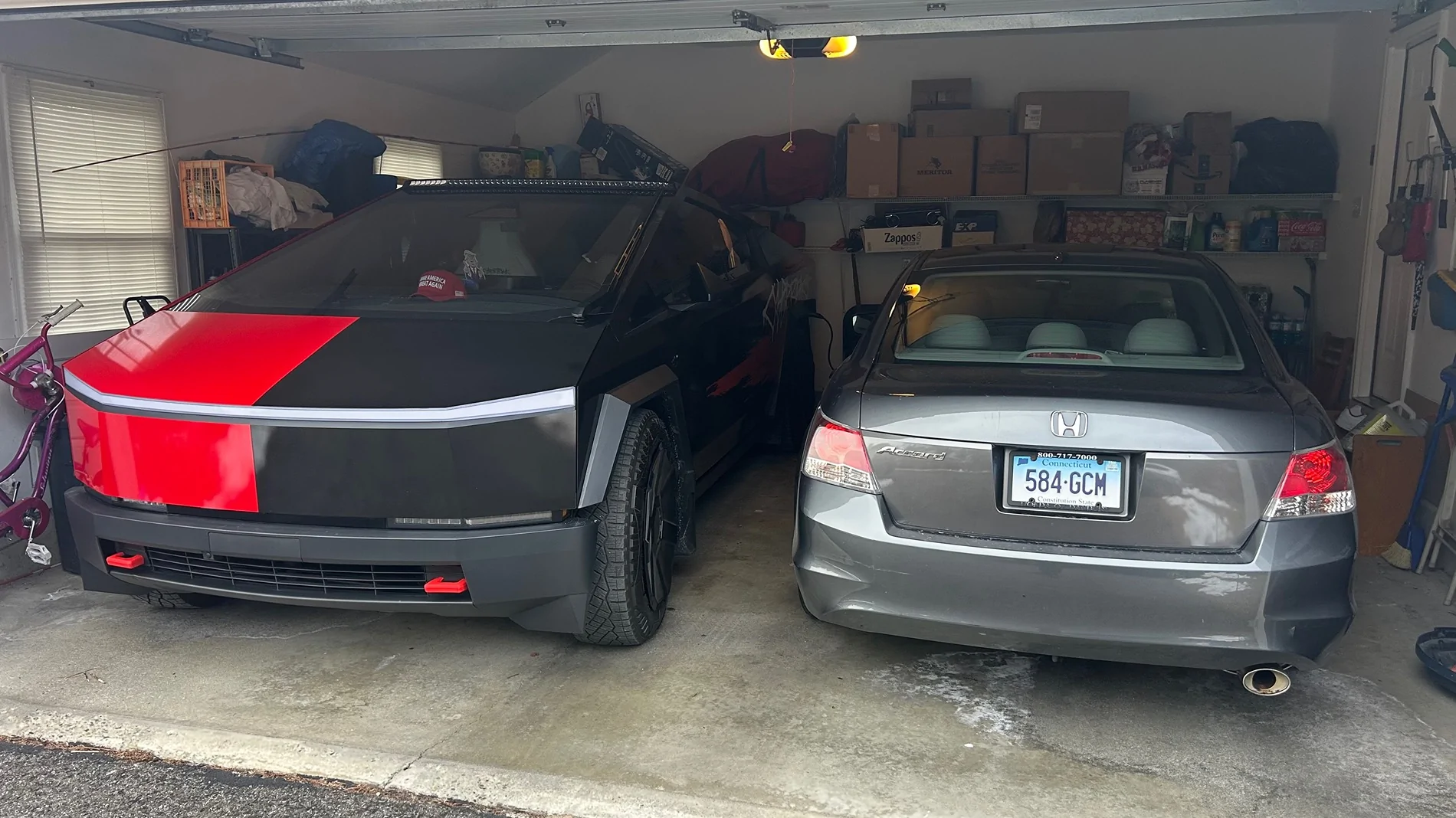

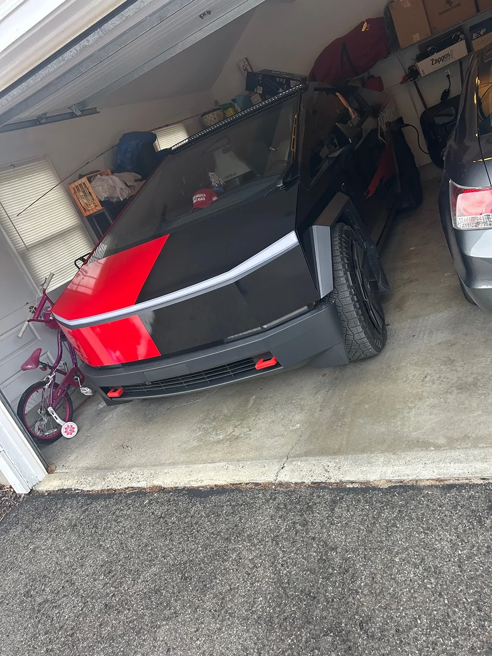

I have plenty of room in my garage, remember this truck is as large as my ford excursion. Cybertruck is 224” long 84” wide 75.4 inches high
Any excursion measures almost exactly the same footprint just a hair, taller.
If you can get your Porsche and your F150 in the garage together and I say it’s a home run
You don’t want to be tripping over the cord. It sticks out when plugged in

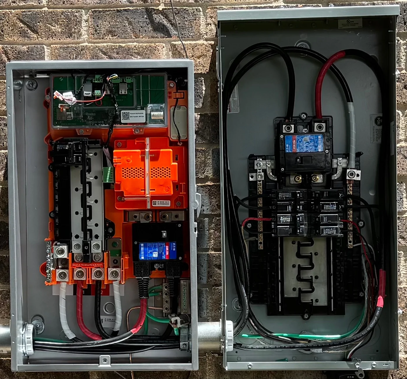

That is not a PowerShare panel.
Here’s my 3V gateway during installation, next to the new main panel on the right.

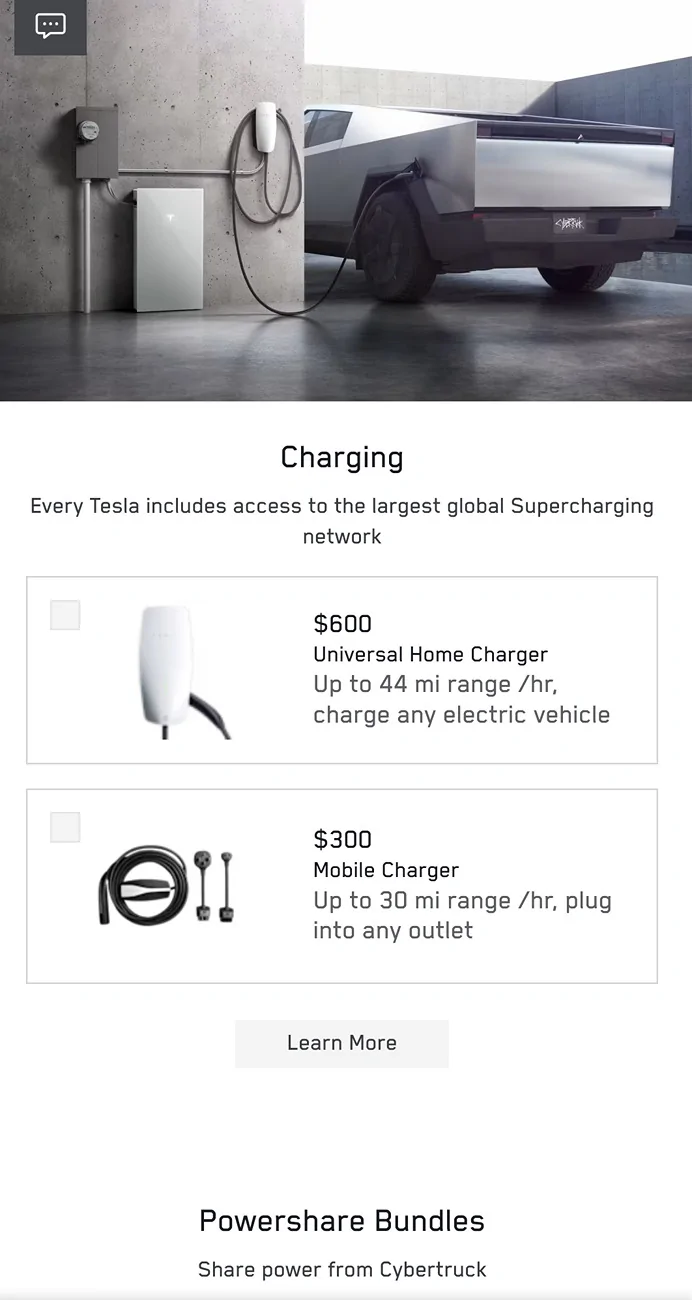

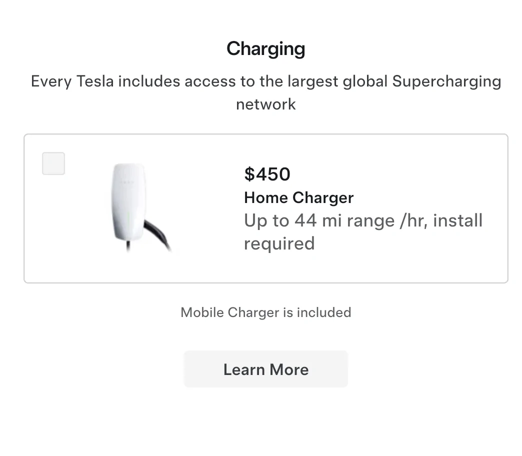

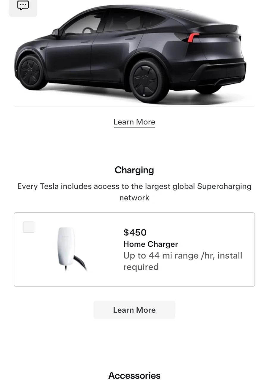

I am going with not included on base CT. As it shows an option to buy one. Others as @mongo mentions says included and don't show the box to check to buy.
The website is a little funky though.
No Cybertruck trims say mobile charger included.
For Y, only AWD is missing it and it doesn't have the connector purchase option.
It's not called out at the bottom as included equipment either. 🤷‍♂️

My garage is basically same dimensions as your red/black truck space. I can fit my carrera and f150 but I dont because it's too tight for the length of the truck and I dont want to do precision park every time. I have just a foot in front and behind the f150.
wait till you learn FSD and Self Park, and this is where "summons" will work perfectly
it's coming
