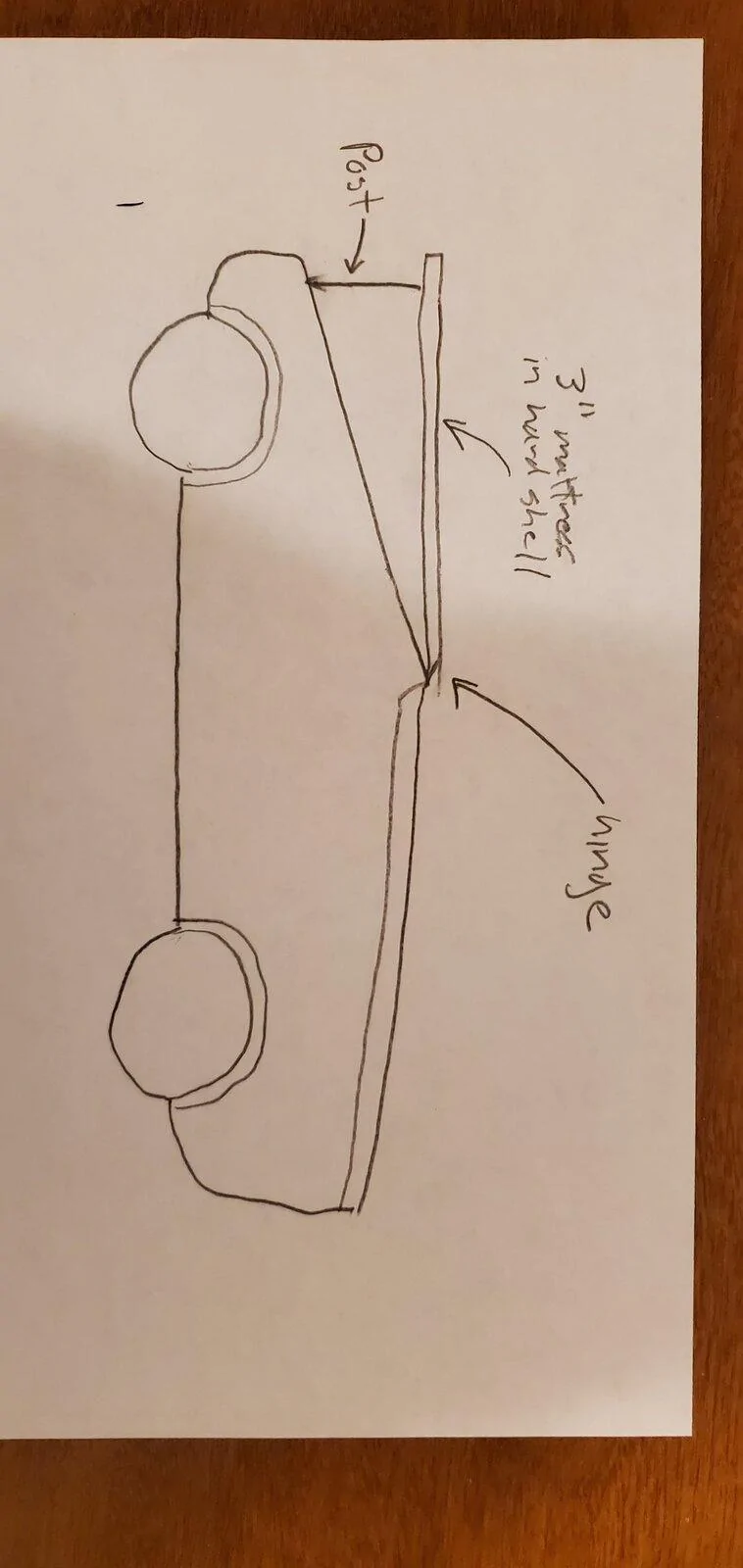

Is there a photoshop pro out or other artist out there that could turn this into a rendering?
I didn't draw the tent, but this package would generally stay on your rig most of the time. It would not weigh much or affect your aerodynamics, You could easily stand up in the tent section from the truck bed. You could even crawl around your campsite while deployed to move to the shade or grab a better spot. You could fit solar panels into the hard shell and remove them to stands while camping/deployed. They would generate decent power while parked everyday. You could use some sort of strap winch system to deploy. One pulling/the other a brake. The tent could be an air beam as others have suggested or an accordion type system or just crawl through the back and insert some poles. I bet you could get this set up in less than 5 minutes in a rain storm. With careful consideration for the tent construction, you might be able to pivot it open part way if you had to carry larger items without removing the entire unit.
If you wanted to get fancy, your stove/kitchen area could be on rails and project out the back.

Tinker 71,
Three really good ideas:
1. The front hinge. Should be more durable than a conventional pop up. This concept is already in production https://palominorv.com/truck-campers/rogue-truck-campers
2. stove/kitchen area could be on rails. The kitchen cabinet lives up against the front of the vault, but rolls to the tailgate when camping. So when cooking, you are standing on the ground. The tent above provides shelter.
3. The tent could be an air beam. I'm imagining you could deploy an entire "bouncy castle" using the onboard compressor. Folding it back up could be a challenge unless it's designed to "undeploy" using a vacuum.

Tinker 71,
I missed a critical arrow showing the operation of the hingle. It rotates 195 degrees. In travel mode the whole camper only adds 3 inches to the height of the rolling cover. (Which would either be retracted or removed.) It does not extend over the hood.

To me one of the most important aspects of this design is to have the Cybertuck heat pump provide the HVAC inside the camper. That is one of the advantages of the "unfolding tent" that Tinker 71 is describing.
