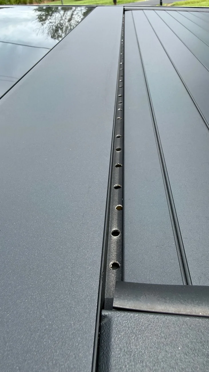

Can you elaborate on the slat fix. Mine leaks like crazy. Contacted Tesla OKC. Total blow off.
So from what understand, there is a slat that was removed in the “final product” to create a water channel. In some cases this “missing” slat can create space that is larger than intended and then it causes the opposite effect and allows water in.
The service center is supposed to measure the gap and if it’s out of spec, place a new slat and gasket I believe. I’ll link the service bulletin below.

Mine was VERY out of spec.
https://service.tesla.com/docs/Serv...over_for_Exposed_Water_Management_Channel.pdf
As many have posted the slat missing doesn't make it less waterproof. Many get the slat added and complain the water intrusion is just as bad. That's because the seal on the other side of that is what prevents water from coming in. I have a missing slat (most CTs were delivered like that) and my bed is waterproof.
