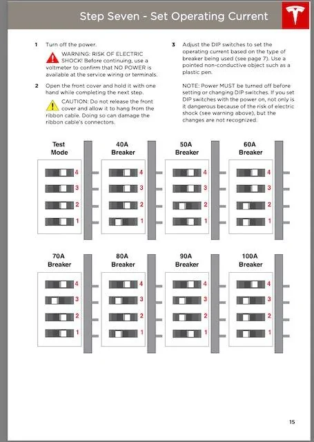

GOOD NEWS! Cyberbeast owner here. 6/30/2024 I am a Gen1 charger owner with a 100AMP circuit. I was able to DOWNGRADE my unit from 100AMP dip switches to the 70AMP 4/ON, 3/OFF, 2/ON, 1/ON setting. I flipped my breaker 3 times in a row and it reset the Gen1 charger. (per tesla instructions) I tried every dip switch setting. By downgrading to 70 AMP the Cybertruck was able to hand shake with my charger. Hope this helps. Charges now at 48 AMPs and did not need to downgrade settings. If 70 AMP does not work - try 80 AMPS. But important to power cycle the breaker 3 times before testing.
charging AMPs in App.
