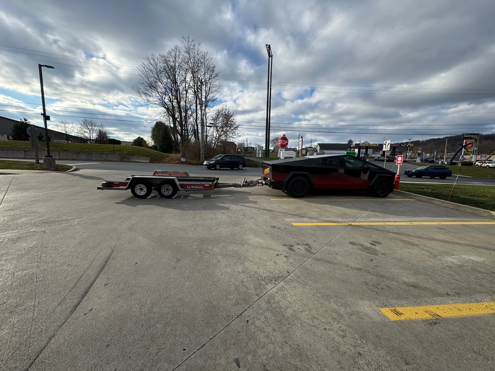

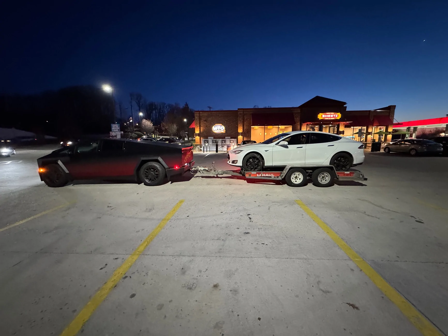

I towed with my FSCB from NY to PA and back. It was about 250 miles each way.
going to PA towed an empty car trailer, coming back had a 2014 S on it.
i was able just about 100 miles with or without the car each charge stop. Sorry I don’t have any graphs for W/M but at best I was 750, at worse I was just about 1000.
Here is what I looked it coming back with the car. Sorry If this isn’t exactly what you asked for, but it’s what I remembered.

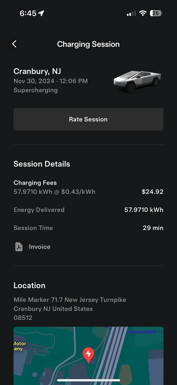

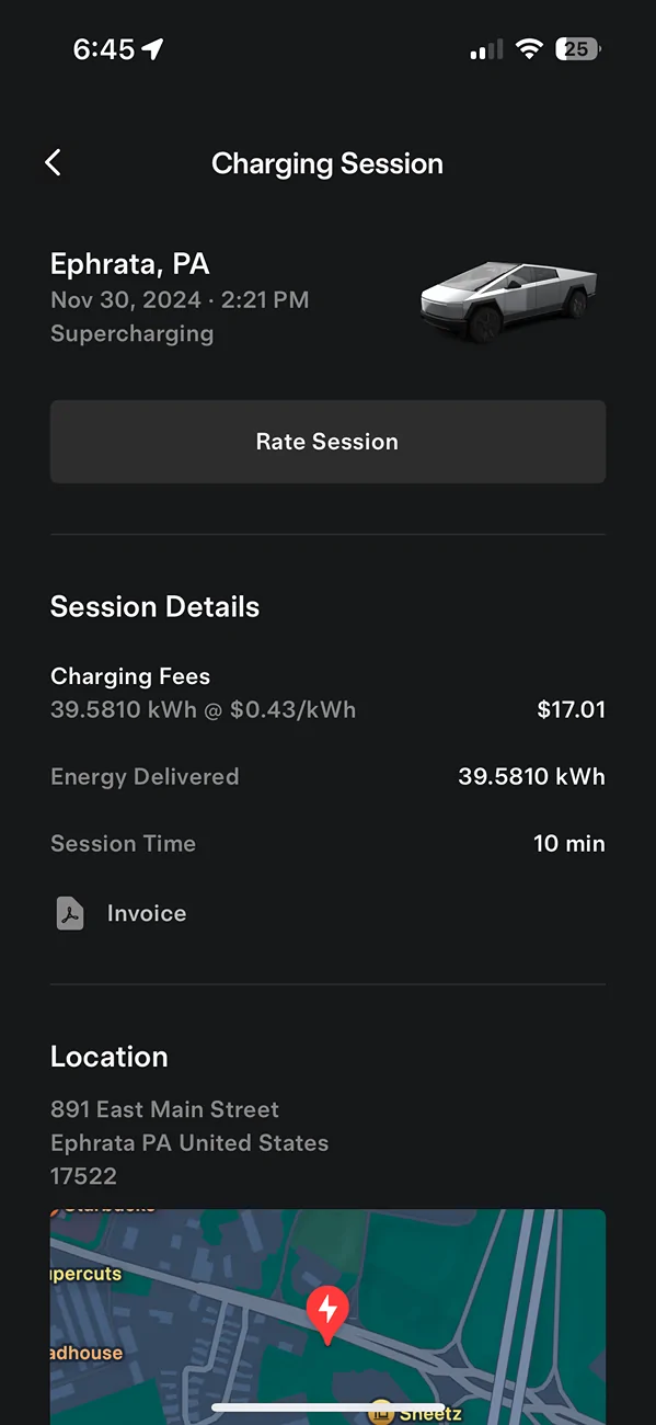

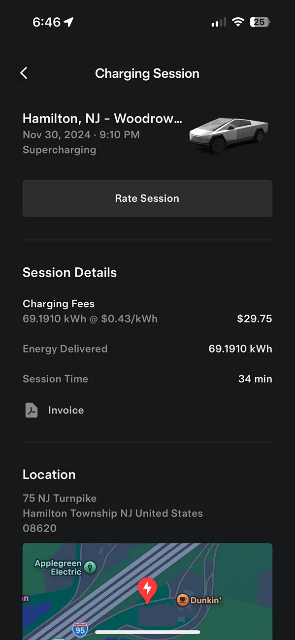

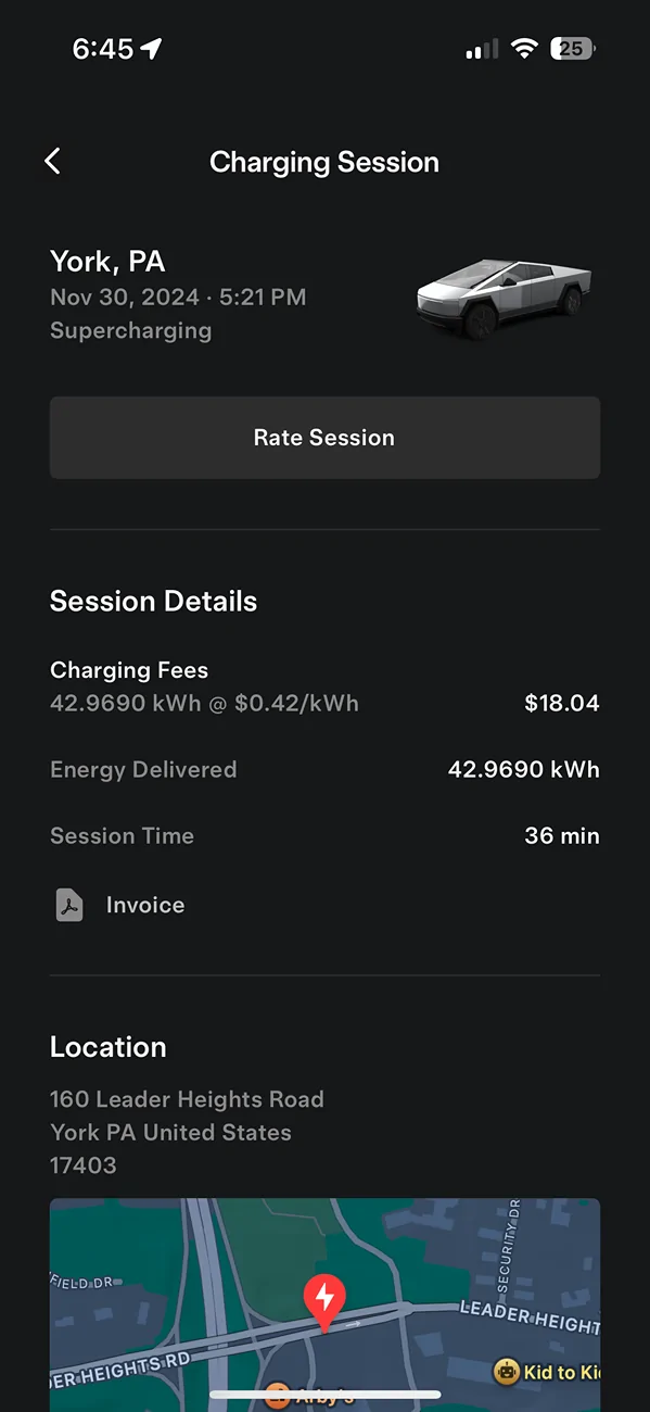

Here are the charging stops with energy used. Guess someone smarter then me can figure out distances so come up with W/M
