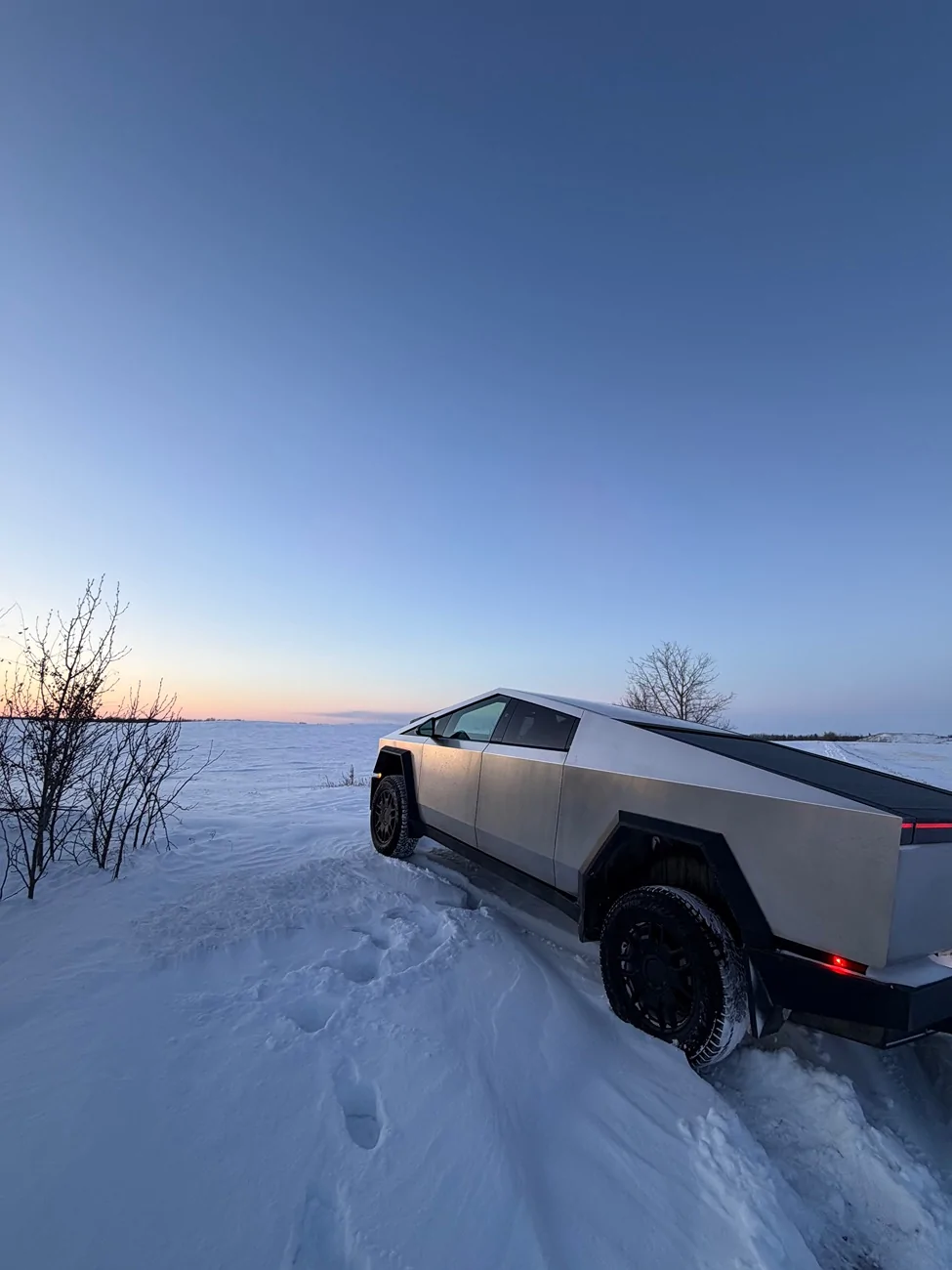

So much awesomeness. I’ve got Nokian Hakkas on it with no problems. I go in deep snow and have only gotten stuck once where I had to use recovery boards. I got stuck on a slope and the back end kept sliding down into trees 🤣

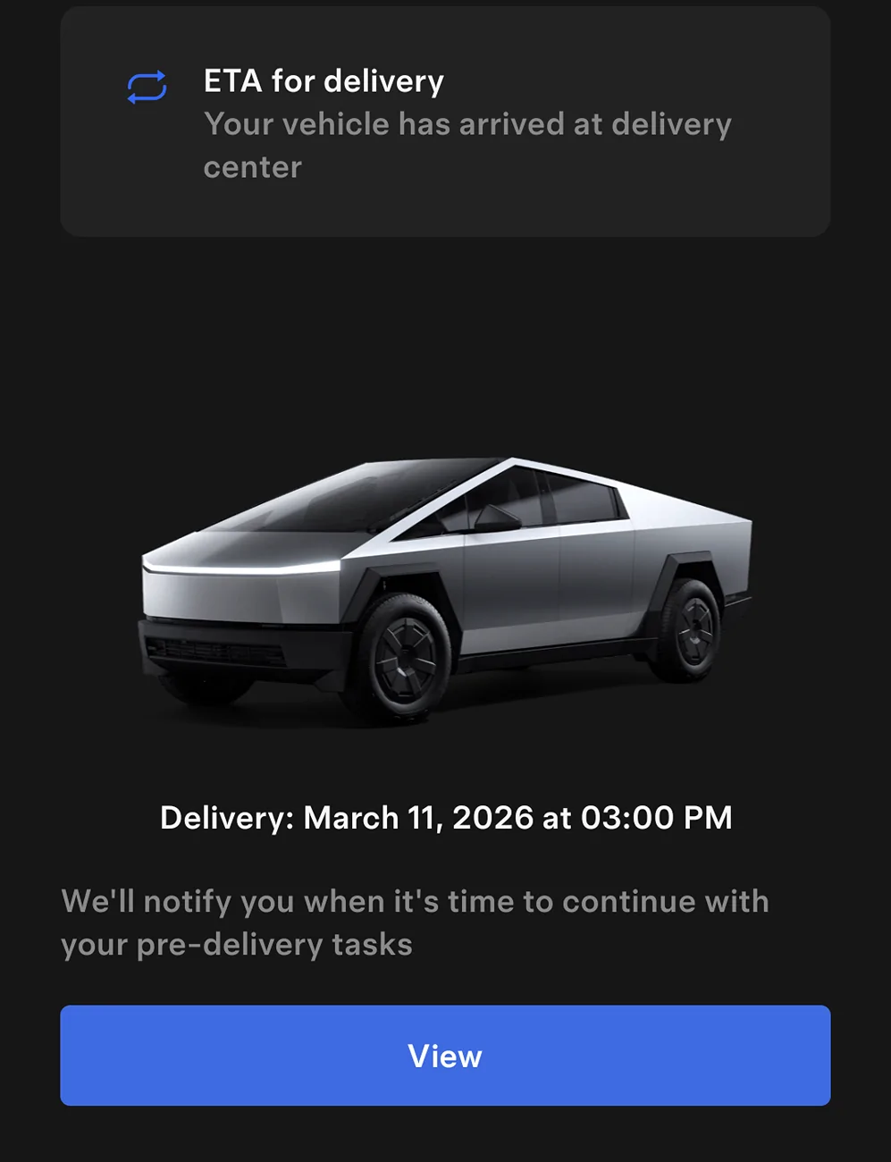

Going with the beast! I'll have some time to figure out a dedicated set of snow wheels & tires at least!
