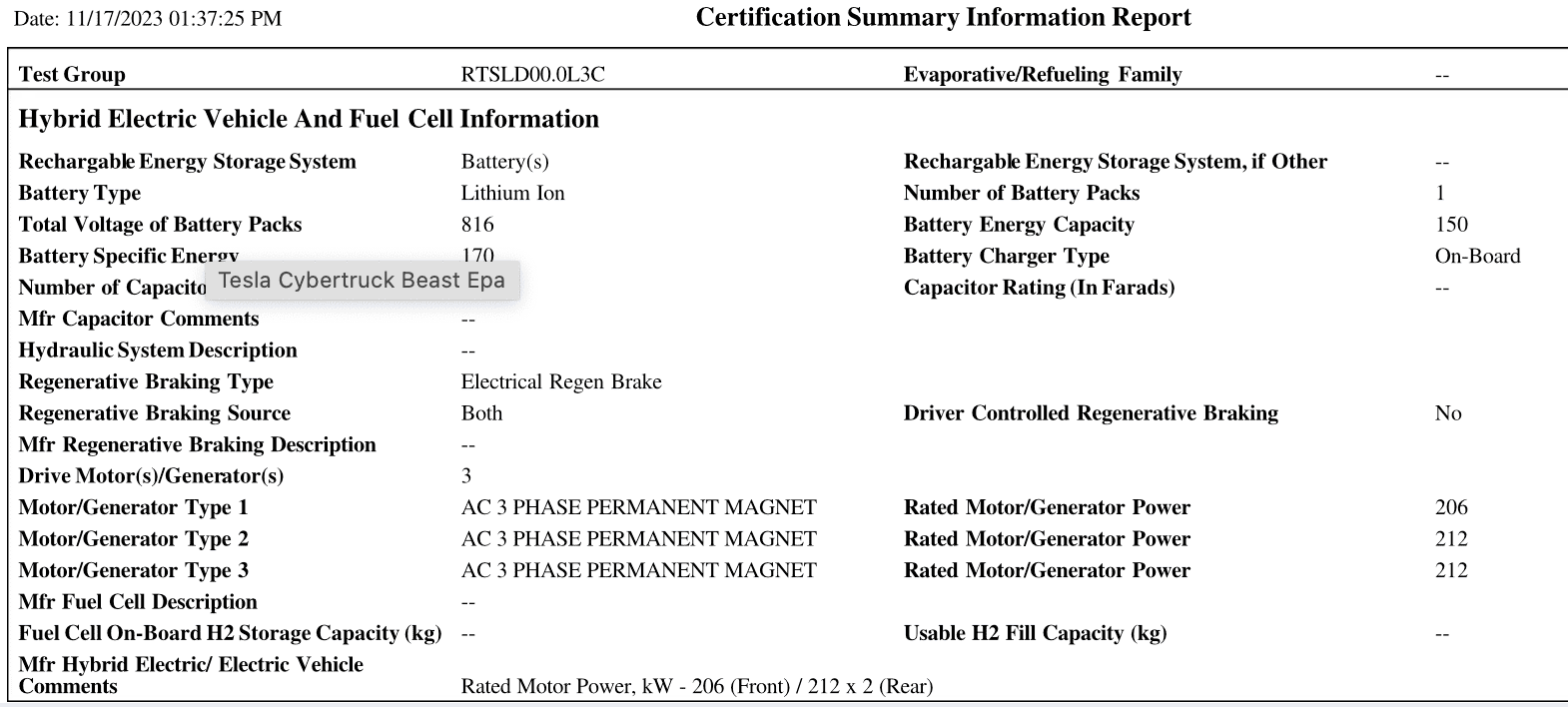

Interesting, from the EPA report, the three motors are permanent magnet not 1xperm & 2xinduction
Curious it also says the pack is 150kw..so does that mean they said 123kw of usable?
Maybe possible for a software unlock to allow for more range in AWD and Trim motor trim...around 50-65 additional miles is possible if 150kw is true.
its 150Ah not kWh
works out to 122.4kWh

1. No they are not CF wrapped, and are also not PM motors in the rear, rather they are induction but at a higher 800V than the Plaid, which means they are also a bit smaller lighter but similar power.
2. As far as we know the whole CT range including the AWD and CB are 800V and use the same pack and charging. The only meaningful difference is the extra rear motor, and that those two motor can do torque vectoring, which the AWD cannot at all. The AWD has a rear diff locker however, so just as good or better off road depending on terrain.
