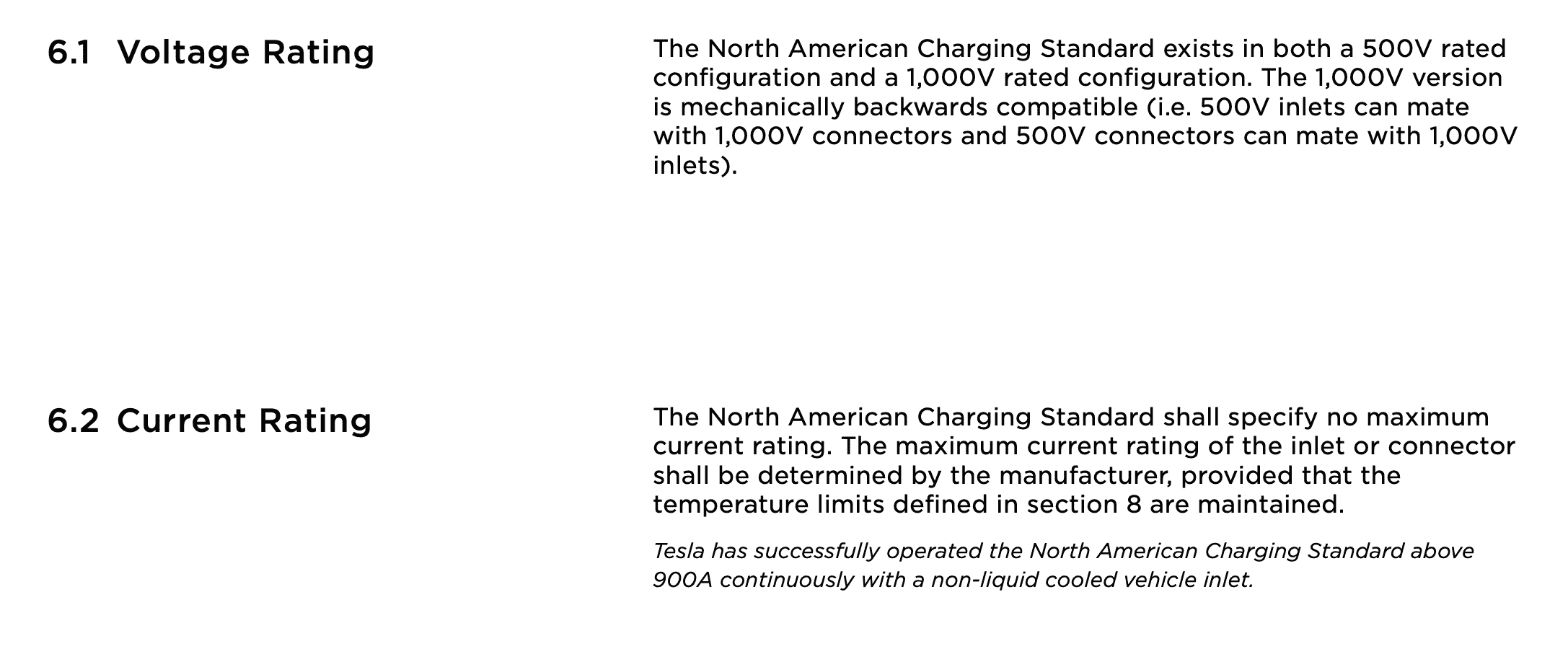

I think we have to look at charging curves to see actual charge times on a 1000v architecture.
Charge curves will be exactly the same. V3 charging curve is dependent on cell architecture, battery chemistry, and vehicle cooling system. The amount of "kW" that you can deliver to the car is also the same, with a higher voltage you require smaller wires and less cooling for the conductors. Same power.
If I plug in a 2200W heater to my 110V home outlet, I am drawing 20 Amps.
If I plug in a 2200W heater to my 220V outlet, I am drawing 10 Amps.
The 2200 Watt heater is still using the same power, the delivery of that power changes.
The current V3 NACS charging standard:
Tesla Cybertruck Cybertruck 1000V Architecture + V4 Supercharging Confirmed!! ⚡️ "It's Going to be Used for Cybertruck Too" - Elon Musk 1670197010098
500V * 900A = 450kW rating, today. V4 is probably capable of multi-MW delivery (not just 1MW) but we'll have to wait to see the technical docs :).

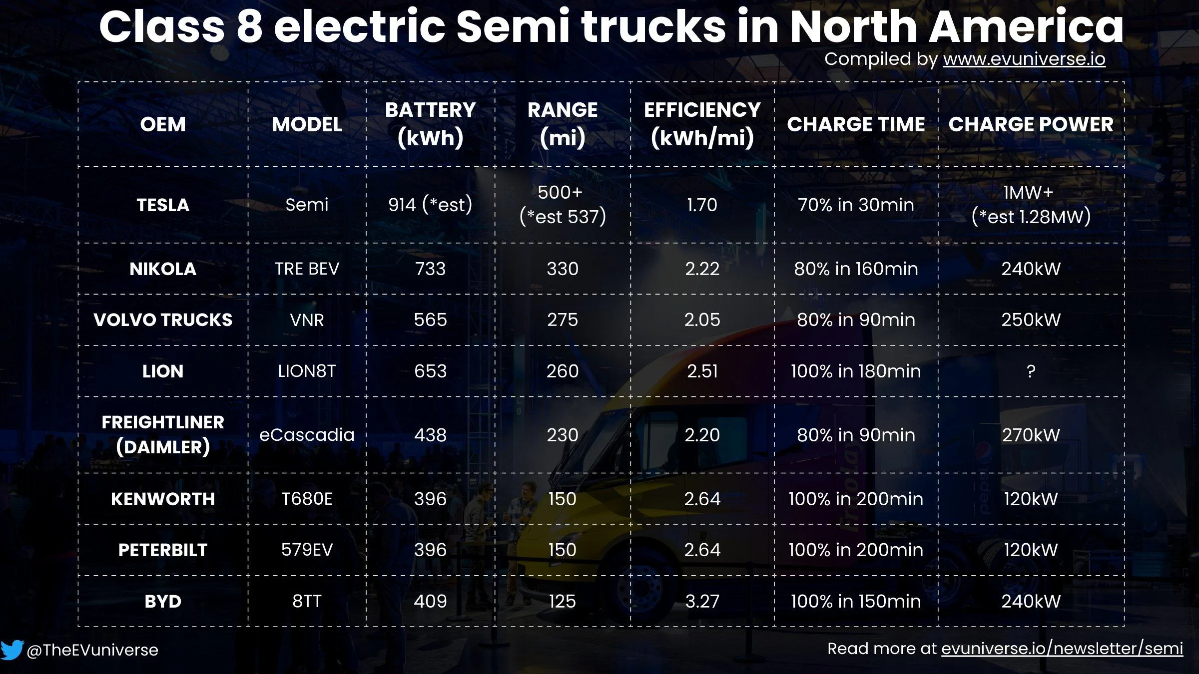

Maybe we should wait for the update before we assume the retail price of the CT.
The Semi is a good case in point. Vastly superior, yet if we apply the same logic to it as we do for the CT, it should retail for $400,000, not ~$200,000.
https://www.trucks.com/2022/03/29/volvo-wins-largest-order-for-electric-trucks/
"A Class 8 electric truck sells for $300,000 or more, depending on the vehicle and configuration."
This data may not be entirely accurate, but close enough.
Tesla Cybertruck Cybertruck 1000V Architecture + V4 Supercharging Confirmed!! ⚡️ "It's Going to be Used for Cybertruck Too" - Elon Musk 1670205030300
So Tesla’s Semi has blown everything apart, both in performance and price.
They have been NUKED.
CT will mirror.
