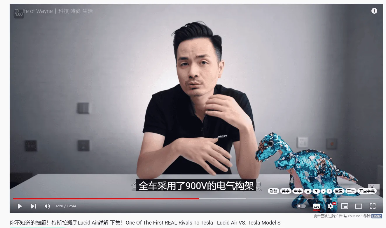

What does this mean? 800 vs 900?
It means 12.5% more volts.
Considering Musk has said the benefits of 800v versus 400v were fairly small, I have serious doubts the difference between 800 and 900 would be very big/ interesting.
This is mostly just confirming Cybertruck Will have higher voltage.
