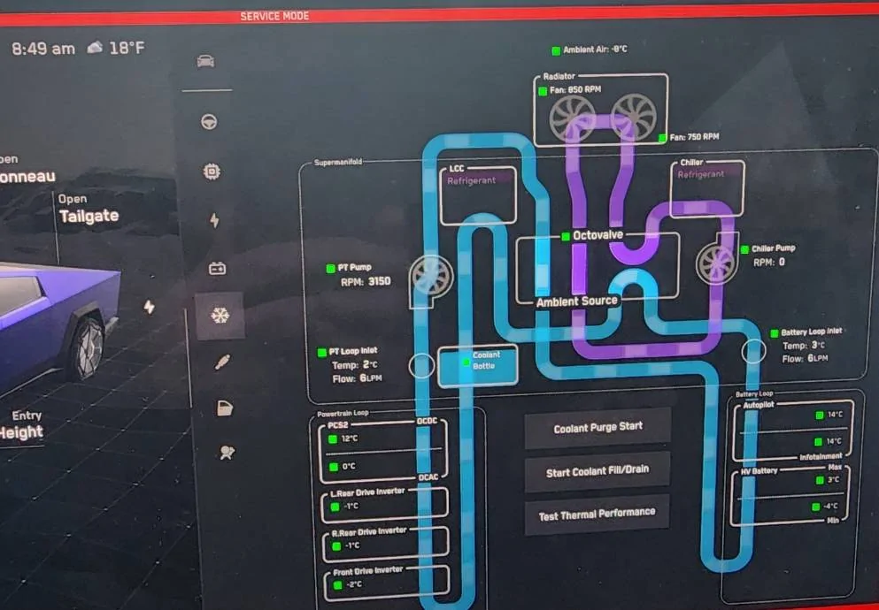

The battery uses the same fluid to heat it as the cabin climate control uses.
The cabin climate control on Cybertruck does not use coolant at all. All the heating/ cooling is done via refrigerant.
The compressor can pull heat from the coolant, but if the pack is cold, the octovalve will isolate the radiator to rewarm the coolant.
Ambient->chiller->compressor->LCC->pack
Also compressor->cabin condensers->air
Purple and blue are both coolant paths:
Tesla Cybertruck Cybertruck AWD cold-weather efficiency test in freezing temperatures SmartSelect_20250120_112646_Gallery
Thankks for the correction, it's an amazing system!
