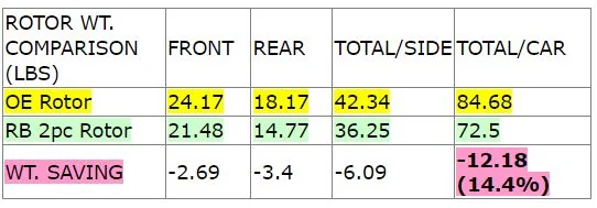

What's the weight of the stock rotors? Previously you showed the caliper weight savings, would be nice to know the rotor weight savings as well along with the combined weight savings if you go with both caliper and rotor.
Tesla Cybertruck Cybertruck Brake Upgrade Options from RB Performance Brakes wt compare1
Additional advantages of a 2 pc rotors more than just the weight saving:
  • Rotor are directional (curved vanes) so they are more efficient in heat dissipation that you can run the rotor cooler, reduce the wear and replacement of brake components - Extending the brake life and save downtime and money in pads/rotors replacement.
  • Once the 2 pcs rotors are in place, when rotors wear out you only need to replace the rotor rings
  • Really "cool" in look and braking...

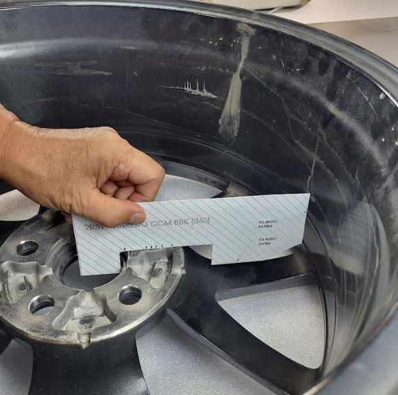

Since they appear more beefier than OEM, will an 18” Wheel clear the Calipers?
If you retain OE calipers there is no change in outer dimension in fitment as only the rotors are swapped so whatever the stock setup is what it will fit.
But if you are considering the stock size 350mm RB caliper kit we can confirm it can clear 18" wheels w/o any issue.
In fact an Model 3 enthusiast brought his 18" stock wheel this morning for us to confirm the ccb brake kit he is ordering (w/360mm rotor). This pic shows about 6-8mm barrel clearance, being Cybertruck stock rotor is only 350mm we expect to have even more clearance ~(1/2" or 10-12mm)
Tesla Cybertruck Cybertruck Brake Upgrade Options from RB Performance Brakes clearance check-18in.JPG

Yes we can confirm the stock size 350mm RB caliper kit can clear 18" wheels w/o any issue.
In fact we have an Model 3 enthusiast brought his 18" stock wheel this morning for us to confirm the ccb brake kit he is ordering (w/360mm rotor) This pic showing still has about 6-8mm barrel clearance, so being Cybertruck stock is only 350mm we expect to have 10-12mm clearance.

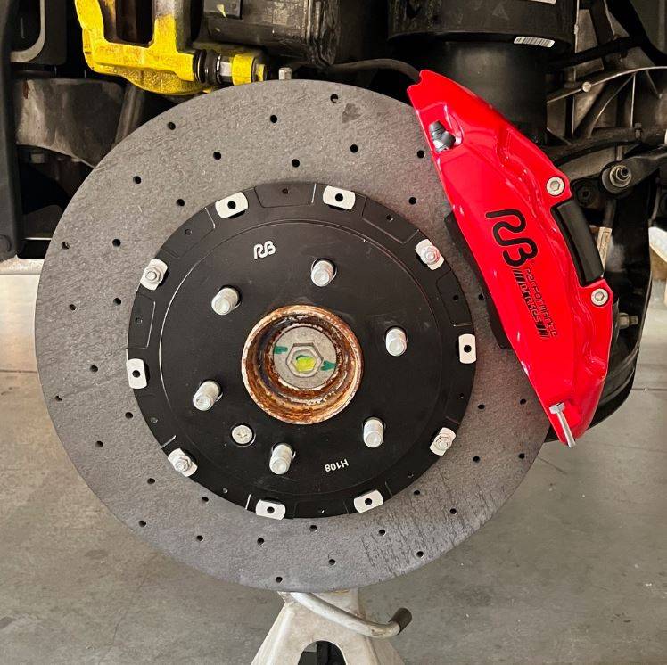

410mm rotor/6 pot caliper BBK fitment test under OE 20" wheel.

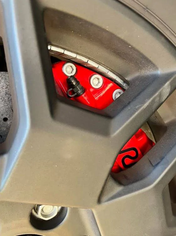

390mm rotor/4 pot caliper BBK fitment test under OE 20" wheel.

Fitment tests on Cybertruck (11/18/24)
FRONT CCB BBK (410X36MM) - 6 pot Caliper replacing OE 4 pot.
Tesla Cybertruck Cybertruck Brake Upgrade Options from RB Performance Brakes front1
Tesla Cybertruck Cybertruck Brake Upgrade Options from RB Performance Brakes front1.JPG
Can clear wheel balancer.
Tesla Cybertruck Cybertruck Brake Upgrade Options from RB Performance Brakes front3_clear wt balancer

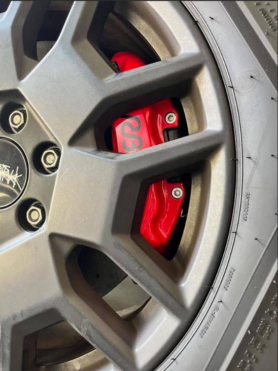

REAR CCB BBK (400X28MM)
Tesla Cybertruck Cybertruck Brake Upgrade Options from RB Performance Brakes rear3.JPG
RB 4 pot fixed piston w/integrated ePB (Replacing OE 1 pot floating caliper)
Tesla Cybertruck Cybertruck Brake Upgrade Options from RB Performance Brakes rear1
Inserting OE parking brake cable to RB 4 pot caliper/actuator.
Tesla Cybertruck Cybertruck Brake Upgrade Options from RB Performance Brakes IMG_6440
Tesla Cybertruck Cybertruck Brake Upgrade Options from RB Performance Brakes rear5.JPG
Tesla Cybertruck Cybertruck Brake Upgrade Options from RB Performance Brakes rear4.JPG
