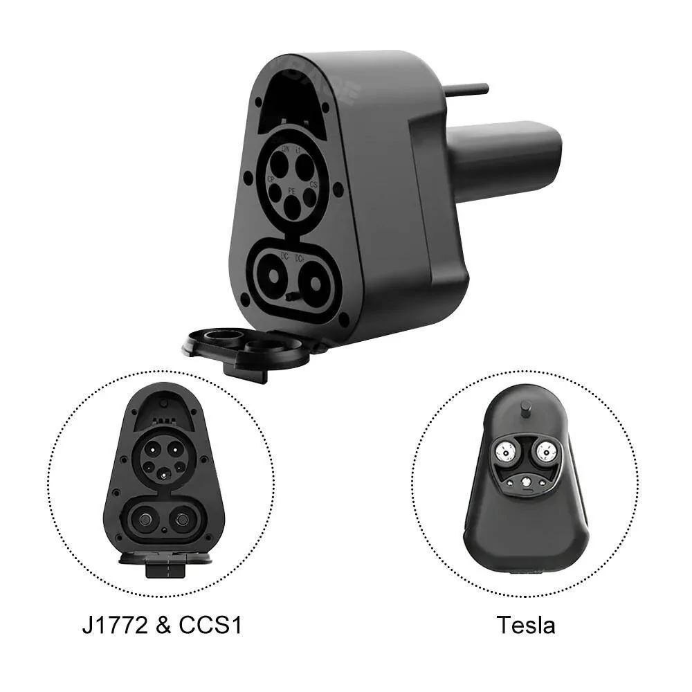

I have the A2ZEV version for the Cybertruck. Biggest challenge is the fit of the CCS charging cable plug into the CCS Adapter. Electrify America and Fords Blue Oval network fit fine, ChargePoint, Circle K and EVCS do not fit

Well heck, that's a show stopper right there. I guess the standard is not a standard after all.

Sadly this wont help our EV community grow, it needs to be simple plug & play universally for ALL chargers just like Apple or usb.. Until then we cant be taken seriously

I contacted them today. They said they had issues with the last batch and modified the design slightly to fix this issue. They're telling me the new stock should be fine. Sure hope so, because I ordered one!
