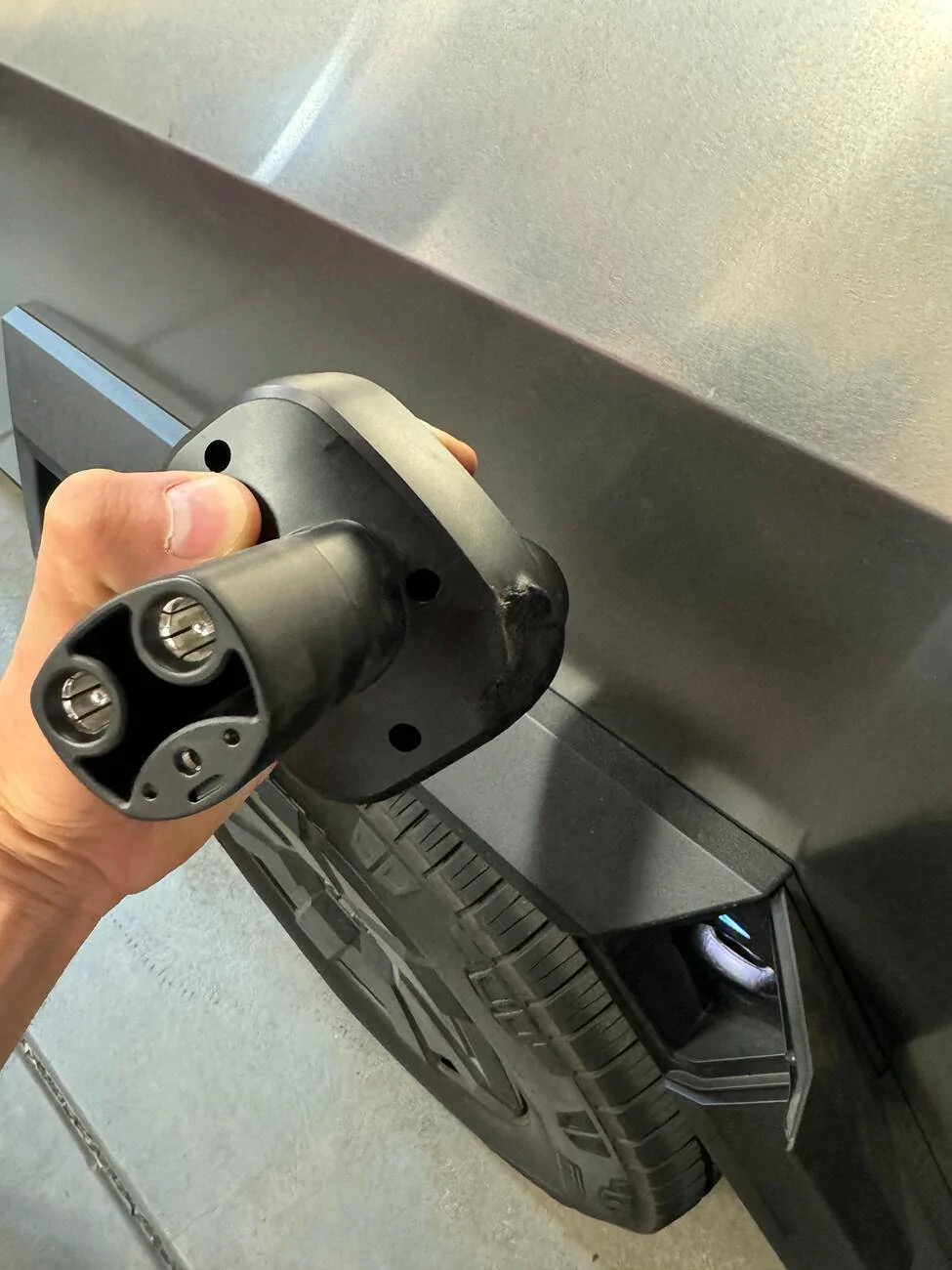

I got my A2Z adapter last week and went to try it out today and strangely couldn't figure out exactly how to use it. It didn't seem to fit all the way in the Cybertruck charge port and I was unsure if you are to connect the charger handle to the adapter then plug it in or plug it in first. Anyway, I didn't want to screw up and get something stuck so I figured that I would just review some videos and try it again another day. I can't seem to find any videos of anyone using this adapter yet and it did not come with any documentation. Anyone have any feedback or instructions after using it yet?

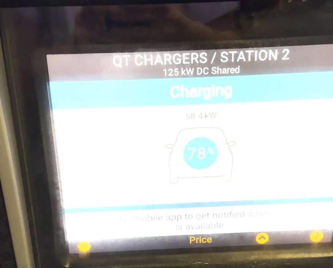

Today I tested my new A2Z Cybertruck adapter. It worked great. I was at 33% SOC and got 246 kW from a 350 kW electrify America charger. Bottom line to answer your question. Plug the adapter onto the CCS1 connector connected to the charger. Follow directions on the charger and plug A2Z firmly and snuggly into charge port on car when directed. With the various CCS1 chargers out there, all with nearly worthless directions and no consistency, I think the technical term is, farkle with it until it works, and load apps as needed.

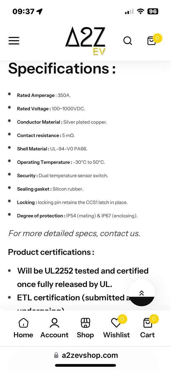

A2Z Cybertruck CCS1 to NACS is only for DC charging and can not be used for J1772 AC charging do has no lower cover. Specs are as fillows

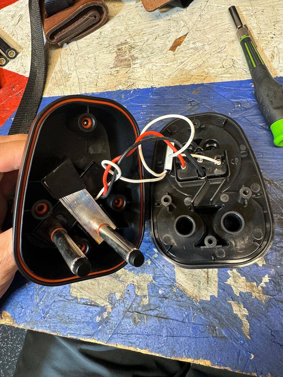

Yep. I spoke to them and everyone uses their design. They license it to other companies like Teslaunch. The only difference is those companies wanted the AC charging and had to sign a waiver that it may have problems. A2Z said they are DC only to obtain UL2252 certification. They also said the internals look different. You will also notice the little button on DC is sheared off and there is no door. The L1 and L2 AC pins are also capped off.
