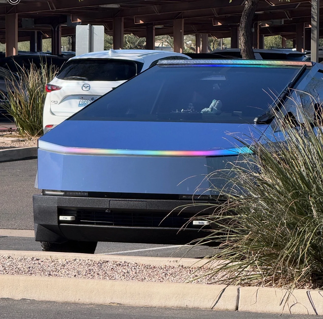

I’ve never checked, but would 8% be too bright for DRLs? what I would really love is a film to defuse the light, so it looks more like the actual DRL.
116
8,504
9,793
I use this film from vivid but there is a darker version and if color just isn’t your thing there are many many option.
https://a.co/d/d6nT0v0
They are cheap and take about two minutes to do on that long straight strip so it can’t hurt to experiment.
they also just peel right off leaving nothing behind

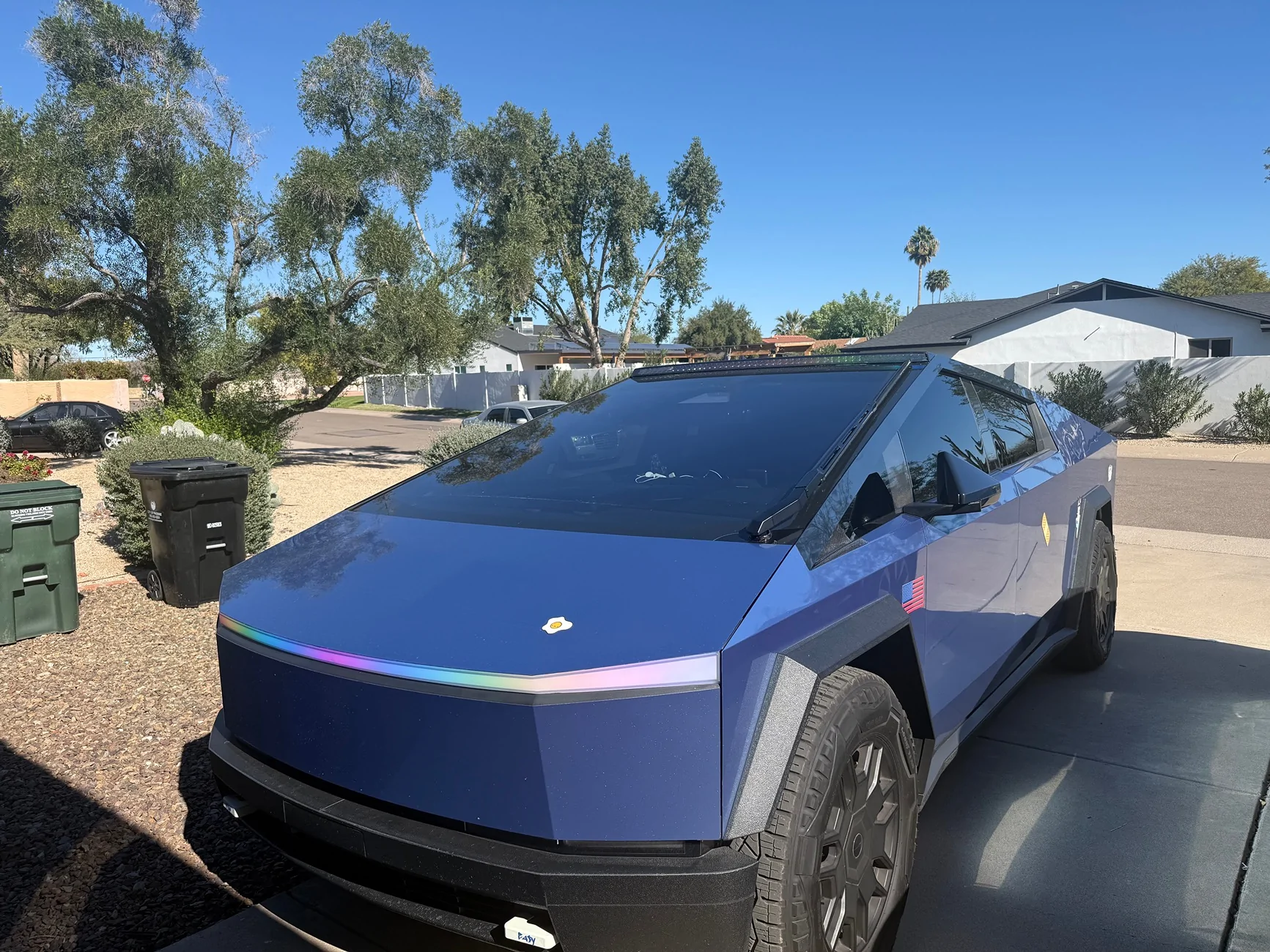

All that said, they bar is high quality and is plug and play.
I watched the video install, and you have to splice Into the wires. Are these dedicated auxiliary wires? Most of these add-ons I’ve done with jeeps you’ve used a t-tap.
SlegMD
Apr 24, 2023
1,648
3,033
Lexus
Medical
Yes, light bar is 48v as well. Activates via screen [Outlet&Mods/PowerFeedFrunk]
MCraft99
Feb 20, 2026
214
205
FS CB 8/24
Any clue how much power the stock lightbar draws? I should be able to tap into the 400W for the roof as well as the frunk power's 400w for 800W total?
