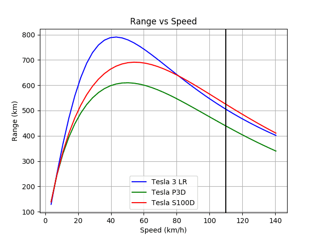

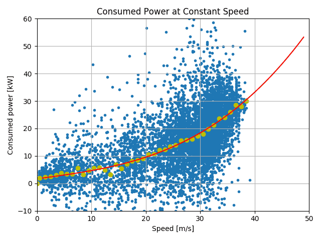

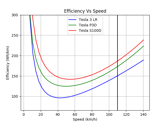

Below are charts of efficiency vs. speed for Model 3 and S. Obviously the CT will be less efficient overall, but I'd bet the curve will be the same shape.
6mph is really slow and really inefficient. I'd expect the range at 10km/h to be about 1/2 the EPA range. Note that this assumes constant speed, no stopping/accelerating which will further reduce efficiency.
https://forum.abetterrouteplanner.c...-consumption-real-driving-data-from-233-cars/
Tesla Cybertruck Cybertruck Energy Consumption at Slow Speeds 1624490994763
Tesla Cybertruck Cybertruck Energy Consumption at Slow Speeds 1624491303246
Funny, I was just using this graph today to estimate ideal speed when travelling long distances supported only by AC charging. Interestingly, for the scenarios that I was testing for my M3P, 500-1000km/day it is better to drive faster and charge longer (at 70km/h 11kW rate) than to mind your speed and drive longer.
I suspect that the CT will be very similar, although I am hoping for a 22kW onboard charger for that one. Australia has very large areas poorly served by DC fast chargers, but AC power is everywhere, even if it is with a diesel generator at times.

Interesting graphs which make sense seeing the non-drive parasitic loads with rolling resistance versus drivetrain loads only reach equilibrium at 40kmh, where aero is still insignificant.
But at lower speeds like 6mph (10kmh) there is are not many data points in those graphs so I'd be wary of making to many assumptions. What would be interesting to see in comparison is parasitic loads in a stationary vehicle in the same temperature conditions to plot against a speed/range graph. So actually harder to estimate than it looks like for such low speeds.
In a ideal world without parasitic loads the range would be infinite with a solar vault cover, (you can push a CT along by hand after all - like most cars) But it's unlikely the parasitic loads can be reduced that far. Does anyone know how much the self discharge is of a parked Tesla? And then one with "ignition on" but not in drive?
