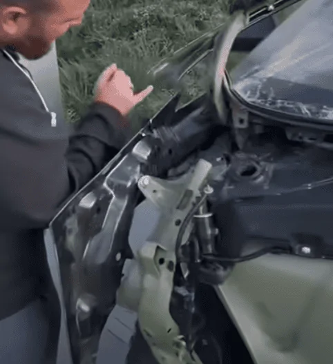

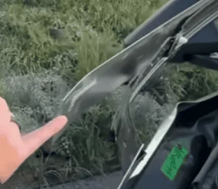

ugh, fine:
Bonus VHB Tape being used:
Thanks. That's the front fender which does nothing, and not the rear SS fender. But if the rear is the same, that backing won't transfer much load the way it came apart. In fact I'd say it's like that to avoid warping from the aluminium cast thermal expansion underneath.

I'm actually surprised how much steel backing is on that front SS fender. Probably had to keep it thin for crash worthiness?
