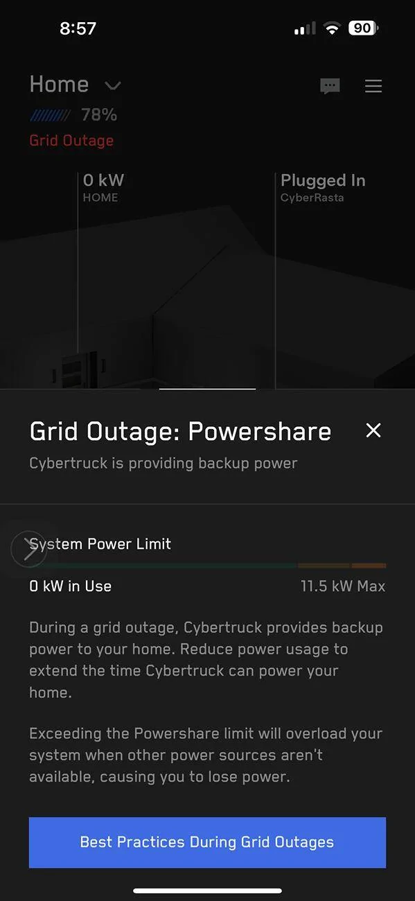

My screen looks just like yours. I had an electrician come out and look at it, they said the wire that was used from the panel to the charger was a 6 gauge instead of a 4 gauge, and that the PowerShare unit appeared to have a fault inside. At this point I am done. Told they to come and take it.

There are 2 reasons why I did not have them try to fix it again:
1. It was near impossible to get someone to the house to resolve the issue while under warrantee. Imagine how hard it would be post warrantee?
2. When the PowerShare went down, it took down current for all the critical electronics (Fridge/ AC / etc.). This occurred at random, sometimes multiple times/day. Sometimes I could not get it back up, and when I finally get a Technition in he had to adjust a switch in the PowerShare itself to get us power. It was quickly disrupting my household and ability to be productive. It had to go.

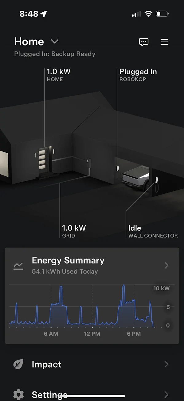

I also have no recent data available. Reaching Tesla for support is a nightmare. After waiting on the phone for an hour, they accidentally disconnected me, then didn't call me back. I called the next day, and got someone after an hour wait. They ran some tests on their end, and said it was an electrical wiring issue. Funny that it worked fine from February to August (see photo below). They said it should be under warranty, and to contact the installer.
So I did - they came out - the installer switched off my home power, switched it back on - said it wasn't a wiring issue, and a week later sent me a bill for $230, half of which was an out of service area charge! I refused to pay since it's under warranty and they are bringing it up with QMerit.
I contacted Tesla again, and they said they would escalate it and to watch my app for a message from Tesla tech support to schedule a visit. That never happened.
So I called them again - waited again - they escalated it again. Still nothing.

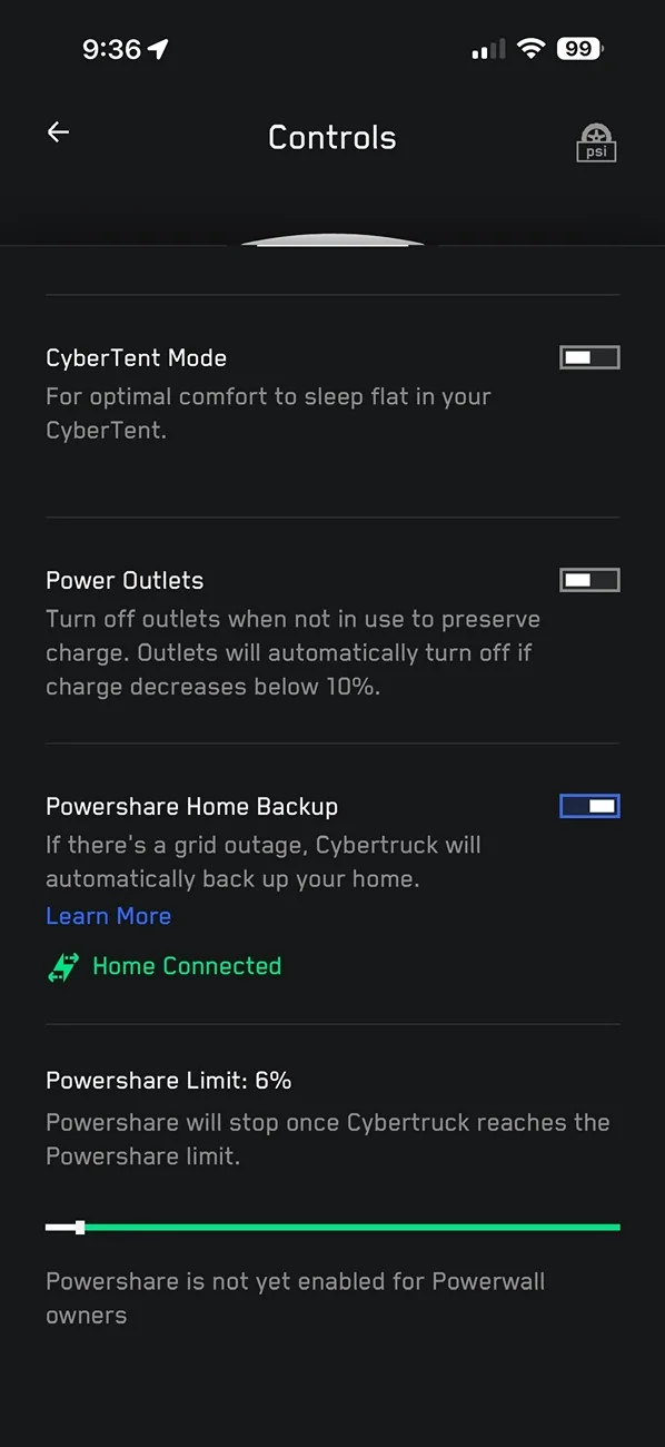

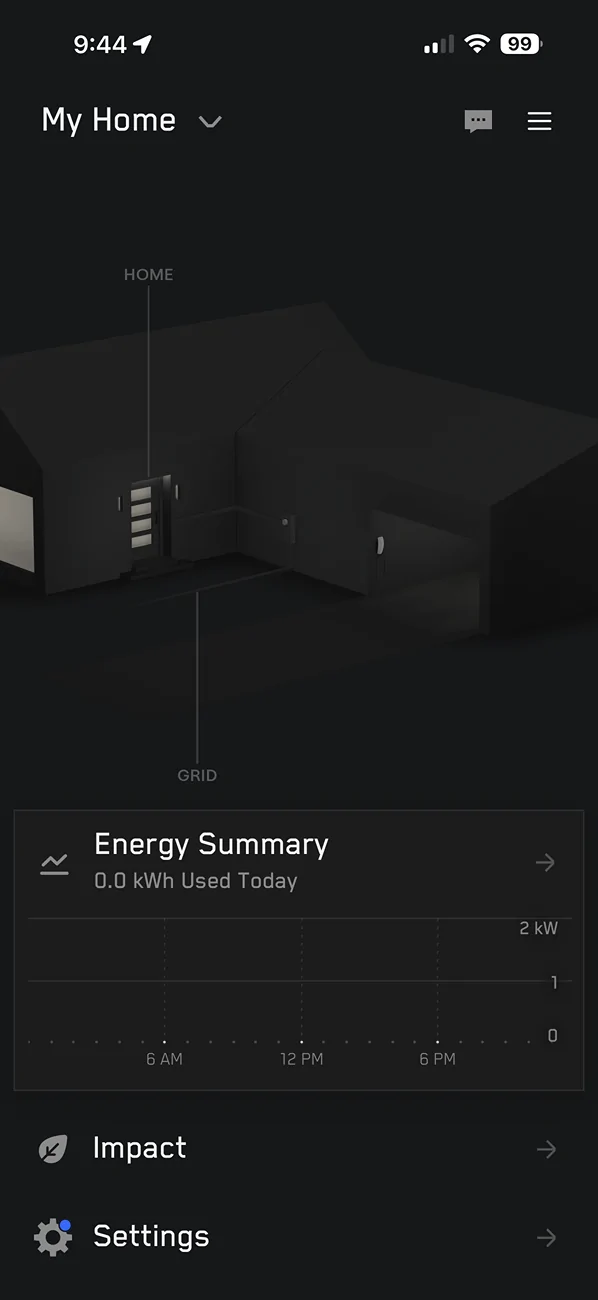

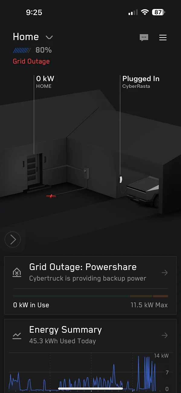

The customer support is really lacking. Not impressed with Tesla. On the bright side, it does show that Powershare is connected to my home in case the power goes out, I just can't connect my phone to the Powershare wall unit no matter what I try. I don't get any grid info at all (since August):

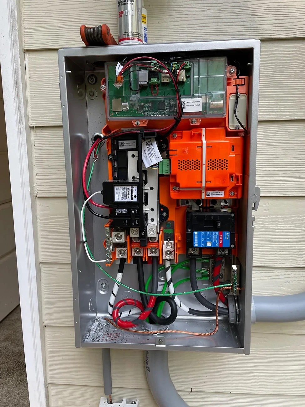

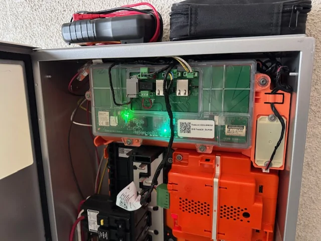

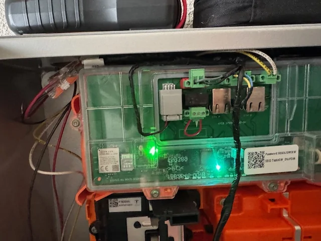

I wanted to follow up on my earlier post about my Powershare gateway suddenly going offline—no grid data in the app for months (it had been working flawlessly from my February install through July).
I couldn't connect my phone to it, no QR code, and Tesla's diagnostics kept pointing to an RS-485/communication wiring fault. Support was a nightmare—lots of runaround between Tesla, Qmerit, and my installer.
After escalating directly to Qmerit (CC'ing the installer and Tesla), my electrician came back out on December 12, and we finally nailed it down.
What we saw on the gateway:
  • Flashing orange light on the contactor (that lower middle square).
  • WiFi/comms light off or red—no connection possible.
He checked every external connection and field wiring—everything was perfect.
Then the breakthrough: When the internal dead front cover is screwed on, its top lip presses right against the factory wiring harness (which is routed "up and around" the panelboard exactly as the install manual says, using the tabs and avoiding any crossing). That pressure causes the comms to drop—the orange light starts flashing, WiFi light goes out, and the whole system goes offline again. But as soon as you loosen the cover, jiggle the harness a bit, or leave the dead front off/loose... everything lights up properly (green → blue/white for WiFi), the QR code becomes scannable, I reconnect my phone, and full grid data and functionality come right back.
The system is running perfectly now—but only because the dead front isn't fully installed (it's sitting loose for clearance, which obviously isn't a safe long-term setup). The electrician took video of the whole thing, saw no visible damage to the harness, and requested a replacement from Tesla/Qmerit just in case. In addition, suddenly all of my grid data from September through December is showing up in the Tesla app. I'm only missing August data.
This really feels like a design clearance issue in the Gateway enclosure—the required routing path puts the harness right where the cover lip can pinch it. If anyone else is dealing with the "gateway offline / no grid data" problem plus a flashing orange contactor light, definitely have your installer check for this internal cover interference first. It could save you weeks of frustration.
Hoping Tesla approves the new harness quickly and maybe comes up with a permanent fix (spacer? revised cover?) before my warranty runs out in February.
Has anyone else run into this exact behavior? Thanks for all the earlier advice in the thread—persistence paid off!

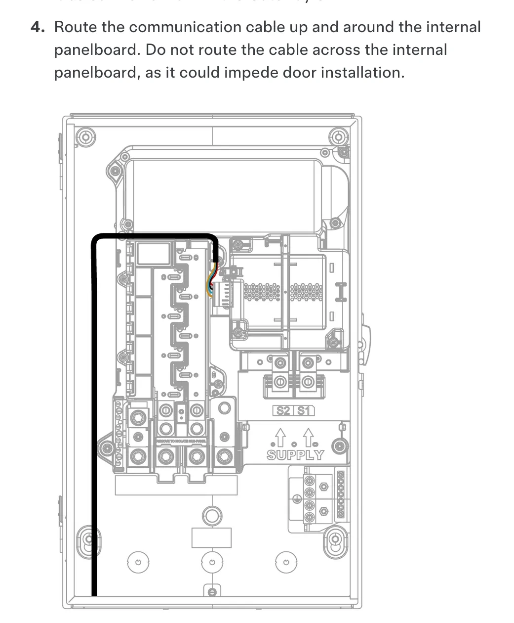

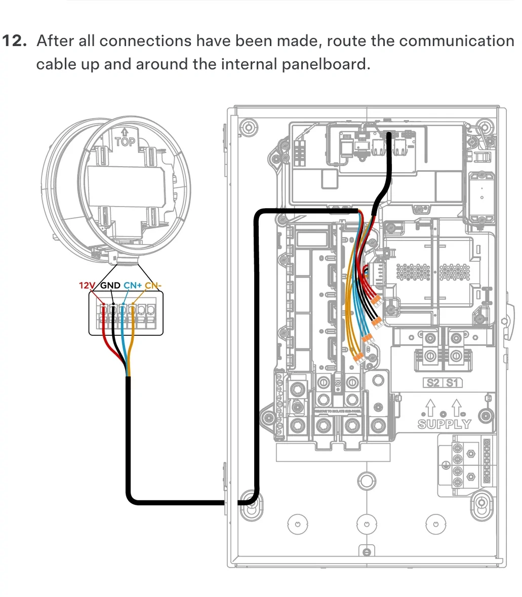

Apologies in advance if I am misunderstanding.
If the top of the dead front is pinching, it sounds like the cables are being routed up and around the entire Gateway (panelboard), not the "internal panel board". Unless its the pre-wired cabling that is getting pinched. The top groove isn't a wiring channel.
Installation steps:

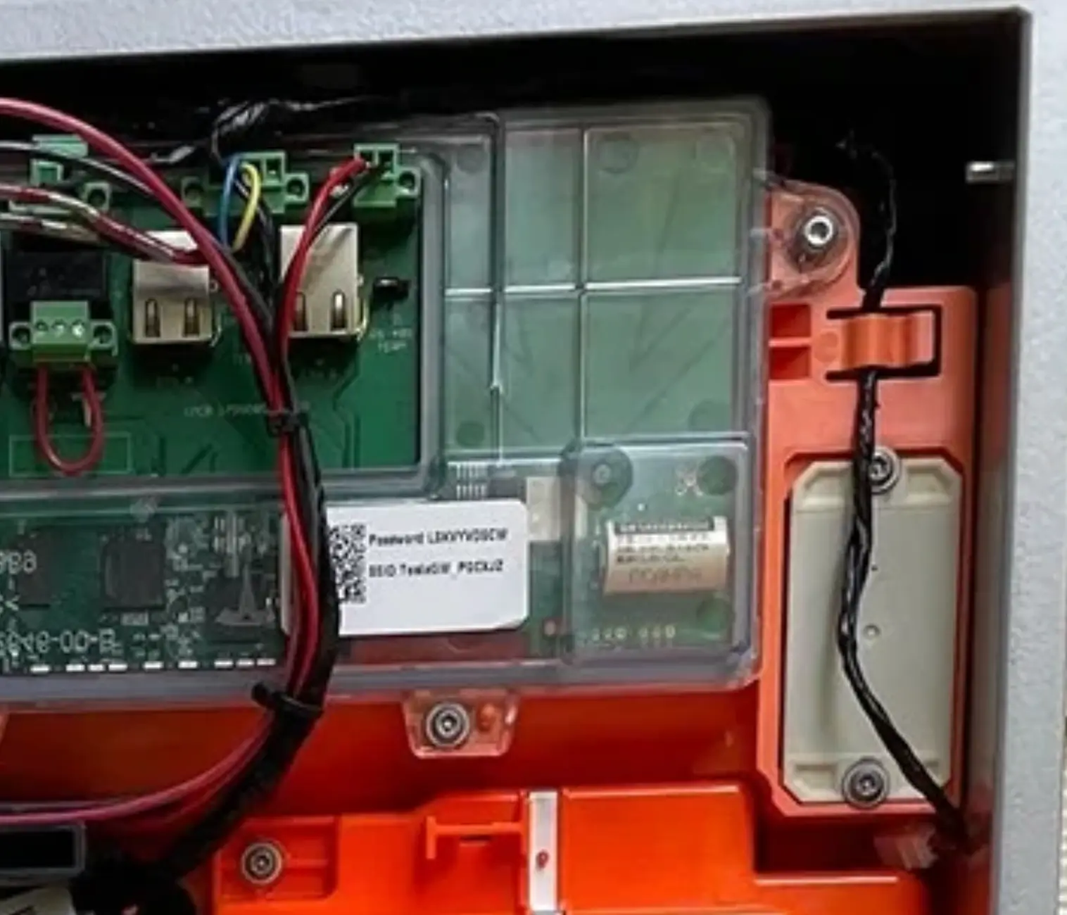

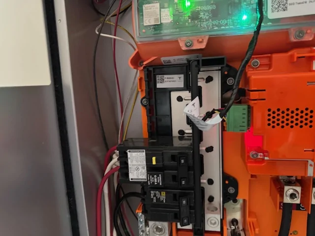

The black taped wire that runs through the orange clip at the far right, and goes up top in the gap is the harness with the issue:
Tesla Cybertruck Cybertruck Gateway Universal Charger Powershare Issue 1765630929660-ik
May 27, 2024
4,524
5,505
Weird, based on the side hinge pin location, it seems like fully closing it would give more room (unless the door sloted in behind the harness). The harness looks undamaged but squished? I would have expected the problem to be at the connectors.
Note to others: that image was a zoom of the photo I posted, not the problem system.
sys700
Rod
Jul 19, 2020
367
627
Portage, MI
Foundation Series Cyberbeast (August 2024 - 26###)
This is not my panel. It's from your images. The dead panel (not the front door, the inner dead panel) actually has a lip that can pinch the harness. Poor design.
Here's a video of the electrician testing it out...

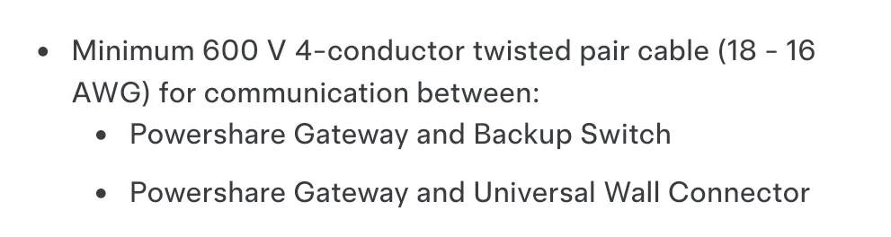

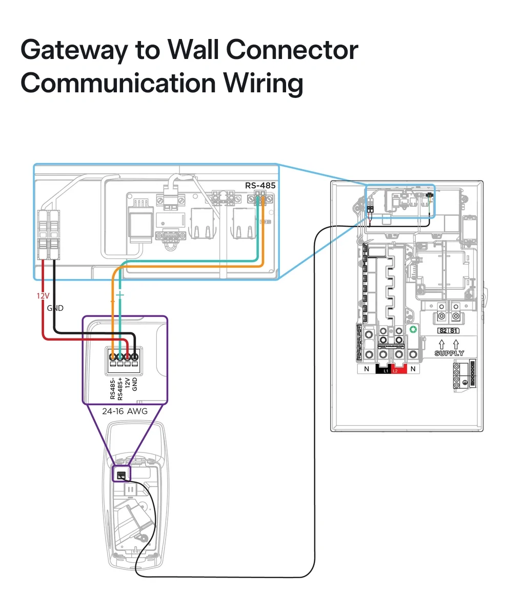

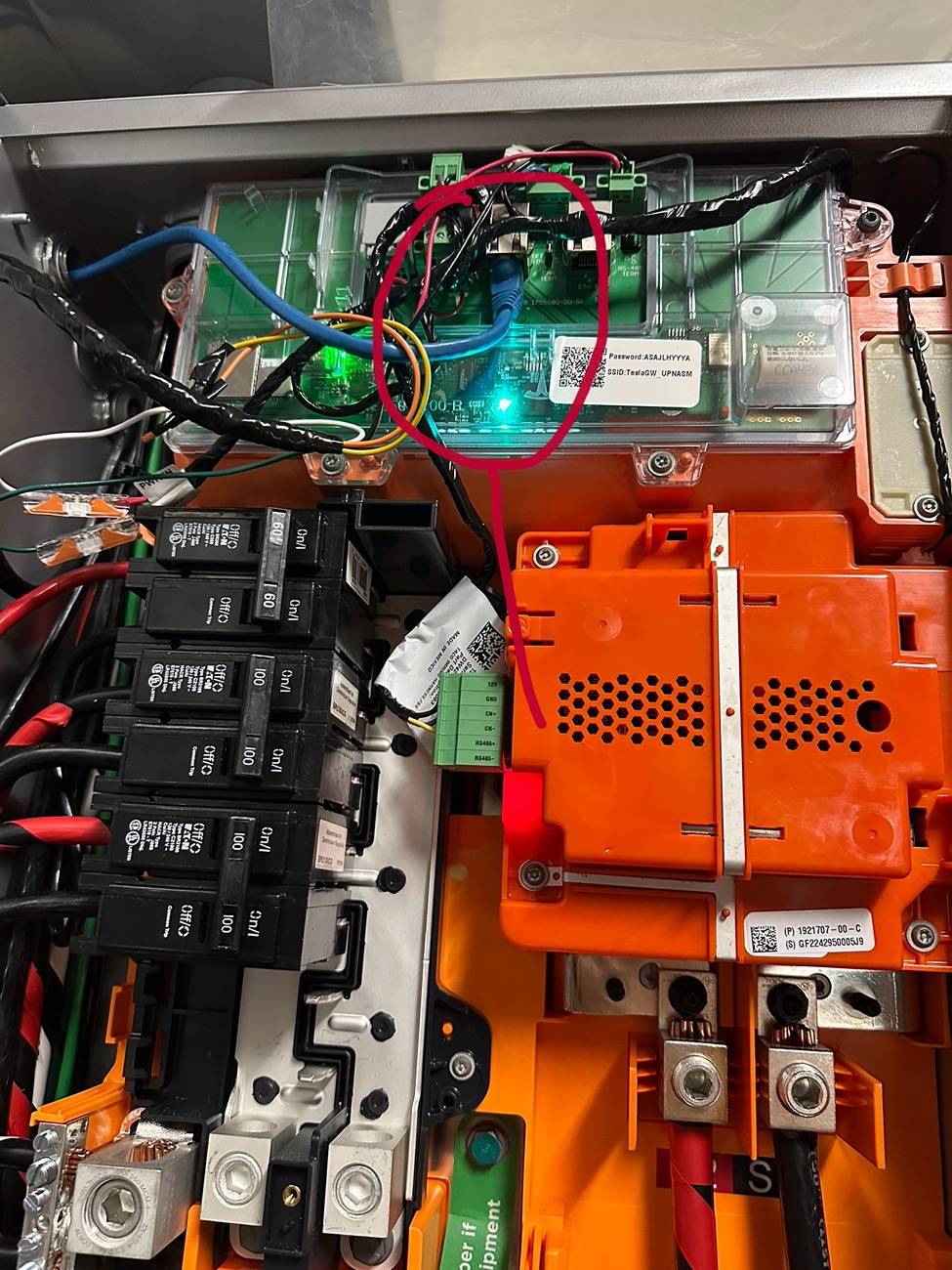

Yep, sure looks like power is dropping out to the TACO. I'd still lean toward a bad connection from the UWC versus a short circuit, but either is possible. It did seem like the dropouts only occurred when the upper left portion of tte harness moved, but it's hard to tell from the video.
How long is the run to the UWC? That doesn't look like the correct communication cable (not that I expect it's the issue). The photos (if these are your setup) also show the wires tucked above the TACO rather than running down and then sideways.
