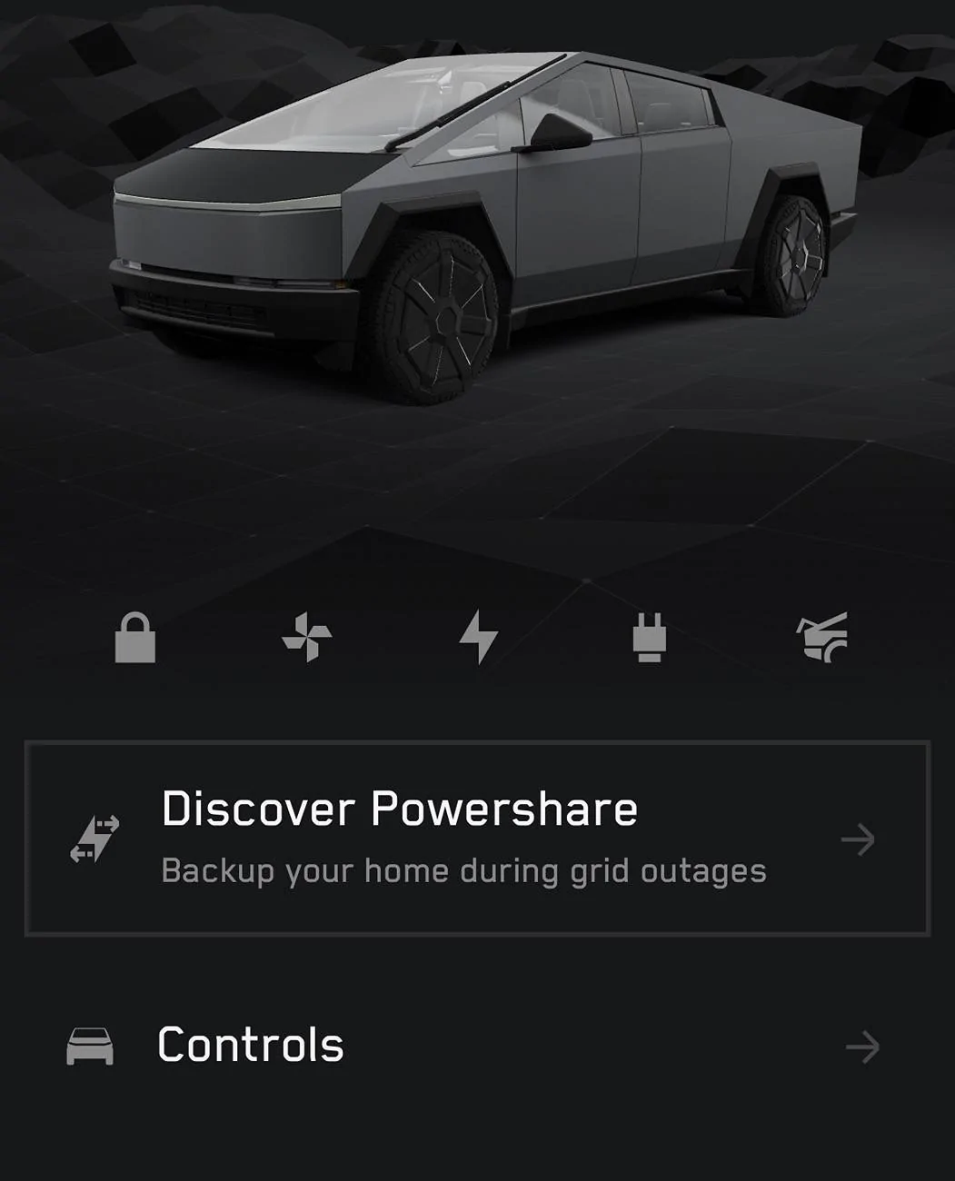

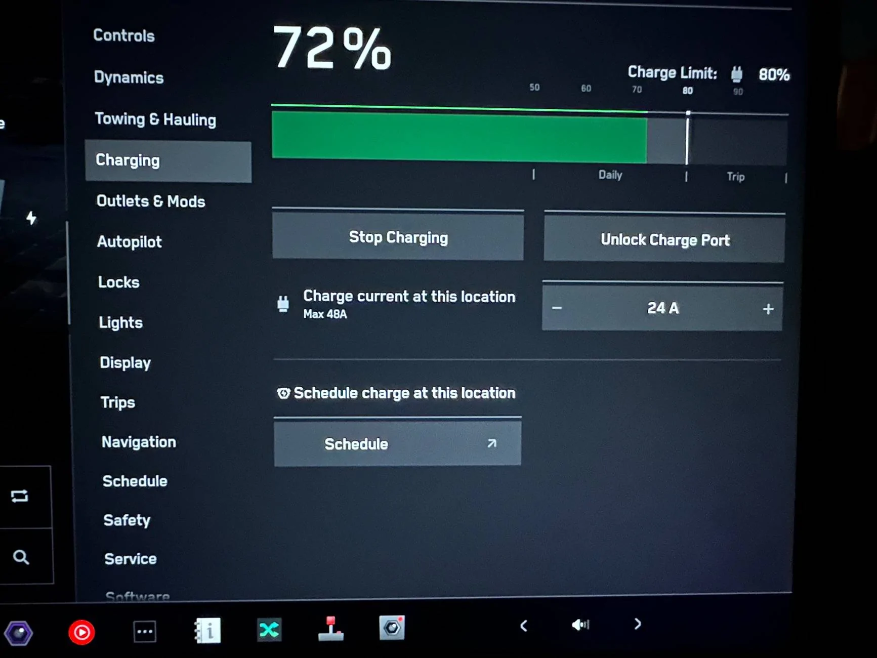

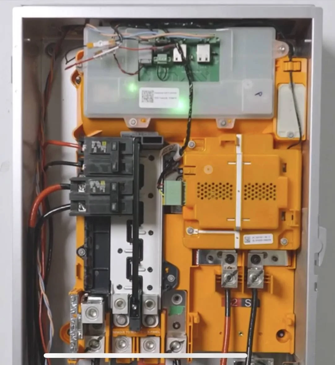

I went through the whole close out procedure.
The comms connections are all good. I removed them, restripped them and reinserted them. They were stripped a bit to long and though the exposed could have shorted so I restripped them. Still in the same situation.
I'm now thinking it’s the truck. Seems like it doesn’t have the correct software. The charge screen doesn’t have the Power share option selection. 2024.33.15
My app does show the power share green icon.

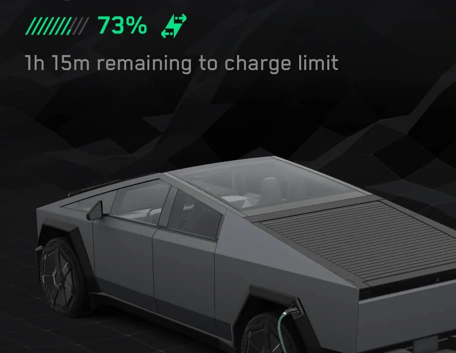

Got this morning without having to call them. They installed it on Monday and got App notification on Saturday. Also showed up under charging screen in vehicle.
