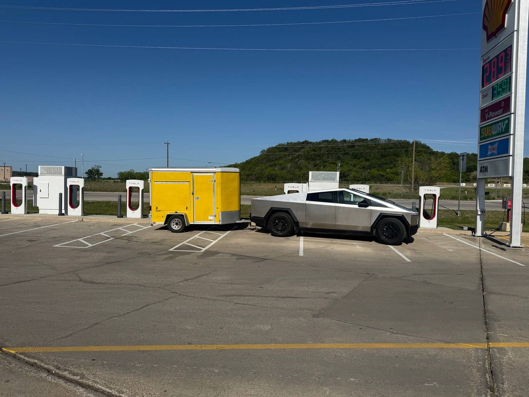

Sorry that the Lightning is auto hitch challenged.
Tesla's rear camera ought to be able to center the ball under a trailer hitch.
Agree it would be nice. Though Tesla seems to be installing charging stations in such large numbers now that pulling in across is often not a problem.
this was from this morning:
