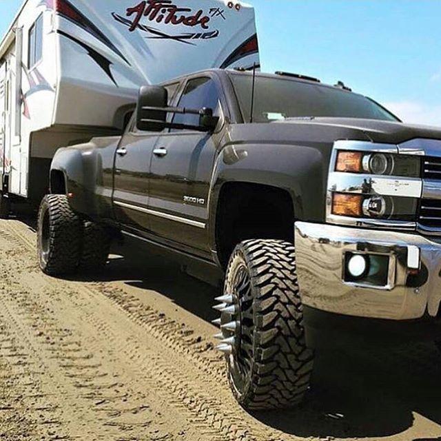

It didn’t take off because you need the weight over the rear axle. A gooseneck hooks directly to a ball that is mounted to the frame. You couldn’t haul any amount of serious weight like that. But still cool!

For example a new F350 or 3500 DRW. All have about 20k lbs max trailer towing weight at the bumper. 35-40k lbs max gooseneck. I’ve probably hauled over 1000 loads. There is a huge difference in pulling a heavy trailer at the bumper vs gooseneck. It doesn’t feel nearly as safe and is more likely to sway at high speeds If the load isn’t positioned perfectly. Putting the weight directly over an axle minimizes this. The weight goes directly down to the ground vs having leverage on the vehicle.
Never pulled one over my roof haha but that doesn’t seem viable at all. That is a lot of weight on the roof. And too much weight on the front axle. I’m not an engineer or a physicist so could be wrong. But I would think semi’s or pickups would have done this by now if it made sense.
having the weight behind the rear axle is the worst. Not so sure about in front of the axel.
The bug in this example would likely struggle to pull this if all the weight was over or behind the rear axle.

I agree but a bug should not be pulling anything really. Just because something can pull it does not mean it should. Certainly not a camper. It also has the engine in the rear so that would be a ton of weight on the rear axle I agree. I could pull a semi trailer with my truck. But braking and handling the load or handling cross winds is different. I just think the weight on the front axle would cause steering issues. When braking the weight would also shift towards the front even more. The CT could probably handle it. I just don’t think it’s the optimal thing to do.
