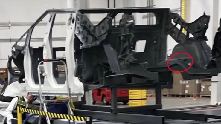

at that camera angle, with that casting, it’s clear there’s no casting at or near mid-bed
As long as Cybertruck has support mounts under the bed maybe it doesn't necessarily matter if casting support is at exact center of bed?
Aluminum bed ICE Ford F-150 does not come standard with a heavy-duty support rail under the center of the bed. Some 5th wheel hitch installation kits include heavy-duty support bracket spanning left to right.
The main mounting bolts for most 5th wheel hitches seem not to be in the center but are located on the outside left/right edges of the hitch. The 5th wheel hitch support is like an upside down U so the main mounting bolts where the hitch meets the bed is actually near the left/right rear wheel wells.
These 5th wheel support mounting location look to be similar position as the Cybertruck rear casting wheel well flange (ie. not center of bed).
The aluminum bed F-150 do not come standard with full-size support rail under the center of the bed. Under the center of the bed there are aluminum cross-beams that span the side to side distance, NOT a full-size heavy-duty steel frame beam like the beams that run the entire length of the truck.
So maybe just like the F-150, the Cybertruck rear casting does not span under the bed from right side to left side. If the Cybertruck 3mm cold-rolled stainless steel bed and lerft/right rear castings is not enough, Tesla might add left to right cross-beams between the castings.

The flat spot circled in red might facilitate a fifth wheel mount.
Tesla Cybertruck Cybertruck trailering explained 4747B14C-DDED-4A62-AA65-C5B5479EE6D3
not to say that at some later point of production they don’t weld/add some other portion of casting.
(y)
In each example they drill holes through the bed but they never drill into the main heavy-duty frame rails and there is NO heavy-duty frame rail in the center of the bed.
Huh? They don’t drill into the frame only because the frame comes pre-drilled for framerail brackets to attach spanning supports. To attach the brackets, the truck beds are lifted off.
which is to say:
unless and until we know that Tesla makes substructure for these types of trailers, doesn’t matter much our various armchair views
Because of the unibody and battery pack, etc., I don’t see folks disassembling their CTs to access and attach brackets and the like.
Which is why I would think Tesla itself would need to not just happen to have framing near there, but to be building into the CT as OEM specific support and under-bed mounts intended to allow center bed hitches.
Maybe so!

...Which is why I would think Tesla itself would need to not just happen to have framing near there, but to be building into the CT as OEM specific support and under-bed mounts intended to allow center bed hitches.
I'm not drilling anywhere in the vicinity of a 100Wh+ battery pack lol
