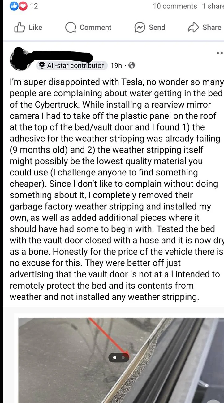

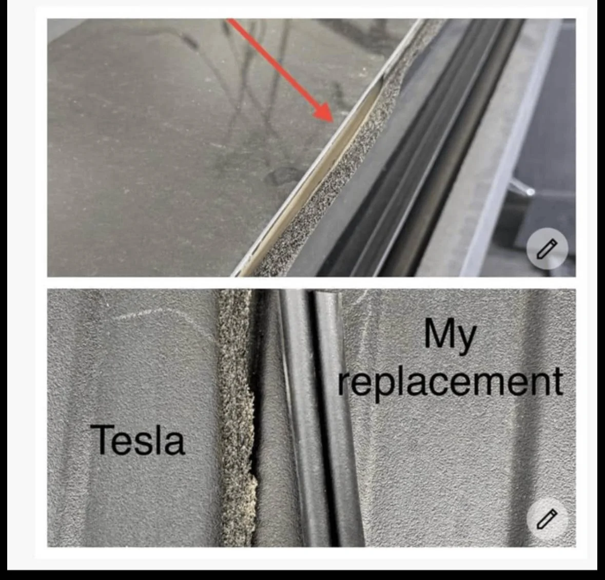

Hi all,
You may have seen my post previously about issues with my CT. The weather stripping on the CTs is some of worst I’ve ever come across. It’s insane to me for the price we paid, they didn’t do any QA or testing on this. Mine hasn’t worked from day one. I was hoping we would get a recall for it, but I’ve got nothing sent to me by Tesla
I was on Facebook and saw another post here. This is exactly what I encounteredWhy doesn’t Tesla recall this? So disrespectful to their customers ?

Ah part of my screenshot cut off, but those pics are from another owner. mine was completely gone from day 1. Water gets everywhere.

Mine is actually pretty good and doesn't seem to leak like others on the forum have had trouble with, however if it ever does then what the facebook person and what others have done is shown in this video:

Thanks for the video. The information on how to remove and replace the panel between the glass and the tonneau was very helpful. Very nice job on the weather seal install. If the Tesla seal is really just that foam gasket, it's pretty pitiful. Looks like something the assembly line grabbed when they ran out of a real gasket. I'm considering a new rear-view mirror/screen, and have been thinking that the ideal place for a camera mount would be on that 'aero' panel. Much more to think about now.
