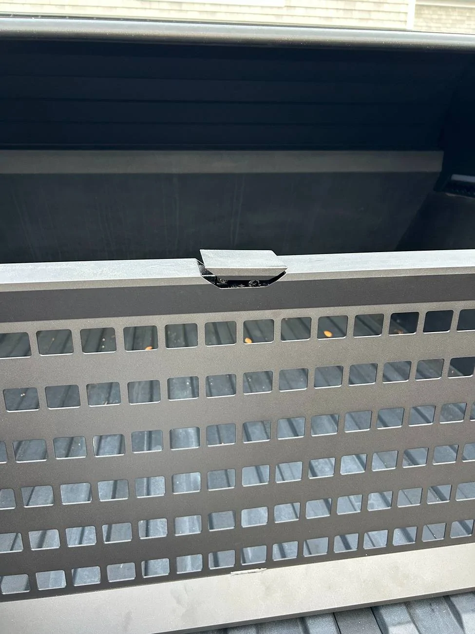

I either received a defective item or this is just poorly designed. I cannot seem to get this thing to align properly, and even when I have it aligned perfectly with the L-Track on both sides the center latch refuses to completely engage and lay flat. I watched some reviews online that indicated that Tesla redesigned this thing a few months back.
Anyone have any luck getting this to work as advertised?
Defective by design. If you slightly bend the dividers locking lugs by forcing it to fit in the bed, it’s easier to put in the second time.
Cybergear.co sells an improved design divider that solves the design flaw of the Tesla model.
