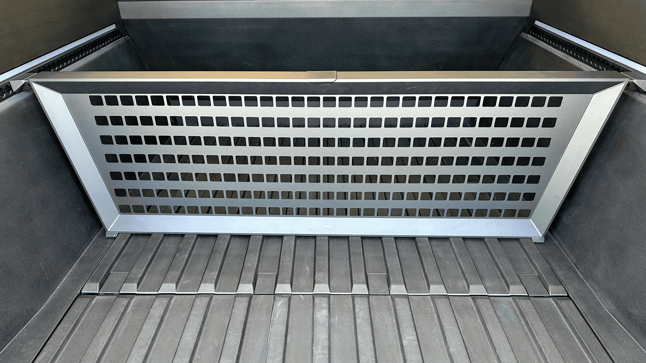

Someone needs to make a dedicated thread post to this and make it a Sticky!
100%! This took me less then 10 minutes and problem solved. Reading all these dudes doing all they are doing is cringe to put the stops on both sides defeats the purpose of it being movable with ease . Hope this helps

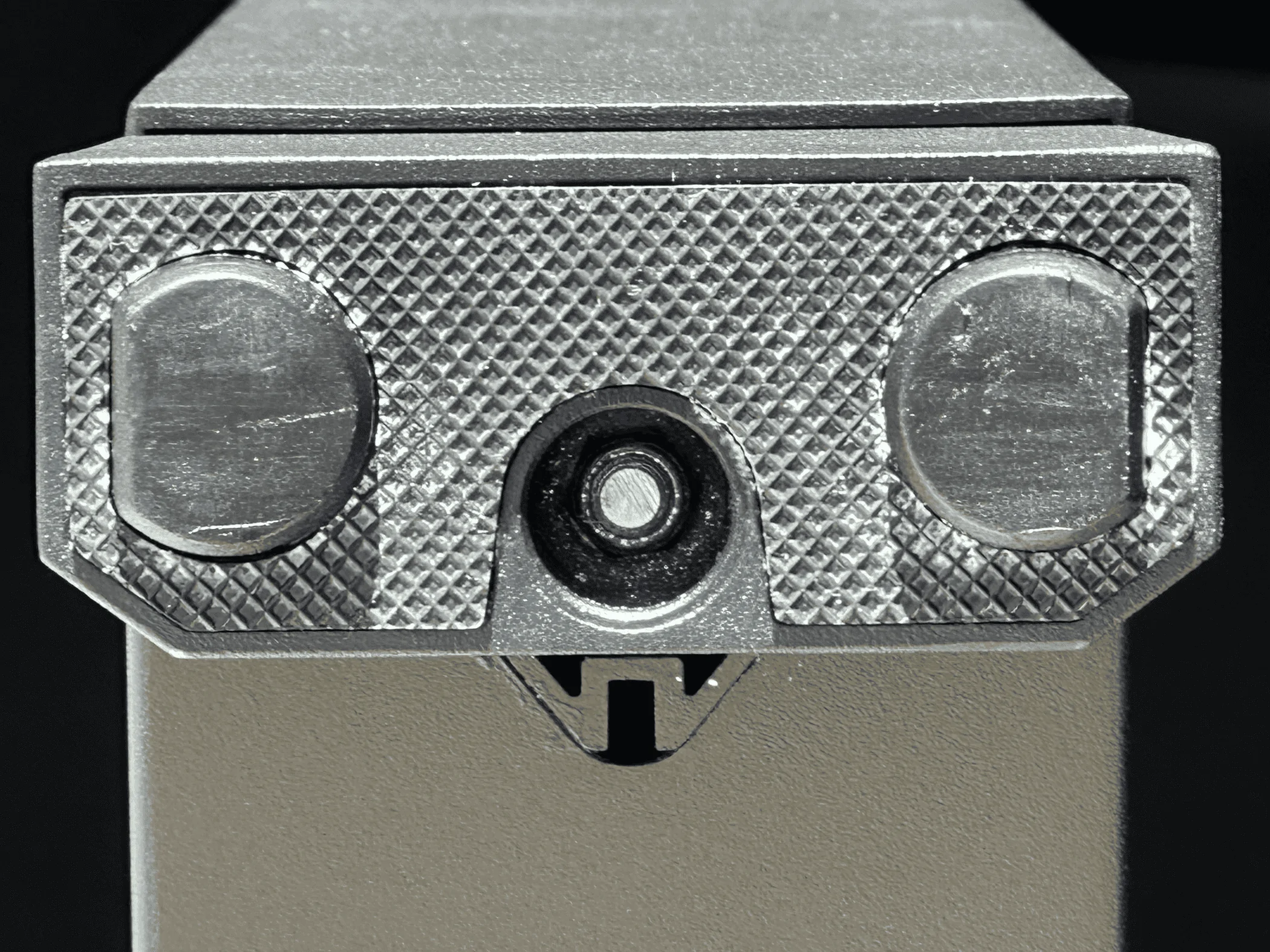

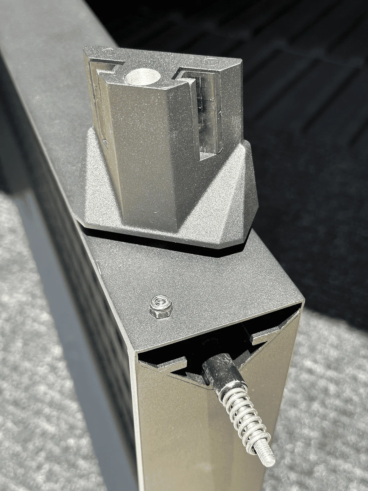

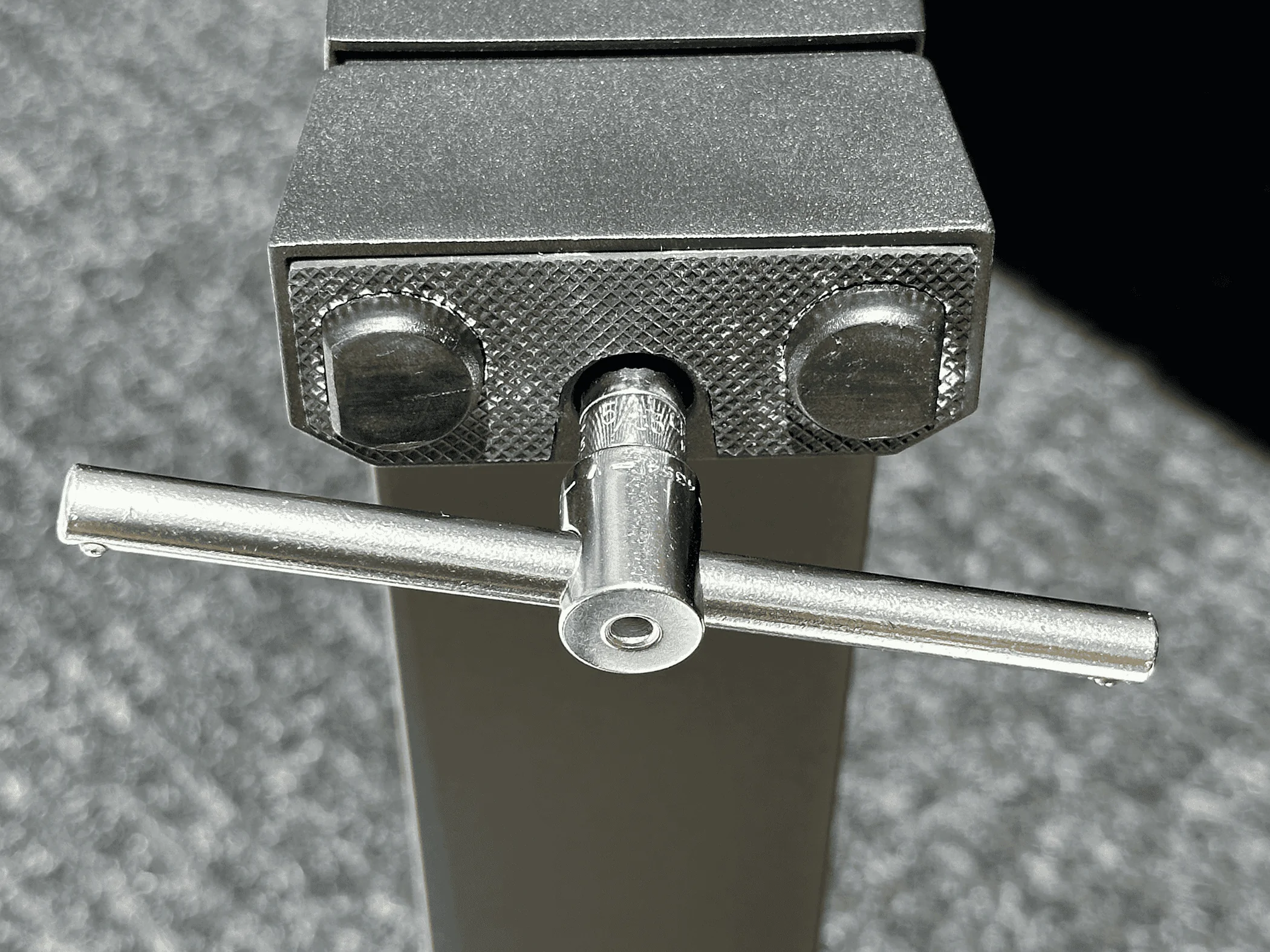

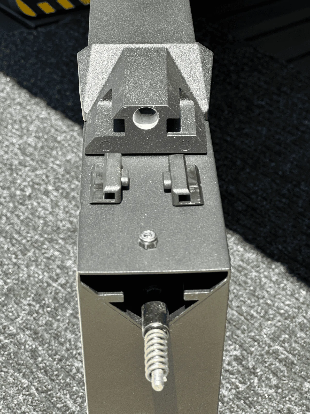

Here are more photos as requested.
Remove the nut with a 5/16" socket. Note the round spacer and spring position on the threaded shaft. The plastic guides are shown as originally positioned. Finally the plastic guides are removed. Make sure to secure the nut at the same depth as before. Without the plastic guides, it will rattle a bit until fully mounted and secure. Save the plastic guides if you need to restore the Vault Cargo Divider to original condition.
